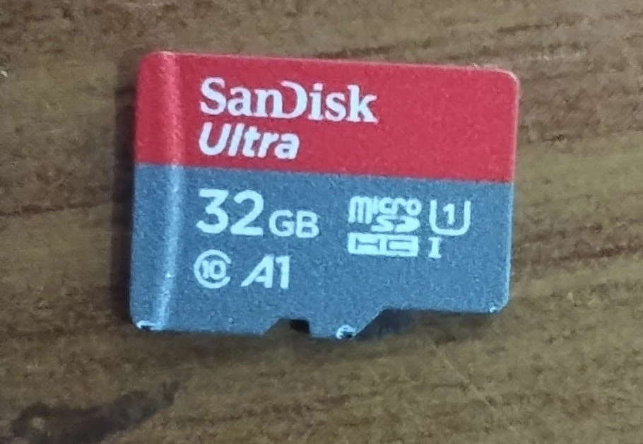

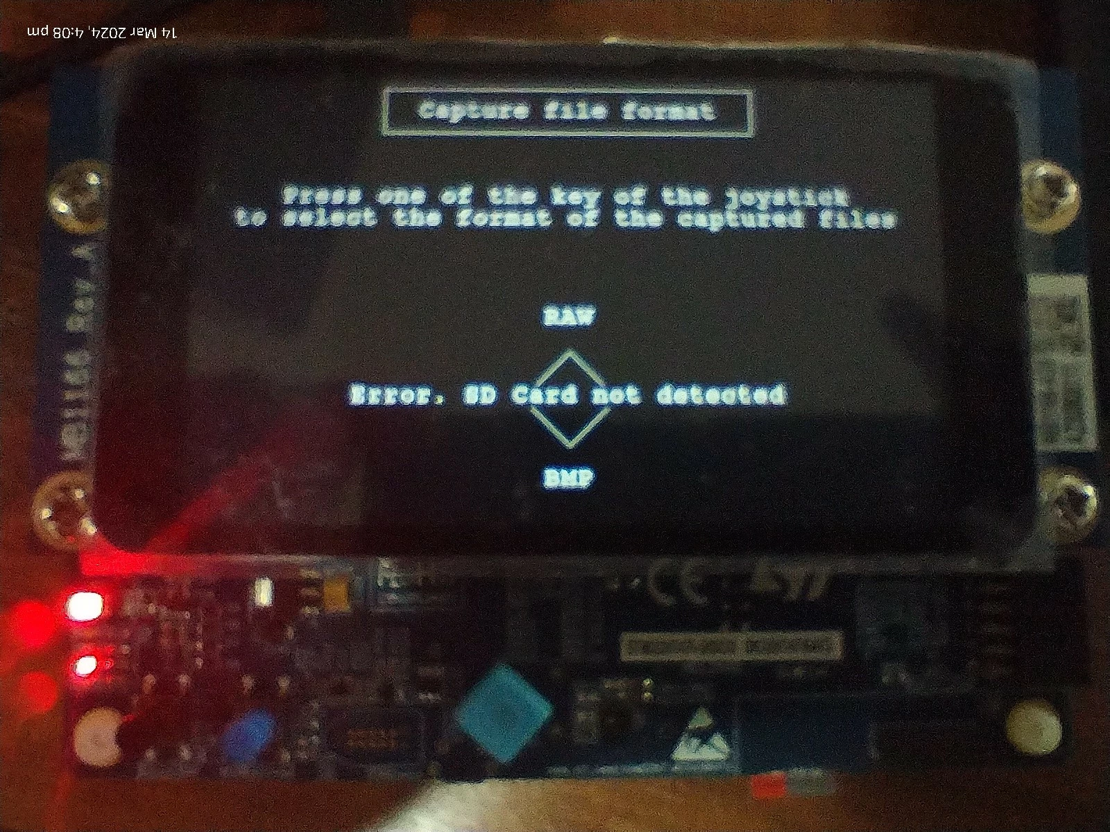

I am using STM32H747-DISCO with the FP-AI-VISION1 package, I have updated my drivers and solved the screen problem. Now I am facing an issue with the SD card. It is given that an SD card with class 10 is recommended, I am using SanDisk Ultra microSDHC class 10. While testing it shows SD is not detected, I don't know what the problem is, SD is working fine with my PC. Please help me out.

I have the exact same issue, on my STM32H747I-DISCO board (revision D03) using the same Sandisk 32 GB SDHC Ultra Micro-SD card (model number SDSQUA4-032G-GN6MA) that you show on the picture.

But when I instead compiled and flashed the STM32H747I_DISCO_PersonDetect_MobileNetv2_CM7 binary from  FP-AI-VISION1_V3.1.0, I also got the message "Error. SD card not detected" when I tried to enter the "Frame Capture" mode and select RAW or BMP file format.
I have tried combinations of the following, with no success:
  • Externally formatting the SD card to FAT16 (a single 4 GB partition)
  • Setting USE_SD_BUS_WIDE_4B to 0U in stm32h747i_discovery_sd.h (although there is a conflicting define of the same constant in stm32h747i_discovery_conf.h, already set to 0)
  • Setting hsd->Init.ClockDiv to 0x80 in stm32h747i_discovery_sd.c
Any help would be appreciated!
