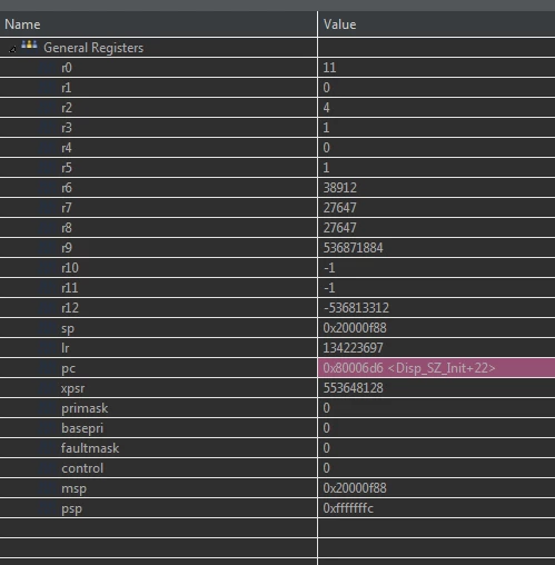

Thanks to all for your help . so finally i found it ...
  1. C6 chip has only 4k ram, so using same bin as with C8 version using > 4k ram going mad
  2. using optimizer (-O2) made the chip starting the program (but program stuck in While-loop)
  3. making all warnings away and using "volatile" for variables, modified in interrupt, get it running.
(program is old, transferred from other chip and never made in good/correct C-style )
-> chips are not defective, with optimized program for C6 version all running fine now.

funny: now (still same program, changed nothing intentional ) starting normal, cpu registers now:
0693W00000UoMF8QAN.png but...i run compiler again , just to see: 0 warnings , 0 errors .

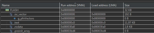

isr_vector ...in IDE ?
0693W00000UoMMYQA3.pngor where to look ?
_estack symbol -- is where ?
+ i have to go home now, tomorrow i can check ....
