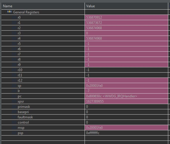

(programmed) STM32F030 stucks in the startup (xx.s ) forever. defective batch ??
the hole batch of F030C6T6 has same behavior :
can access with ST-Link , program, verify - all ok. read core registers, option bytes...ok.
but then no program start ! chip stays in startup here:
0693W00000Uo3uMQAR.png10 tested boards ihave identical behavior. chips coming from PCB assembler , as usual.
I replaced one with a (suspect source , from aliexpress dealer) F030 , then board running as it should.
  • can i do anything, to get these boards running?
  • if chips have all same defect, how is it possible to passing the wafer test ??

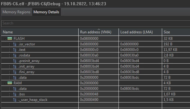

Thanks to all for your help . so finally i found it ...
  1. C6 chip has only 4k ram, so using same bin as with C8 version using > 4k ram going mad
  2. using optimizer (-O2) made the chip starting the program (but program stuck in While-loop)
  3. making all warnings away and using "volatile" for variables, modified in interrupt, get it running.
(program is old, transferred from other chip and never made in good/correct C-style )
-> chips are not defective, with optimized program for C6 version all running fine now.
but crazy, that the cpu stall in startup code, without showing some useful error (illegal adress or so).

Could you send registers values table in infinite loop?
AScha.3
AScha.3Author
October 19, 2022
see in my post from yesterday, registers at loop. (in black area)

But they are from another bin file. We need from new bin file (for C6 MCU).
AScha.3
AScha.3Author
October 19, 2022
aaa. ok. BUT : now cpu is running !!
debug waits at program start in "main" , as usual.
just i dont know why...i set optimizer on -O2 (was -O0 );
i tried some times...now again stall in startup.
registers :
confusing...
ONadr.1
Senior III
October 19, 2022
It si weird. Stack pointer (sp) has value 8160byte. Like there is 8kb memory set.
Tesla DeLorean
Guru
October 19, 2022
Check linker script (.LD)
Top-of-Stack needs to be 0x20001000 (4KB) or below. Check first vector.
Right now you're faulting directly out of reset, and perhaps into a catch-all handler everything points too.
AScha.3
AScha.3Author
October 19, 2022
from .LD :
/* Entry Point */
ENTRY(Reset_Handler)
/* Highest address of the user mode stack */
_estack = ORIGIN(RAM) + LENGTH(RAM); /* end of "RAM" Ram type memory */
_Min_Heap_Size = 0x200 ; /* required amount of heap */
_Min_Stack_Size = 0x400 ; /* required amount of stack */
/* Memories definition */
MEMORY
 RAM   (xrw)   : ORIGIN = 0x20000000,  LENGTH = 4K
 FLASH   (rx)   : ORIGIN = 0x8000000,  LENGTH = 32K
/* Sections */
SECTIONS
 /* The startup code into "FLASH" Rom type memory */
 .isr_vector :
   . = ALIGN(4);
   KEEP(*(.isr_vector)) /* Startup code */
   . = ALIGN(4);
 } >FLASH
and in IDE shows:
looking ok for me.... or not ?
Tesla DeLorean
Guru
October 19, 2022
Expand the isr_vector so we can SEE the content, ie what the processor is actually loading into it's registers at startup, and what over handlers are pointing too.
Check the _estack symbol
That is typically loaded by the processor, and often loaded a second time into SP in ST's startup.s code.
Processor will fault the first time anything pushes onto the stack, ie PUSH LR and then the processor's going to have all kinds of issues because it will try an push context onto the stack, basically double faulting.
