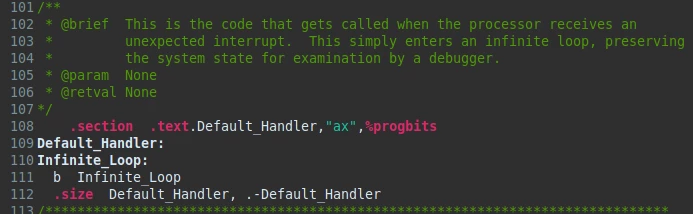

(programmed) STM32F030 stucks in the startup (xx.s ) forever. defective batch ??
the hole batch of F030C6T6 has same behavior :
can access with ST-Link , program, verify - all ok. read core registers, option bytes...ok.
but then no program start ! chip stays in startup here:
0693W00000Uo3uMQAR.png10 tested boards ihave identical behavior. chips coming from PCB assembler , as usual.

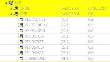

Try to debug as usually, i.e. observe, which interrupt caused to enter the default handler (SCB_ICSR.VECTACTIVE) and if it's HardFault, observe the stacked registers etc.

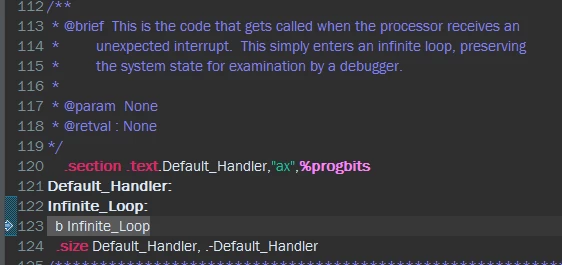

@Community member​  , there is no "normal" debug possible, first and only thing is start und stuck at : b Infinite_Loop . restart, reset always comes to this line in startup.s no stepping or anything else than leaving debug session is possible. ok, reading registers, flash etc is ok, but no step in program execution.
@Community member​ , program is pure C, and was running ( about 2 years) always without any problem - until now, with these chips from last order. (same PCB, same .bin as before)

Then read out the SCB_ICSR register and find out what is the current interrupt number in VECTACTIVE field of that register, then proceed accordingly to that.

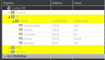

Read the DEVID, might be a different stepping of the IC, or one where ST has changed the die.
Pictures of working and non working parts might also be instructive.​

so - here we are:
old (1..2 years) board: C8T6 variant
with new chip: C6T6 (because C8 not available)
and ID : (in cubeIde )
and SCB_ICSR :
VECTACTIVE:

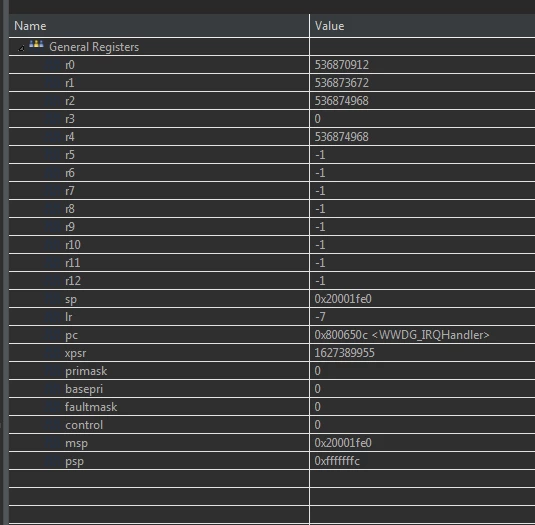

and registers at infinite loop:
so seems WWDG is doing this - but is off.
i had this idea, because WWDG_IRQ shown, but setting option bytes to Hardware and back changes nothing.
any idea ... or kick them to trash ?

C6 has only one half RAM and FLASH then C8. If you use bin files for C8, the stack si in nonexisting RAM memory. I would compile whole project for C6 MCU and use this bin.

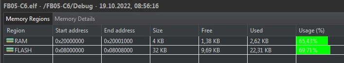

new project with C6 version (is really small program):
0693W00000UoKLJQA3.png--- but still same effect: stalled in startup...
0693W00000UoKMvQAN.pnghere pic - looks original - right ?
