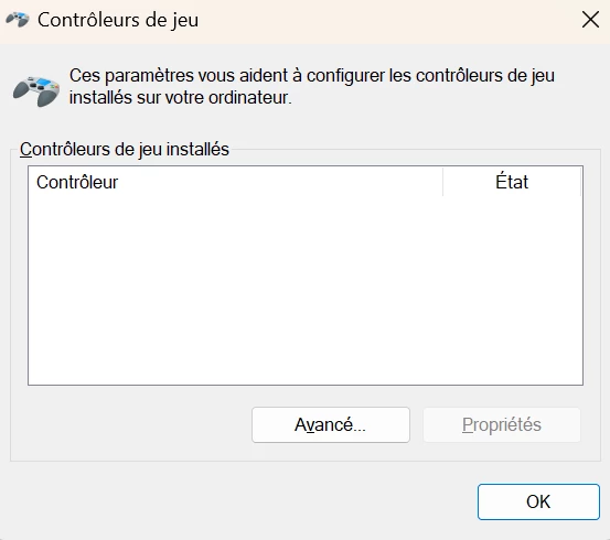

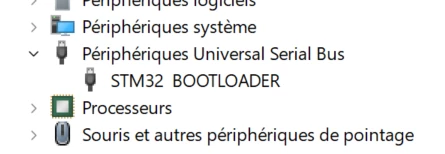

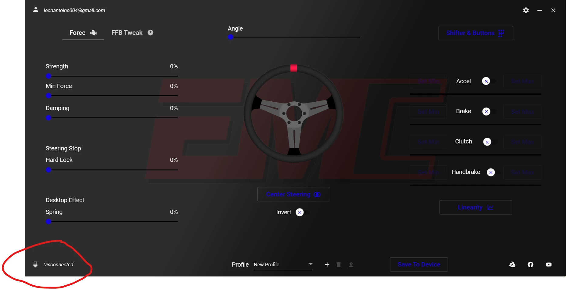

Hello, I am working on a diy simracing project which use the STM32F401CCU6 board. I just bought this board and It worked fine until today for a reason I ignore. The board is stuck on the red led, the blue led doesn't light up anymore. I can still find the board in the device manager ( picture under ) but not it is not detected as it shall be in game controller configuartor ( picture under ). I can still erase the sketch on STM32 Cubeprogrammer and upload it but when I disconnect it it stays with the red led.
Have anyone any idea on what to do ?
That picture shows that it is stuck in Bootloader mode - ie, it's waiting for you to download firmware.
Because it's stuck in Bootloader mode, it won't be detected as a game controller - or anything else - until you've successfully loaded good firmware.

And do you have any idea of how to unstuck it from the bootloader mode ?
Andrew Neil
October 25, 2024
Load some code into it!
You'll have to find out what app(s) is/are required to do that.
Or use an ST-Link (or similar) to program directly.
