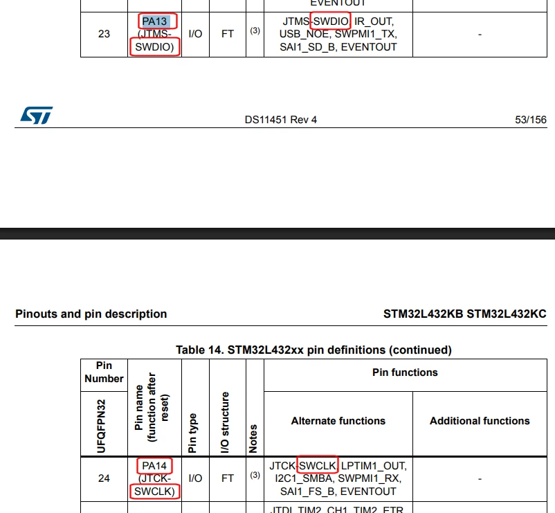

PA13 on STM32L432KC
Is there a board schematic for STM32L432KC somewhere?
I want to acces pin PA13. But I can find no connector or easy acces point.
Thanks
No, because STM32L432KC is just a chip - not a board.
If you're referring to an ST board, go to its Product Page and look on the 'CAD Resources' tab; eg,
https://www.st.com/en/evaluation-tools/nucleo-l432kc.html#cad-resources
If it's a 3rd-party board, you will have to contact the manufacturer and/or supplier
Note that PA13 is the SWDIO pin - so using it for anything else will interfere with your ability to program & debug the chip ...
Also PA14 is SWCLK:
https://www.st.com/resource/en/datasheet/stm32l432kc.pdf#page=53
via: https://www.st.com/en/microcontrollers-microprocessors/stm32l432kc.html#documentation

The board schematic is here.
As said by @Andrew Neil  PA13 corresponds to the SWDIO pin. So need to take care about that point.
