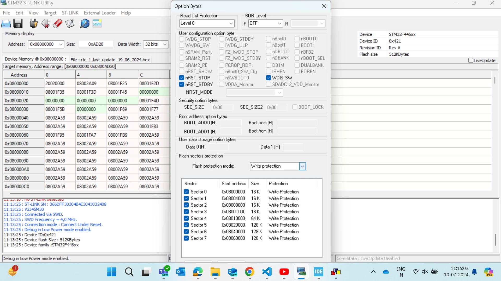

Visitor II
July 10, 2024
Try using
"STM link utility"
Target>Option byte>Flash protection mode
