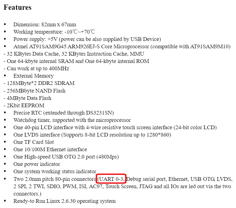

Hi
  • I am trying to communicate between arm processor and nucleo board through uart
  • The processor has a type b usb , to interface with computer.
  • For the same usb I am connecting my Nucelo board through usb type B mini and sending the data through it
  • When i connect the device to laptop/computer the communication happens, and when i connect nucleo the communication does not happen.

Andrew Neil
September 25, 2024
So this "ARM processor" has a USB Device connection.
The CN1 USB connector on your Nucleo board is also a USB Device connection:
You cannot connect two USB Devices together - a Device can only connect to a Host.
That's because the computer is a Host.

Andrew Neil
September 25, 2024
@harry123 wrote:
  • I want to have communication between Nucleo and Processor
The CN1 USB connector on your Nucleo board is a USB Device connection for the Virtual COM Port (VCP) in the ST-Link:
https://community.st.com/t5/stm32-mcus-products/communication-between-nucleo-f411re-and-raspberry-pi-using-st/m-p/721571
To use that, you must connect it to a USB Host port. That's the way it works.
Instead of using this USB connection, could you use a direct logic-level connection to one of the UARTs on your ARM9 board?
Andrew Neil
September 25, 2024
There's not enough information in that brief document - you need a more detailed technical manual.
But this Mini6045 board seems to be obsolete and no longer supported - so no idea where you'll find that.
