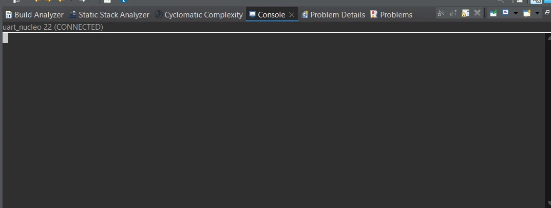

I m trying to communicate through USART with my NUCLEO-L476RG but the STM console is displaying nothing.
I have created a simple project:
I m overriding the __io_putchar function:
int __io_putchar(int ch)
 if (ch == '\n') {
 uint8_t ch2 = '\r';
 HAL_UART_Transmit(&huart2, &ch2, 1, HAL_MAX_DELAY);
 HAL_UART_Transmit(&huart2, (uint8_t*)&ch, 1, HAL_MAX_DELAY);
 return 1;
and using it (indirectly, through __int_write) in printf:
 /* USER CODE BEGIN 2 */
 float pi = 3.14f;
 printf("the pi number is : %f\n", pi);
 /* USER CODE END 2 */
the code compiles without errors, however when I try to run it in the console, I receive nothing

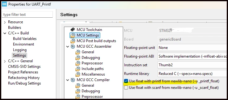

I’m not sure if it’s relevant, but I also have this option enabled (which I’ve seen suggested as a solution in other explanations online

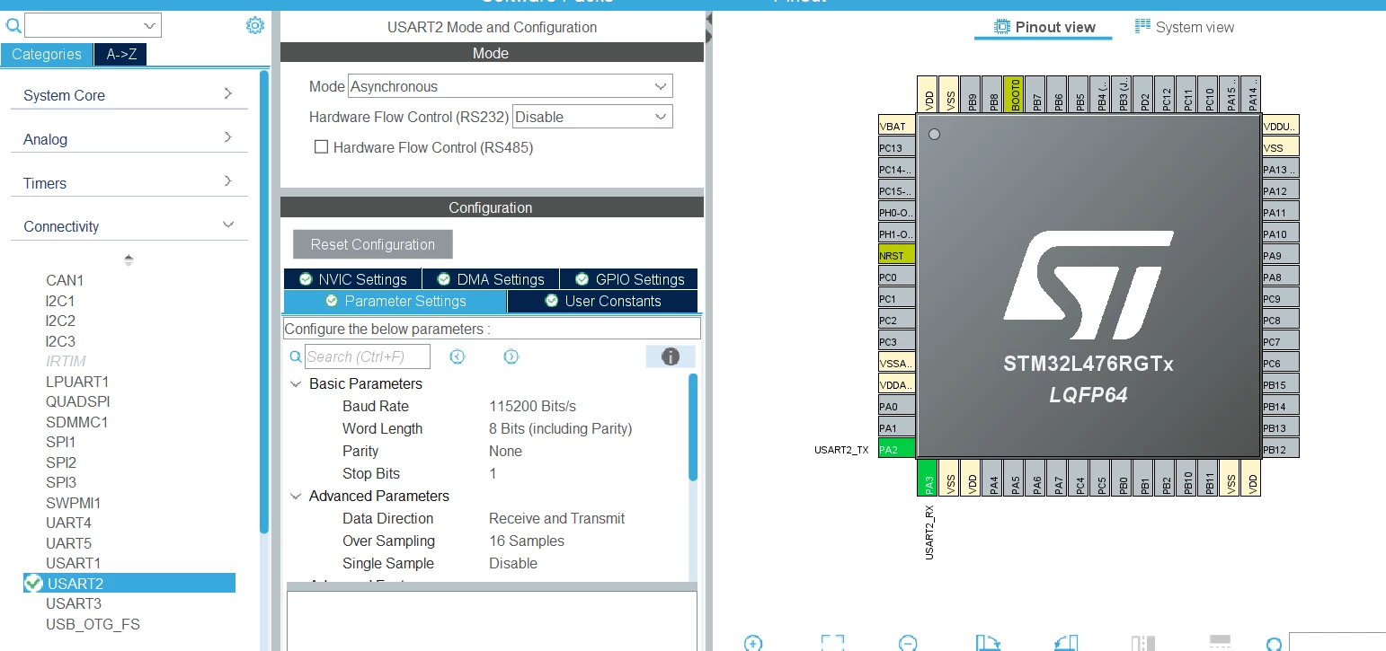

So this is an issue in your USART configuration.
Check your baudrate, data lenght, stop bit parity etc .. these parameters needs to match your hyperterminal.
For example set these configs to the USART2:
 UartHandle.Init.BaudRate = 9600;
 UartHandle.Init.WordLength = UART_WORDLENGTH_8B;
 UartHandle.Init.StopBits = UART_STOPBITS_1;
 UartHandle.Init.Parity = UART_PARITY_ODD;
 UartHandle.Init.HwFlowCtl = UART_HWCONTROL_NONE;
 UartHandle.Init.Mode = UART_MODE_TX;
Use Hercule utility for example and set these configs:
Don't forget to set the correct COM port.
Do you see something?

Indeed this Nucleo has the ST-Link VCP connected to USART2 on PA2, PA3 per the user guide. Then you have some other problem.
MichalPorazkoAuthorBest answer
May 5, 2025 4:29 PM UTC
I forgot to respond what was the reason, I actually forgot exactly but the reason was that the UART transmission started during the initialization or something. I think it was due to the fact that I had no interrupts turned on for the UART transmission and the communication was just invoked once in the:
When I move id to the while loop it started working.
