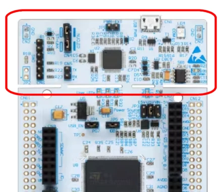

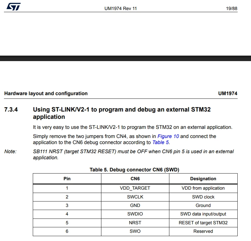

Andrew Neil
Feb 27, 2026 12:32 PM UTC
Does your board have the break-off ST-Link V2.1 part - like this:
If it does, then this applies:
https://www.st.com/resource/en/user_manual/um1974-stm32-nucleo144-boards-mb1137-stmicroelectronics.pdf#page=20
via: https://www.st.com/en/evaluation-tools/nucleo-h743zi.html#documentation
However, this has  a number of limitation; a standalone ST-Link is not expensive - I would strongly suggest that you get one!
https://www.st.com/en/development-tools/hardware-debugger-and-programmer-tools-for-stm32.html
Be sure not to get a fake/clone!
