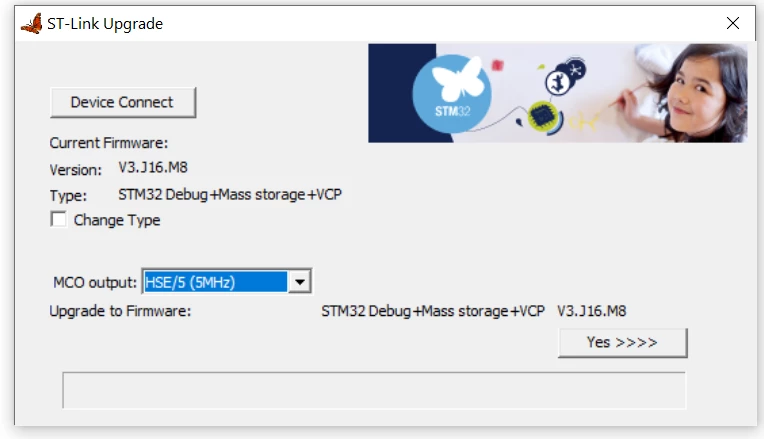

I am using Nucleo-144 boards in my project where I have changed the clock source for STLINK IC to external crystal using STLINK firmware upgrade tool. Before it was HSI/2 =8MHz. Now I am trying to revert the configuration back to 8MHz but I am not able to detect the Nucleo board now with 8 MHz. Is this known issue?
I tried configuring it back to 5MHz using tool below and it works fine , detects all the time in MATLAB. But not with 8MHz (HSI/2).
How to revert back the configuration and make the board detectable?

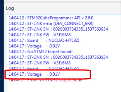

I have tried connecting same nucleo 144 board to ST32cube programmer after setting freq to8MHz but i am getting below error. So irrespective of MATLAB it is not detecting in any other tool.

Your log shows that there is no power on the Target:

@DJ_IND  as pointed out by @Andrew Neil , the VDD voltage detected by STLINK is 0V. as if the MCU is not powered. Did you remove any jumper from the board? the IDD jumper for example?
