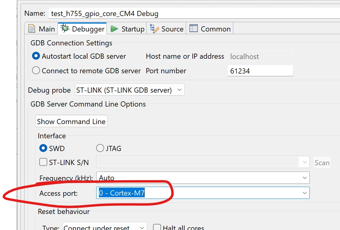

Hi everyone,

What I've Tried:
Hardware Checks:
  • Verified that the board is powered and that I’m using a known-good USB cable and port.
Software and Firmware:
  • Updated the ST-LINK firmware using STM32CubeProgrammer.
  • Ensured that there are no extra instances of the ST-LINK server running (rebooted the Mac and checked Activity Monitor).
IDE Configuration:
  • For the H755ZIQ (dual-core device), I commented out the code that releases the Cortex‑M4 core so that only the Cortex‑M7 is active.
Despite these steps, the ST-LINK GDB server still fails to detect the device, and the board doesn't even enter debug mode.
Has anyone encountered a similar issue with the STM32H755ZIQ, or does anyone have additional suggestions to get past the "No device found" error? Any help would be greatly appreciated!

In the debug configuration, are you connecting to AP0?
Can you connect with STM32CubeProgrammer?
BOSSX918spy
Mar 17, 2025 4:37 PM UTC
Yes, I am doing that
