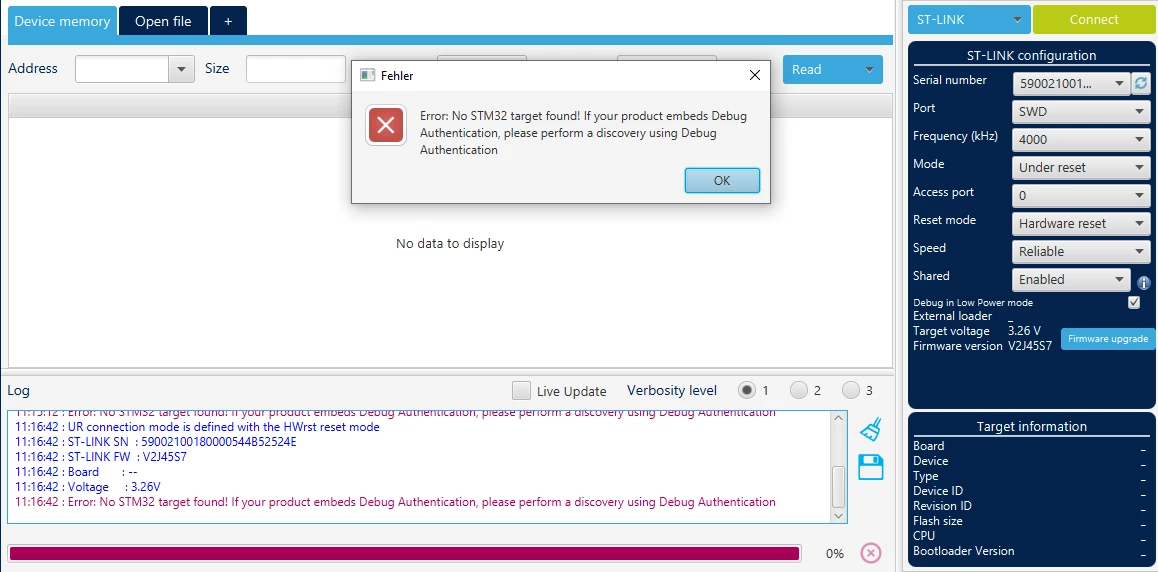

I'm unable to connect via SWD to my STM32F103C8T6. What ever I try I get no target found with STM32CubeProgrammer or ST-LINK Utility (I have tried all combinations at slow and high speeds).

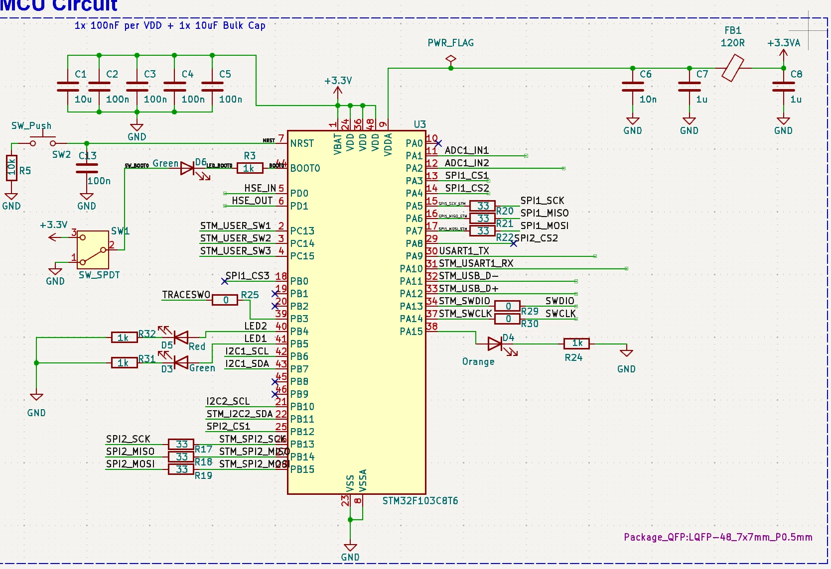

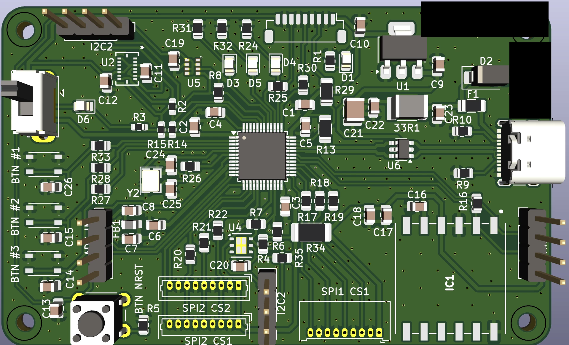

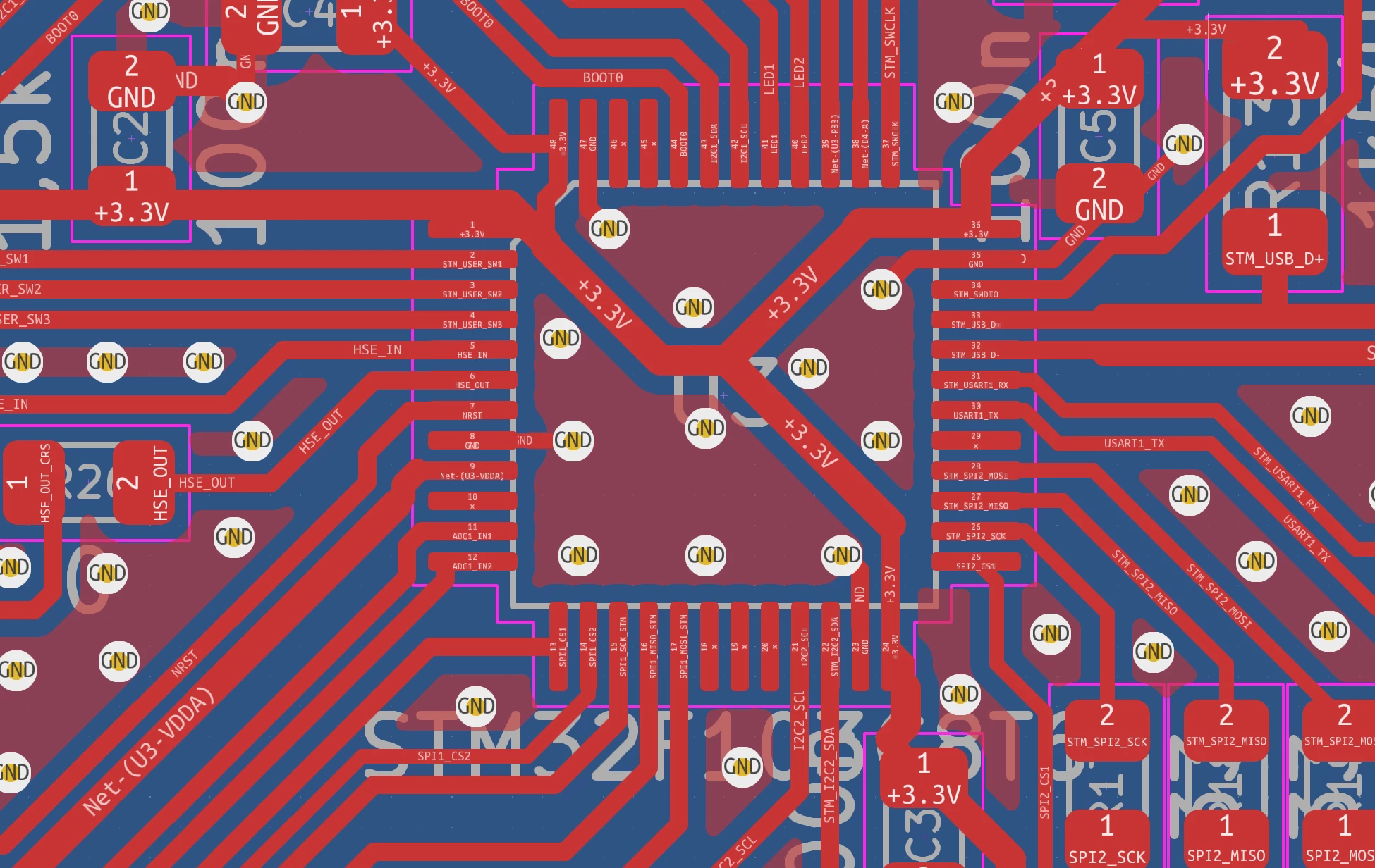

Some info on the board: It's a 2-Layer 1 mm board with a solid GND plane on the backside, I have attached sreenshots of the schematic and the routing. Please not that the LED on the BOOT0 path has been replaced with a 0 Ohm resistor to actually pull the pin low. Please let me know any further info required.

Why do you have an LED in the direction of BOOT0? If you set the switch to GND, the LED is in the blocking direction, which means that BOOT0 cannot recognise a clear low.

I realized my mistake with the LED after I created it and changed the LED to a 0 Ohm resistor - I verified the BOOT0 is low. Thanks on the ST-LINK Utility info, I was not aware and that it would be the more in-depth program.

Hi Andrew, thank you too - I tried Connect under Reset, Hot Plug, Normal and Power Down to no avail. I did leave NRST open on most tries though - although some said that it might need to be toggled.
The clone is the upper one shown in the post you linked.

Connect under reset won't work unless NRST is connected to the ST-Link!
Andrew Neil
October 18, 2024
Have you tried with NRST connected to the ST-Link, and configured for 'Connect under reset' ?

Hi, so this is what I get.
There is one peculiar thing: When I switched on the power with the previous MCU (before desoldering it) the LEDs D3 and D5 lit up very dimly, leading me to believe the chip was faulty, the new chip also did it shortly but stopped after I disconnected it from power immediately. (Not a good sign either) A test with an older, less complex PCB design (different purpose board) also showed LEDs glowing dimly after some seconds but here the SWD is indeed working. So I'm asking myself again if the my new chip is faulty and if the problem is with the board design. Is it normal for some regular unprogrammed GPIO pins to go high after boot? One problem I could see is that 3V3 connection to the ST-LINK is straight through without a resistor and when I unplug the PCB the ST-LINK will feed the 3V3 to the board - might that have damaged something?

apparently it was the VDDA pin that was not powered properly. With the pin powered the MCU boots and connection via STM32CubeProgrammer was possible in a first try. I think that solved the riddle.

SWD lines (SWCLK, SWDIO) should be routed properly with minimal length and no sharp turns or excessive vias. These lines should also avoid high-noise areas. A solid ground return path for the SWD lines is critical, so verify the integrity of the ground plane and the connections between ST-Link and STM32. You mentioned that NRST is unconnected.  You can connect it directly to the ST-Link reset pin and attempt a reset before programming to ensure a clean reset signal. Before printing the PCB, it is always better to simulate the schematic. You can use simulation software for this task.
