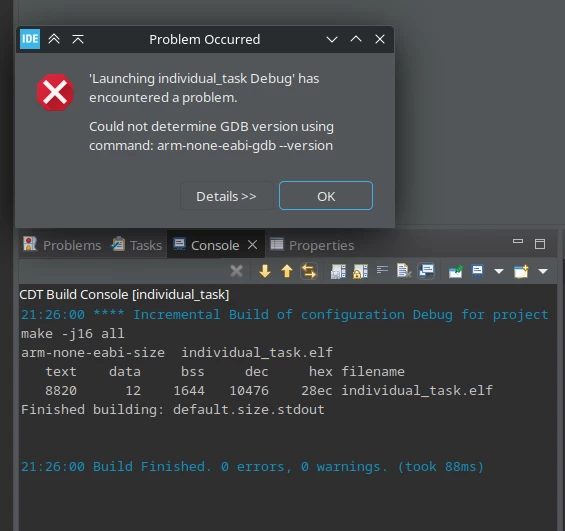

I'm trying to work with a STM32F4-Discovery board, and previously it connected perfectly okay, but a couple weeks ago something, seemingly out of nowhere, broke and CubeIDE stopped detecting the board and writing programs to it showing this message:

 But the important detail is that if I run stm32cubeide_wayland as root through sudo it is able to detect the board. (Still doesn't run the project, but that's because I don't have it setup for root either way.)

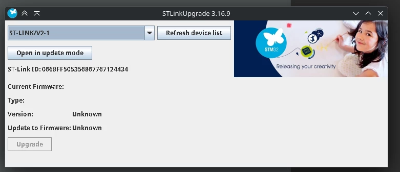

Here's how it looks when I run stm32cubeide_wayland as root user:

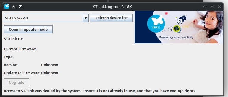

While not root STLinkUpdate gives this:
And trying to run it gives the aforementioned ST-LINK firmware verification.

Yes, lsusb does detect it, as the system in general, it seems to be some strange permission issue.

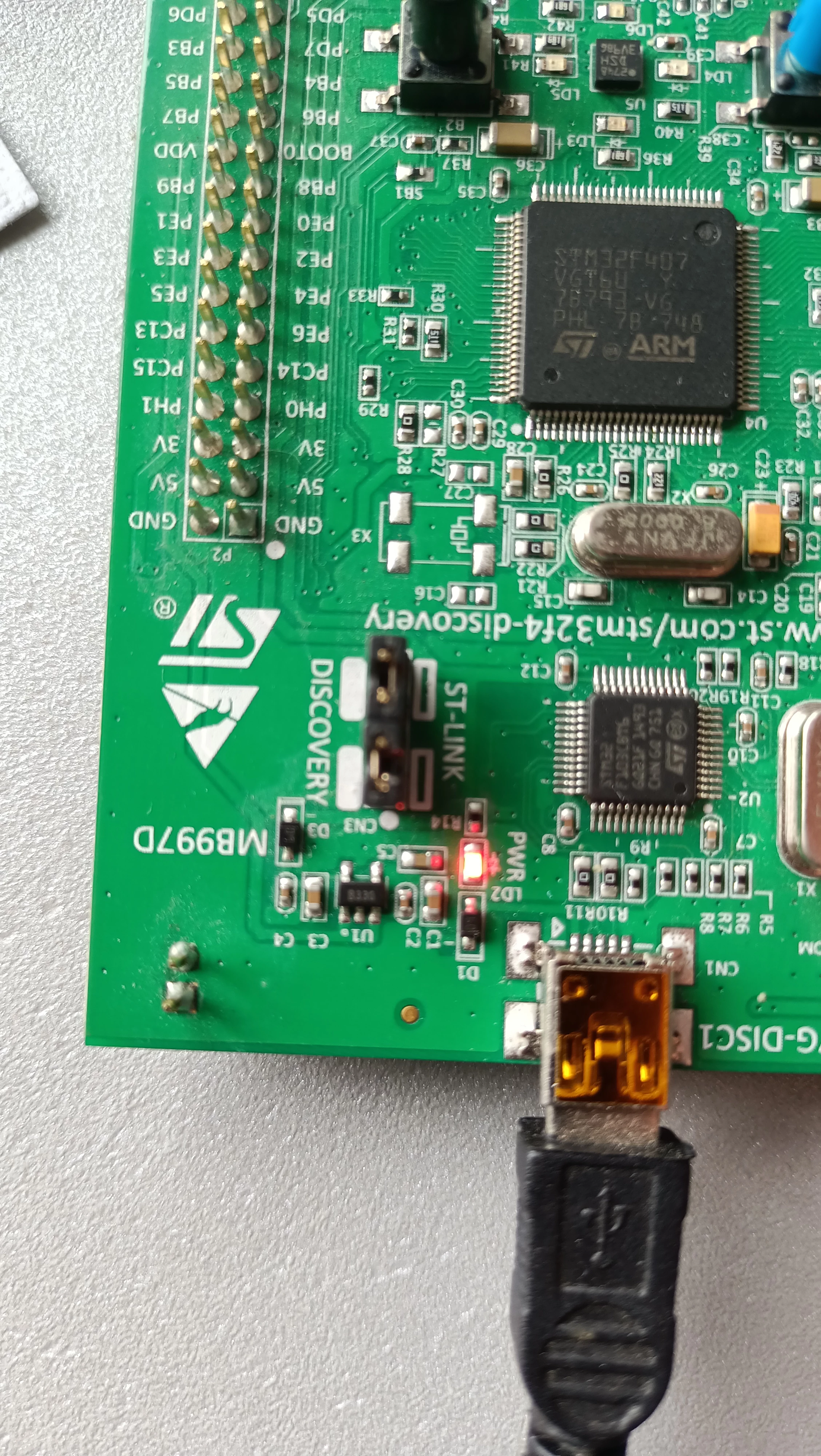

One of the possibility is that the board is not powered properly. So check the jumpers on the board make sure it gets power from the cable. The jumper should be on ST-LINK.
October 6, 2025
Assuming this is the jumper you mean, it seems in order.

Ok, I found a solution that works on my computer. I edited the .rules file so that GROUP is always uucp:

I had the same issue with Fedora 43 and CubeIDE 2.x (newest at the time writing this).
STM32CubeIDE installed as normal user but root/sudo password given during installation.
Debug session worked only when the "ST-LINK_gdbserver" (with its long path) was started using "sudo".
I replaced the GROUP to be "dialout", certainly the "plugdev" was not enough.
Need to dig in bit more, I guess, since the older versions seem to work ok with "plugdev". Apart from OS update
the difference seems to be that plugdev has been create by system (in e.g. Debian) whereas I created it manually
in F43 - this based on the numeric group id (46 in Debian, 1001 in F43). So the issue may be in either OS setup
or CubeIDE (v 2.x) installation - at least in my case.
