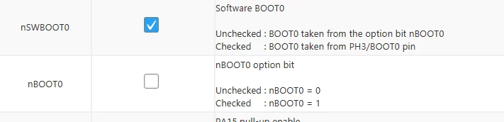

I have setup nSWBOOT0 = 1; nBOOT0 = 0 and BOOT0 = high.

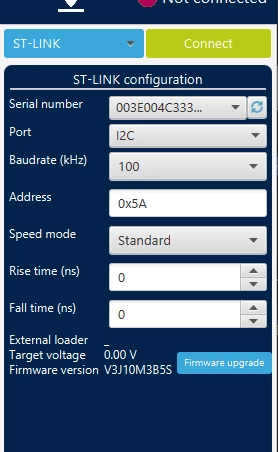

I tried connecting with STLINK-V3SET connected to I2C2_SCL and I2C2_SDA plus GND. Using the STM32CubeProgrammer I cannot connect to the Bootloader via I2C(using 0x5A as an Address).
I am able to get acknowlege from other slaves that are on the same BUS using the STLINK-V3SET and also using a third Vendor I2C Analyzer. BUT no acknowledge on Addres 0x5A!
