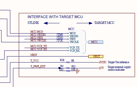

I am trying to make some very low current (<1uA) power measurements on the MCU on the STM32U083C-DK demo board.
I see that jumper `JP7` is provided specifically for this purpose, but I am concerned that connections from the MCU to the STLINK interface might leak current and throw off these measurements- especially when testing with MCU Vcc voltages that differ from the STLINK supply voltage.
Is this a valid concern, or are those connections equivalent to air-gapped when the MCU is normally running?

>>Is this a valid concern...
Probably, perhaps also look at the CAD files, see if there's anything that can export a Net List.
You might be able to mitigate somewhat by switching the pins here into an analogue input / tri-state. I'd suggest initiating that as a console/monitor command to the system, rather than at start-up, such that recovery and reprogramming is kept workable rather than immediately thwarted.
Yes - absolutely!
You really need to scour the schematics for all possible leakage paths - the documentation doesn't necessarily cover them all.

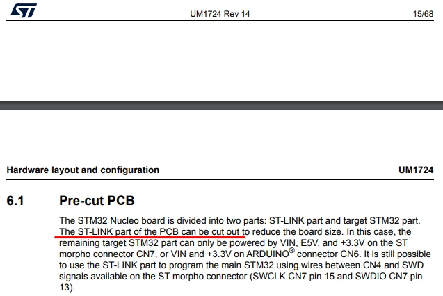

I don't think anyone really expects the ST-Link section to talk to the mainboard MCU by telepathy.
But It is unclear what the point of the slots are. Are customers just supposed to just snap off the embedded ST-LINK? That's definitely one way to air-gap.
yes, that is exactly the point!

> the path by which they do so should be manifest rather than hidden.
If the ST user manual instructs you to snap off the complementary ST-LINK module and reconnect it with a harness to the board, that's pretty "manifest". it's also easy to "visually verify". etc. You like the way TI does it? you're free to do so.
But, you suggested ST didn't even consider the need to completely and provably disconnect the embedded ST-LINK from the rest of the system, and I showed you that you are wrong about that. So now, you dislike the way they do address this need - and that's also your prerogative. I suggest we leave it at that.

@BarryWhit wrote:
ST didn't even consider the need to totally and provably disconnect the embedded ST-LINK from the rest of the system
It's possible on the Nucleos with the break-off ST-Link, but not on other boards.
The OP's STM32U083C-DK doesn't have the break-off ST-Link.
The LRWAN1 in another without the break-off ST-Link, and it has some obscure & undocumented leakage paths.
