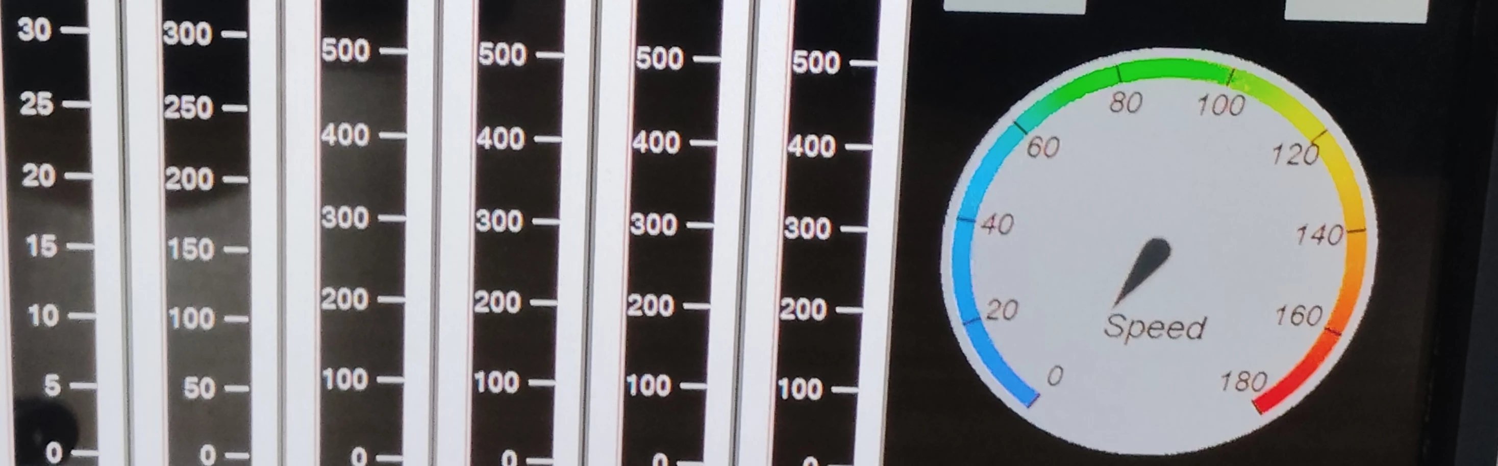

interface STM32H745XIHT6 microcontroller with 10.4inch touch screen GT928 i2c
Greetings for the day,
I'm working on STM32H745I Discovery board for 4.3 inch Touch Screen Controller ( GT911 i2c interface) able to control LED by touching flex button, working fine as per our requirements (for reference).
We're using our customized board STM32H745XIHT6 microcontroller IC with 10.4 inch LCD screen (LVDS 1024*768 part no  TCG104XGLPAPNN-AN30) with touch screen(part no-RXC-GG104098) & touch controller IC (GT928 i2c interface) in our project. I'm using TOUCH GFX DESIGNER 4.18.1 for GFX designing, created a flex button with interaction its working in GFX simulation & GFX designs are displayed on screen, the code generated successfully all the necessary library is added code is error free, but unable to control the LED by touching on flex button. As per my observation there is some issue with touch configuration I'm not getting output from touch controller.
Please find the data sheet attached for both (4.3 inch & 10.4 inch) touch controllers.
I would request you to look into the matter and provide some guidance. Let me know if you need anything else.

Debug Observation:-  In stm32h745i_discovery_ts.c file
function  BSP_TS_Init(uint32_t Instance, TS_Init_t *TS_Init) returns a value
if(FT5336_Probe(Instance) != BSP_ERROR_NONE)
ret = BSP_ERROR_NO_INIT;
I'm using i2c slave address oxba as per datasheet provided unable to find the FT5336_ID its not available in datasheet.
Please find the TouchGFXGPIO.cpp content.

Your custom board require custom BSP for your touch and lcd init...
And TouchGFXGPIO.cpp is irelevant here
Use STM32TouchController.cpp and as debug i mean your real display work before use touchgfx.

Your custom board require custom BSP for your touch and lcd init...could you please explain How to customize BSP...
Already  made the required changes to file  STM32TouchController.cpp & stm32h745i_touchcontroller.cpp file attached.
 Already mentioned in my first query that the real display is working fine can display text blocks, box, analog meter. display is working fine its totally in my control.  1000029894.jpgHaving trouble with touch integration only.
Is it possible to connect via call for better understanding...
