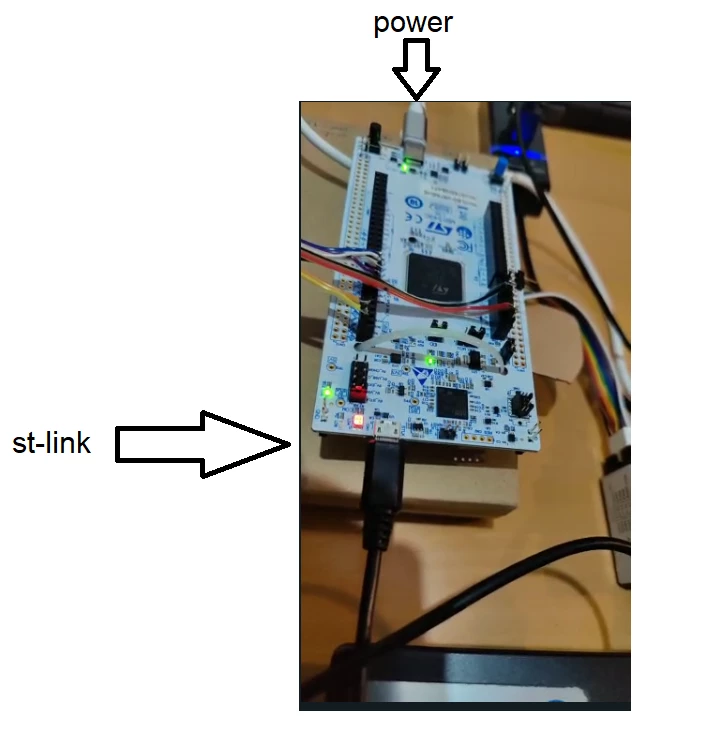

December 12, 2021
Show schematics how you connect your ST-LINK
why 3.3v when u can 5000V
December 12, 2021
0693W00000HoJF3QAN.pngA picture of how I connected it
December 12, 2021
for some reason led 1 to 3 are blinking in order from 1 to 3

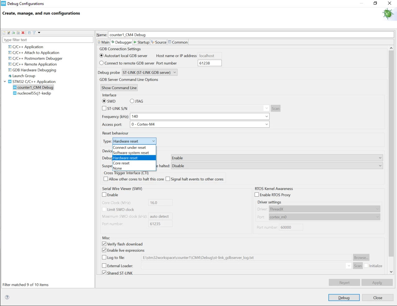

November 25, 2022
In my case, I get it to run by setting --> menu Run.Debug Configurations. Debugger:
1) connect to remote GDB Server Port Number change to not 61234 --> 61238, (while still chose Autostart local GDB server, Connect to remote GDB Server is not chosen, just change the number
2) Reset Behaviour: choose Hadware reset
Then it runs smoothly every time.. :) :), I really don't know what is the best/correct answer, just sharing my experience...
