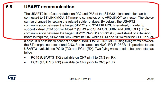

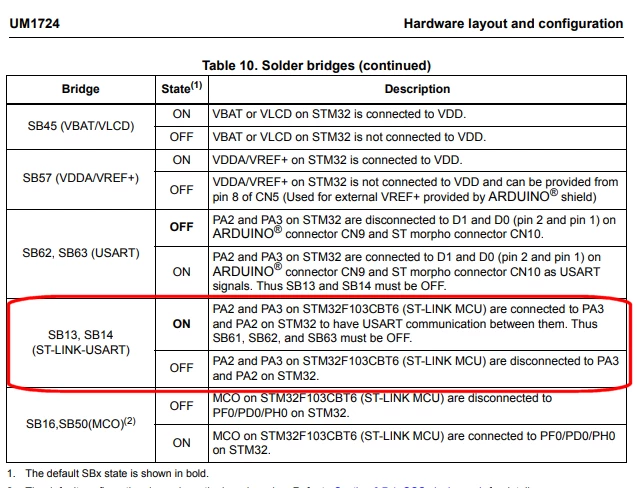

The on-board ST-Link's USB-to-UART ("VCP") is already connected to UART2:
https://www.st.com/resource/en/user_manual/um1724-stm32-nucleo64-boards-mb1136-stmicroelectronics.pdf
so you're going to have to disconnect the ST-Link VCP for the external CP2102 to work:
Or use a different UART.

Thank you! Thanks to the reply above you as well as your kind reply (I never thought to disconnect the ST-link, I thought that it'd be fine as long as it was not connected), I was able to finally communicate using the external usb-uart bridge. Thank you for the additional sources as well.

I never thought to disconnect the ST-link, I thought that it'd be fine as long as it was not connected.
The physical connection from the ST-Link's UART to the Target MCU's UART is hard-wired on the board - it's there whether or not the USB is active.
