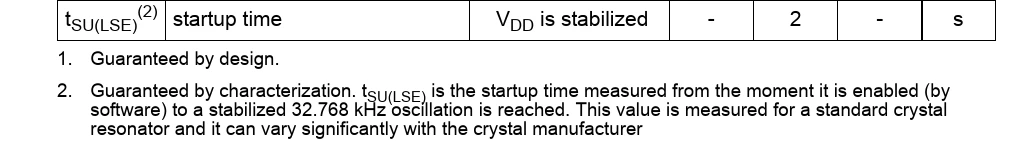

It looks as if it takes 2-10msec after the backup domain reset before the LSE is stable.
AScha.3
April 13, 2023
LSE startup can be long... (from F407 data.)
