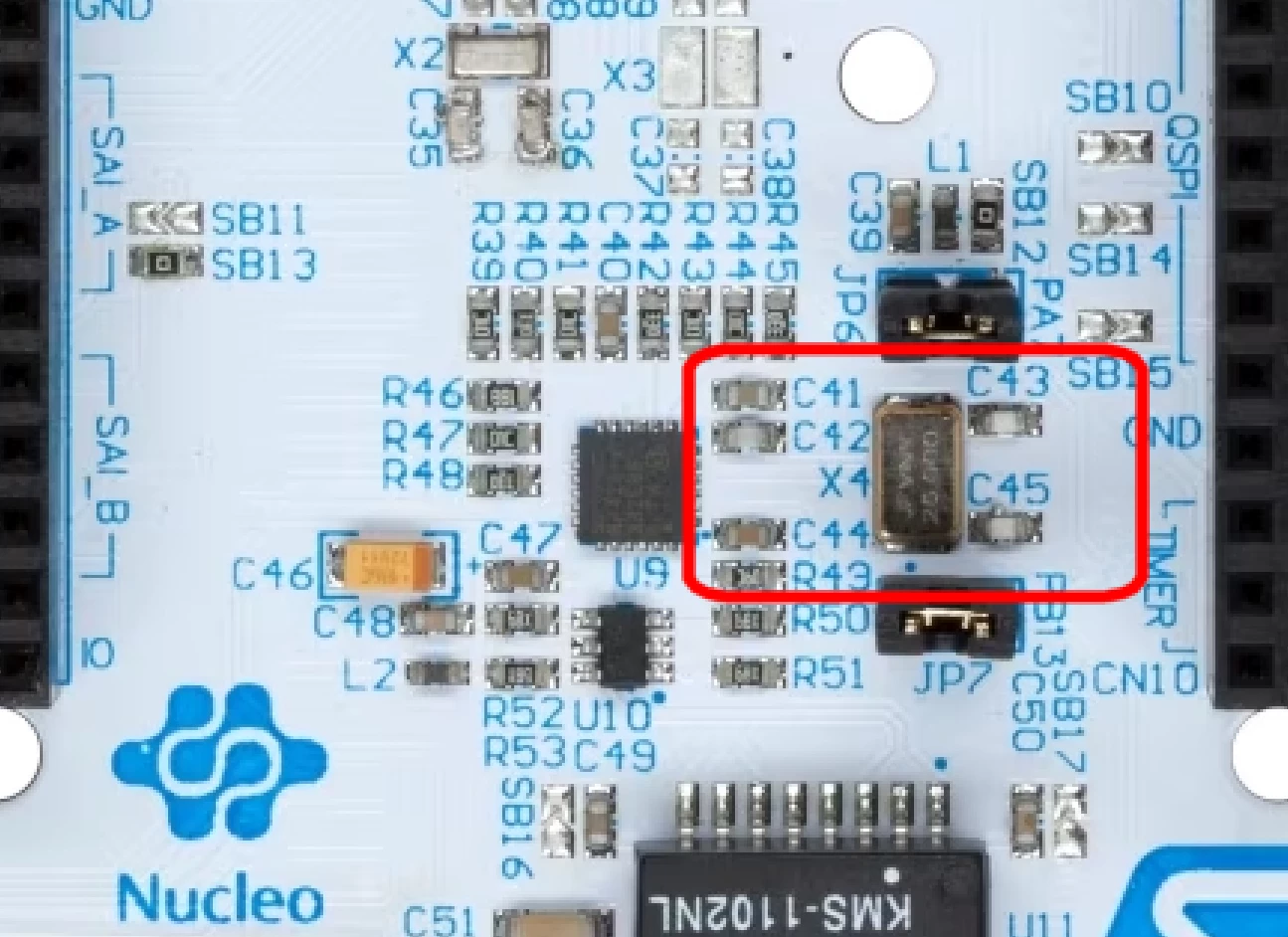

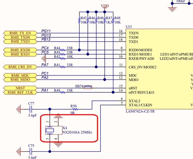

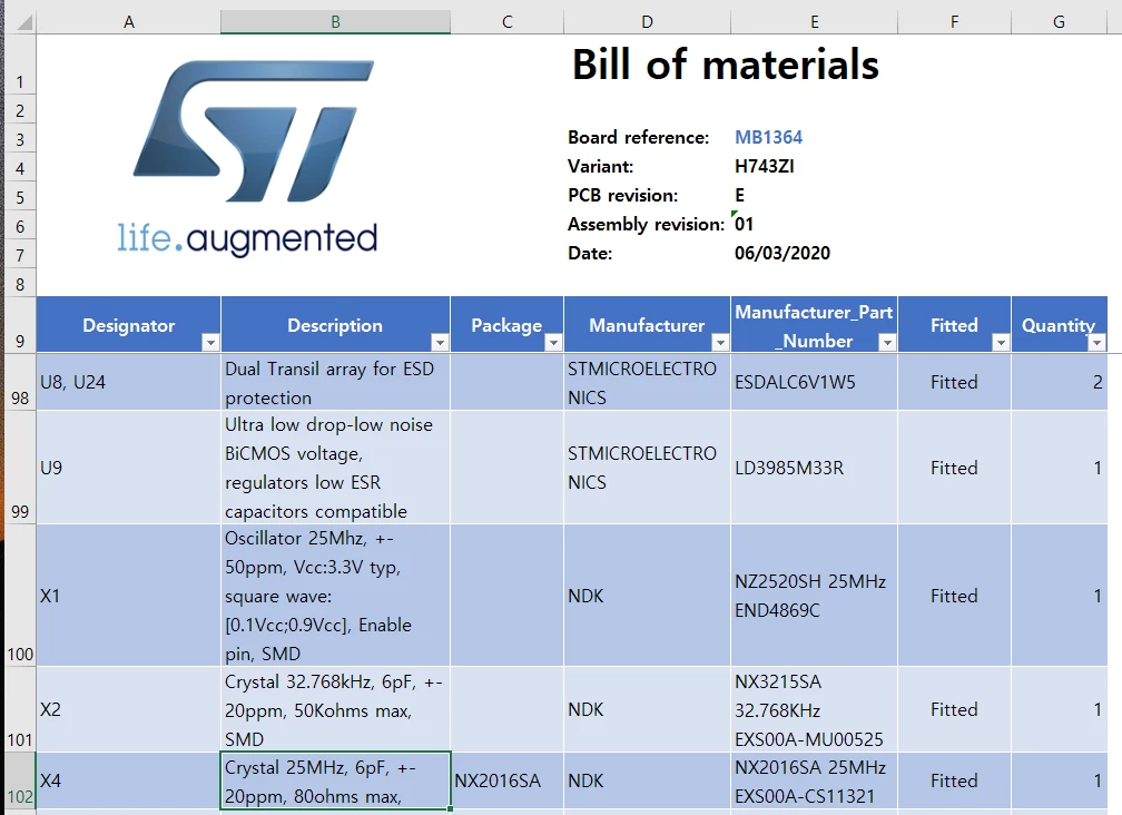

I purchased a soldering crystal for X3 according to the BOM list,HMsDobby2_0-1713509210530.png
but it seems that the X4 on the board is the same product.
Where is the X4 used?
You can  see that in the schematics:
Also from the picture of the board:

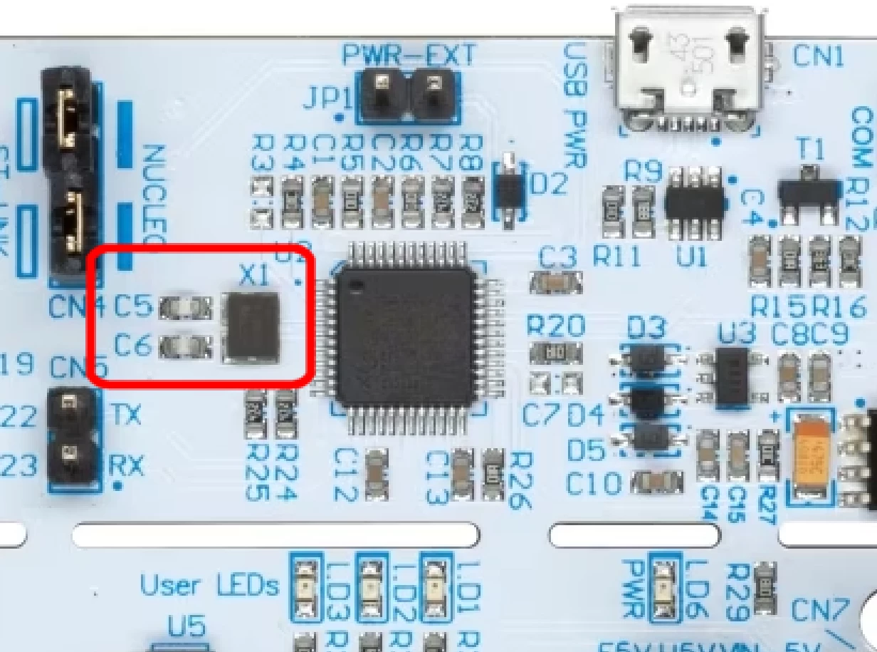

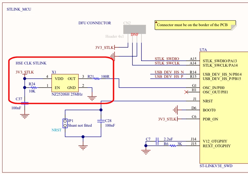

Plus, Is it correct that the MCO (default) from STLINK-V3E uses the X1 source?
Again, see the board schematics:
(so, actually, it's not just a crystal - it's an oscillator).
Also, from that board picture, X1 is adjacent to the ST-Link chip - so it will be the crystal (rather, the clock source) for that chip:
