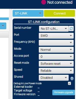

I've just received my fresh new SMT32H747I-DISCO dev board and I wanted to try some samples.
I have some experience deveolping on embedded Liuxes, but this is my second MCU (the first one was a Raspberry PICO, don't know if this counts). I am using a MacBookPro with Apple silicon (M3) and MacOS 14.4

but that's it. I wanted to install the Tutti Fruit  demo  (whose binary I downlaoded) but the first thing is to "connect" STM32CubeProgrammer to the board, and I cannot. When I press the green Connect button in the top right area (whtth this config), i got
18:13:44 : ST-LINK error (DEV_CONNECT_ERR)
18:13:44 : Error: Problem occured while trying to connect
I've tried to search the internet and this board, but I don't seem to do anything particular (a part from running on a Mac with M3). So I don't know if this is blocking or what.
Or maybe I need to connect in another way?

I encountered this issue today with the same laptop and the same Discovery Board. My issue was solved by using an Apple-branded USB-C-to-USB connector. 🤦‍:male_sign:
