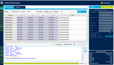

TLRD: I cannot connect to a STM32H747I-DISCO board using my Mac/M3.
my setup is a MBP with M3 (Apple Silincon) and  MacOS Sonoma 14.4. Installed latest release of STM32CubeProgrammer and bought a STM32H747I-DISCO dev board. Connecting through a USB-C to Micro USB cable on default port CN2 (labeled STLINK-V3E USB connector) and verified that the Jp6 Jumper is set correctly to STlk.
Checked on system preferences that there is a STLink under the USB tree of MacOS.
The board lights up and the connect led flashes then stays green. The powe led below stays green. Nothing shows up on the touch screen.
Upon launching STM32Connector I cannot connect to the board with buttons. I've tried upgrading the firmware with the corresponding button/modal dialog.
Sometimes (after plugging and unplugging the USB cable) the system detects the firmware SN (it's a long string of numbers) and gives the option to update, but then fails.
In the meantime the ST_Link configuration panel shows a Serial number in the Drop down (after a refresh). Port is set to SWD.
After trying to connect explicitly or updating the firmware, every trace of serial number diasppears.
What's more, my Mac complains that the disc STM-I747X (or something like this string) was unplugged before being unmounted.
When I can see the "disk" mounted, if I click on it in the Finder window, the system hangs for a little while then the disk goes away with the same above message.
The least I can say is that everything is very unstable.
Is it because I am using a MacBookPro and what's worse, an Apple Silicon chip?
Any idea on how to debug this issue?
Thanks
That's the most I have achieved. When I get back to my lab I can share a screenshot of the Firmware update panel if I can get it "working" again.

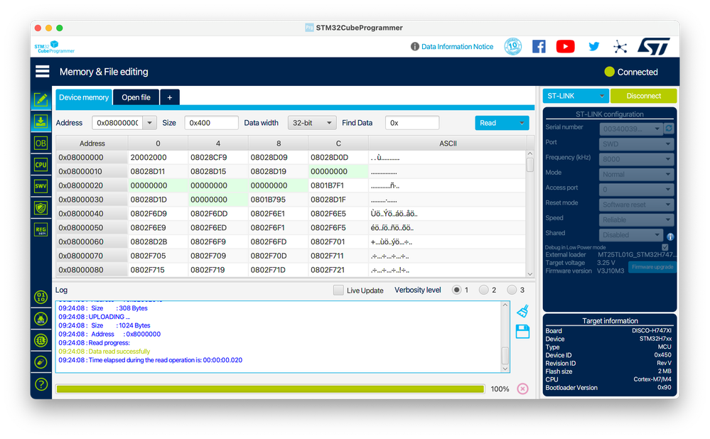

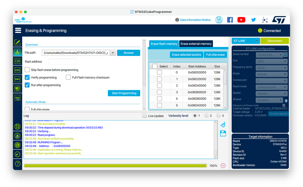

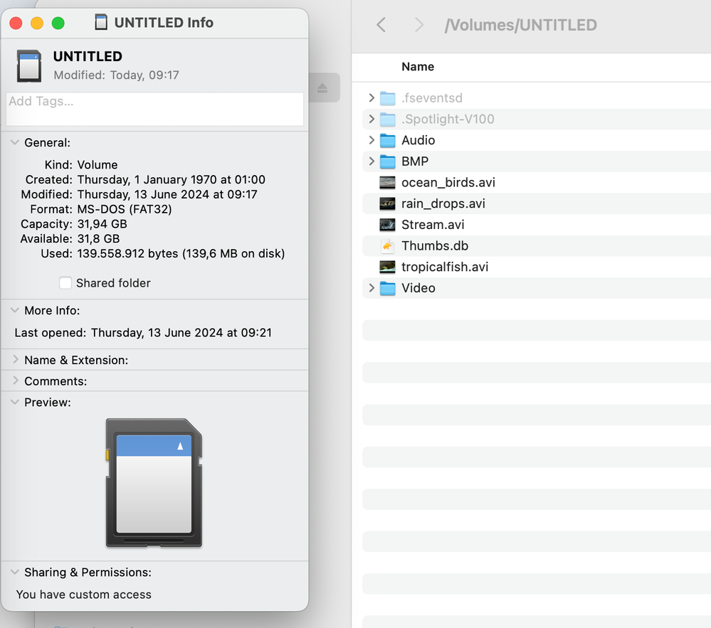

June 13, 2024
Hi @FBL ,
I've tried everything from scratch:
  • formatted the SD as MS-FAT (FAT32)
  • copied multimedia files (see image)
  • followed the readme in the latest download :
  • 2- Open STM32CubeProgrammer, go to "External loaders" menu then check "MT25TL01G_STM32H747I-DISCO" box
    3- Connect the STM32H747I-DISCO board to PC with USB cable through CN2 and click on STM32CubeProgrammer "Connect" button
    4- Use "STM32Cube_Demo-STM32H747I-DISCO-VX.Y.Z_FULL.hex" file provided under "Binary" with STM32CubeProgrammer
    to program both internal Flash and external QSPI memory.
    - From Erasing and programming Menu browse to select the "STM32Cube_Demo-STM32H747I-DISCO-VX.Y.Z_FULL.hex" file (mine is STM32Cube_Demo-STM32H747I-DISCO-V1.0.0_FULL.hex dated from 27 Feb 2019)
    then click on start programming
  • I've also set "verification on" and "run after programming"
Everything is OK but nothing shows on the display. The main led blinks
Any idea on what I am missing?
There is something basic I think.. why the led blinks?
Thanks
W
Screenshot 2024-06-13 at 09.22.12.pngScreenshot 2024-06-13 at 09.24.29.pngScreenshot 2024-06-13 at 09.34.18.png
June 14, 2024
Hi again @walterg
Unfortunately Demo binary is built for an old revision of the board and it is no longer maintained. Could you try the updates to support Dynamic ID? You need to update patch of CubeH7.
Update STM32H747I-DISC BSP board drivers to support Dynamic ID · STMicroelectronics/STM32CubeH7@dd1b1d7 (github.com)
To give better visibility on the answered topics, please click on "Best answer" on the reply which solved your issue or answered your question.Best regards,FBL
