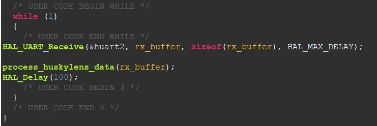

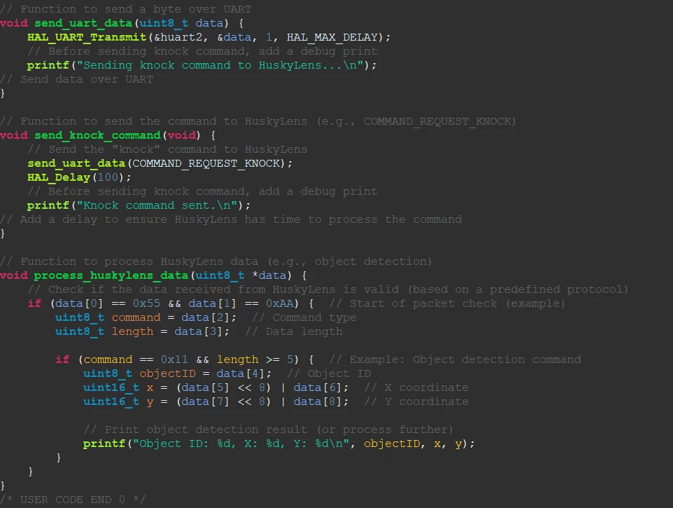

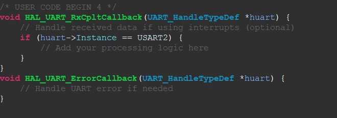

I want NUCLEO-U083RC board able to receive data from Huskylens for colour/object recognition project. I did manage to run a demo code but still can't receive data from Huskylens. I have use HAL_UART_RECEIVE and HAL_UART_RECEIVE_IT function and still got no output from Huskylens.
Code I'm currently using:
AmirImran_1-1742196122267.pngAmirImran_2-1742196157431.pngAmirImran_3-1742196203640.png

Your code shows you are using USART2 which is typically the VCP port. You have not shown how you've wired the Huskylens to the Nucleo. U(S)ART is push-pull type so you can't have 2 devices, VCP and Huskylens, connected to the same USART of the STM32.
What you should do is use the Nucleo as a gateway to communicate to the Huskylens. Use VCP (USART2) connected to a terminal window like Docklight, and then use USART3 (PC10/PC11) connected to the UART of the Huskylens. So when you receive a message from Huskylens on USART3, you relay the message out to USART2 to the terminal program.
