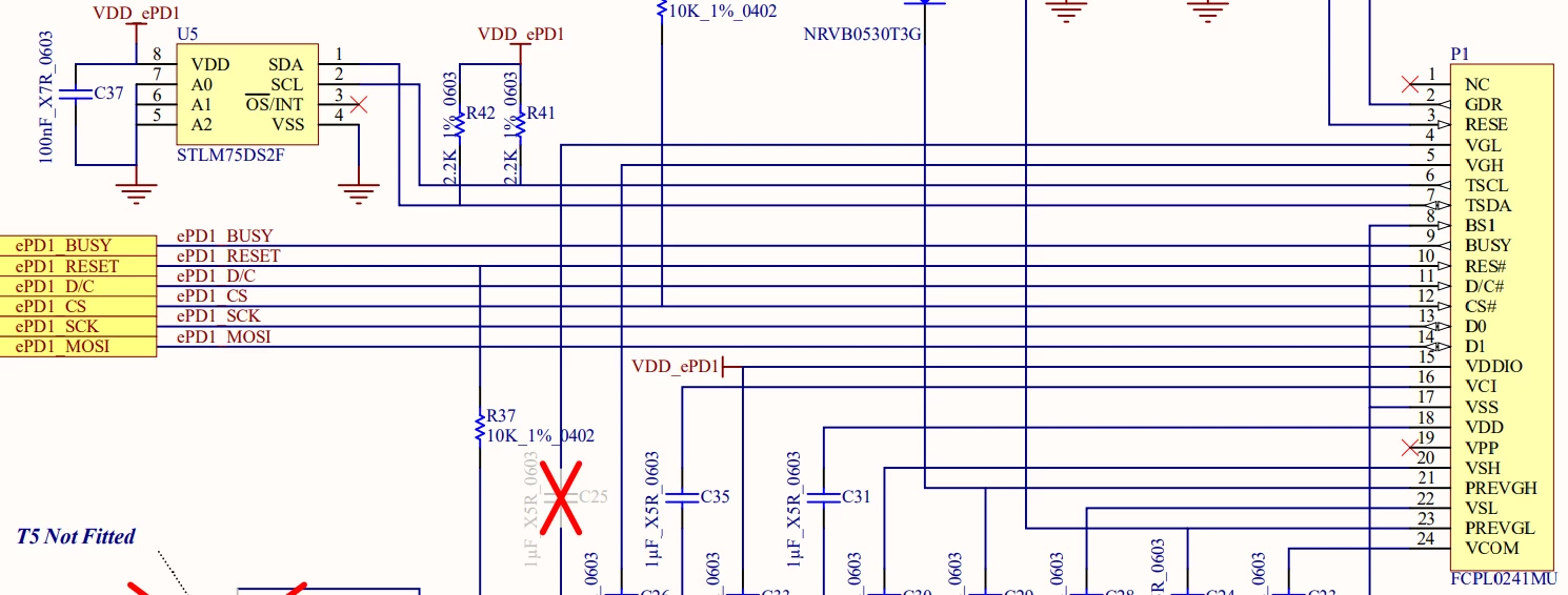

I tried to get temperature data from LM75 via I2C on STM32L0538-Discovery.
But in following test program, HAL_I2C_Master_Transmit() and HAL_I2C_Master_Receive() returned HAL_BUSY.
What's wrong with it?
And I couldn't check from the schematic diagram on UM1775 if LM75 is connected with the STM32L0538.
Please show me how to solve it.
Thanks
In following test program, HAL_I2C_Master_Transmit() and HAL_I2C_Master_Receive() returned HAL_BUSY.
Though in MX_I2C1_Init()  hi2c->State was HAL_OK, but entering to HAL_I2C_Master_Transmit(), hi2c->State was changed to HAL_BUSY.
I thought LM75 is not connected with MCU,  I couldn't check from the schematic diagram on UM1775 if LM75 is connected with the STM32L0538 or not.
Thanks
I don't see any mention of an LM75 in any of this board's documentation:
https://www.st.com/en/evaluation-tools/32l0538discovery.html
But it does appear on the schematic:
https://www.st.com/resource/en/schematic_pack/mb1143-l053c8t6-b03_schematic.pdf#page=5
curiaeAuthor
Oct 22, 2024 9:33 AM UTC
Sorry, I should have written formal name STLM75.
Could you tell me why HAL_I2C_Master_Transmit() and HAL_I2C_Master_Receive() returned HAL_BUSY.
There are something wrong in MX_I2C1_Init()?
