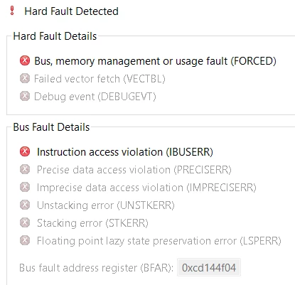

So when I debug it and let it run, I jump to the HardFault_Handler(). The Fault Analyzer looks like this:

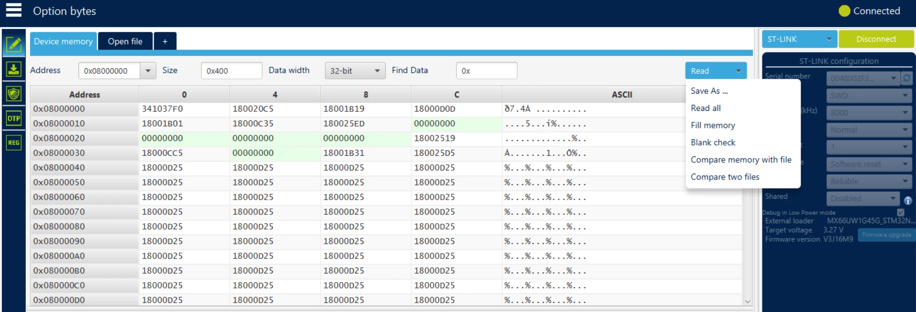

Unfortunately under the OB tab I can not find the option Reset MCU to factory settings. It looks like this:
And as far as I know, I didn't program any option bytes, at least I didn't do it on purpose.

Hello @Pfaa,
Thank you for your patience. That is unusual. Could you please attach the project that failed to execute and caused the hard fault? I understand it is the example provided by ST, but I am interested in any changes made to the environment by STM32CubeIDE. Debugging crashes may leave the debugger in an inconsistent state or corrupt the CubeIDE workspace metadata. Meanwhile, I suggest downloading a fresh firmware project and running it in a new workspace in CubeIDE.

There are no Option bytes on the STM32N6, only OTPs (One-Time Programmable bits). And I have checked the list of OTPs you sent, and it seems correct to me.

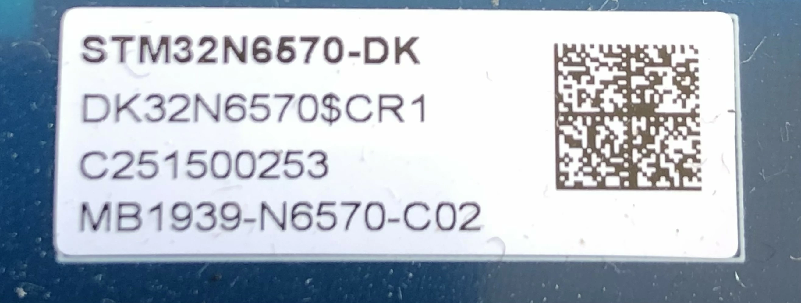

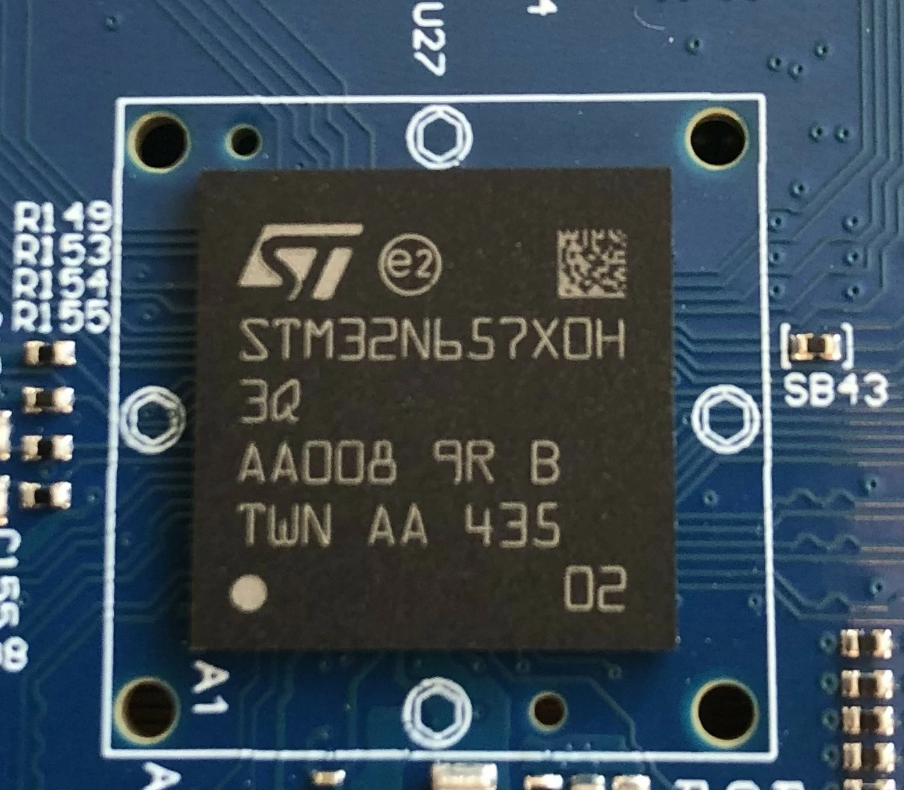

  3. Can you share both the version of your STM32N657-DK and the marking of the non-working STM32N6?

Sorry for the late reply. To answer your questions:
1. Yes, in DEV_BOOT, after a reset, LED2 is on.
2. Unfortunately I am not 100% sure if it was working correctly in the past.
3. Images below
