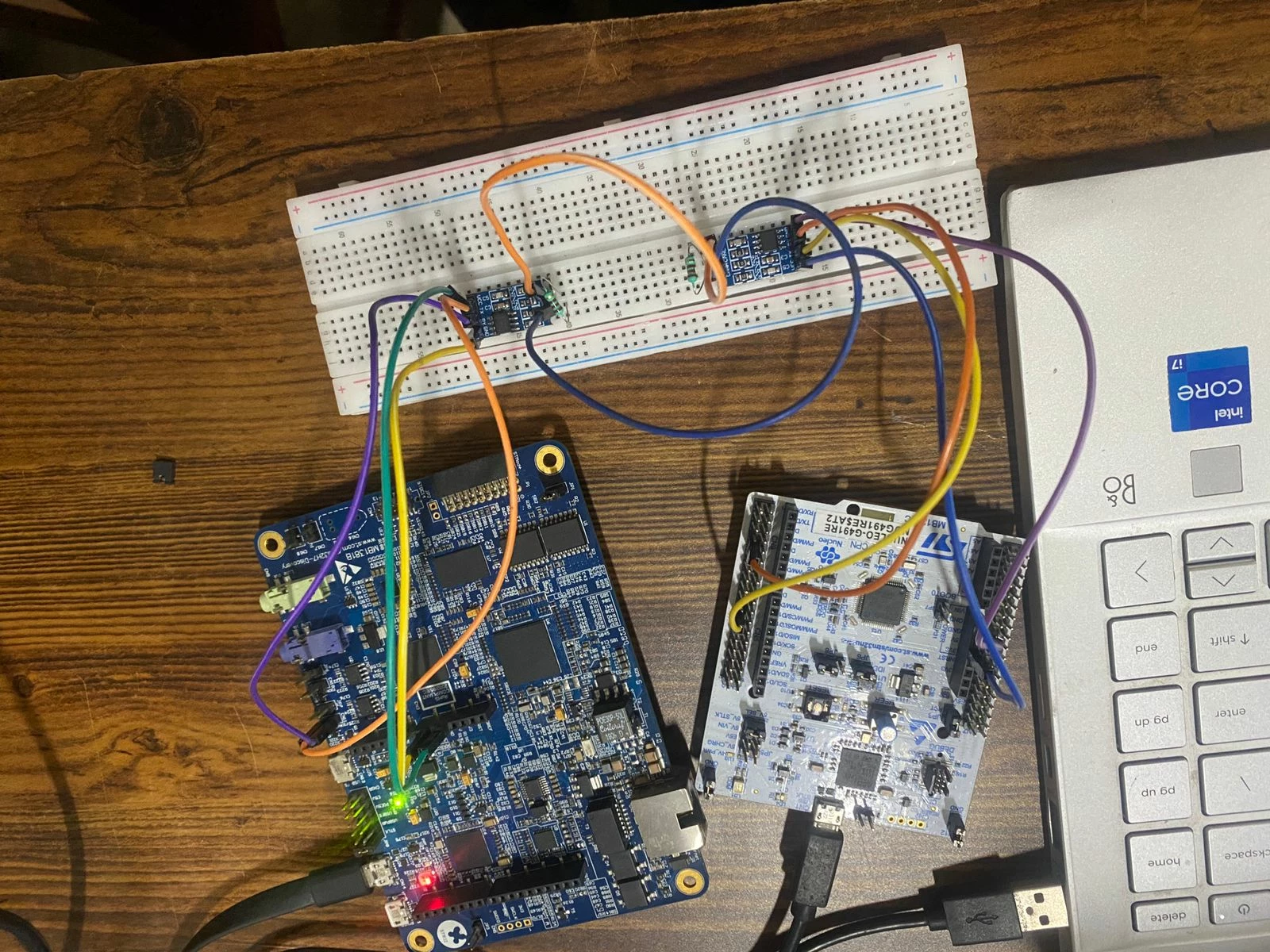

the objective of this particular project was to transmit data frames from stm32h750dbk(discovery kit) to stm32g491re(nucleo)
it is debugging and creating live expression for both of the data types in receiving and transmit end of board i have not connected any transceiver between them because it has inbuilt fdcan ports
i am attaching both the codes for g4 and h7
the picture of hardware and the live expression result when debugged separately

Thank your for sharing the image because it raises a big issue.
You are using CAN in a bad hardware configuration.
From the disco board there is a CAN-FD transceiver (CAN_H/CAN_L) that you connected directly to FDCAN_Tx and FDCAN_Rx in the NUCLEO board!
You need to add a transceiver to the NUCLEO board to establish a CAN bus between two CAN nodes like the following:
You can also refer to this article and the related Github hotspot.

Feb 11, 2025 2:59 PM UTC
IS the connection right now

Sorry I didn't notice this issue:
@revvathi wrote:
You don't need a transceiver for the DISCO board side. It has already a transceiver on board:
Also, refer to the figure I previously shared.
If you are not familiar with CAN bus need to have more information about it.

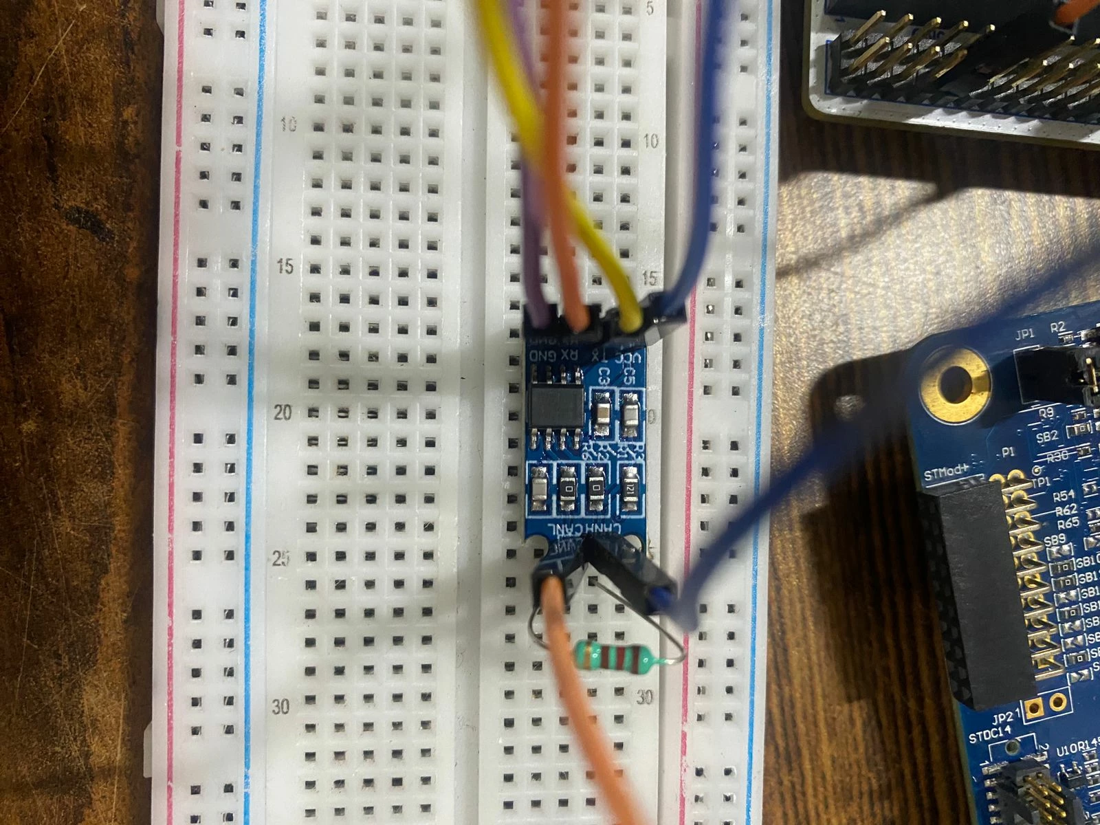

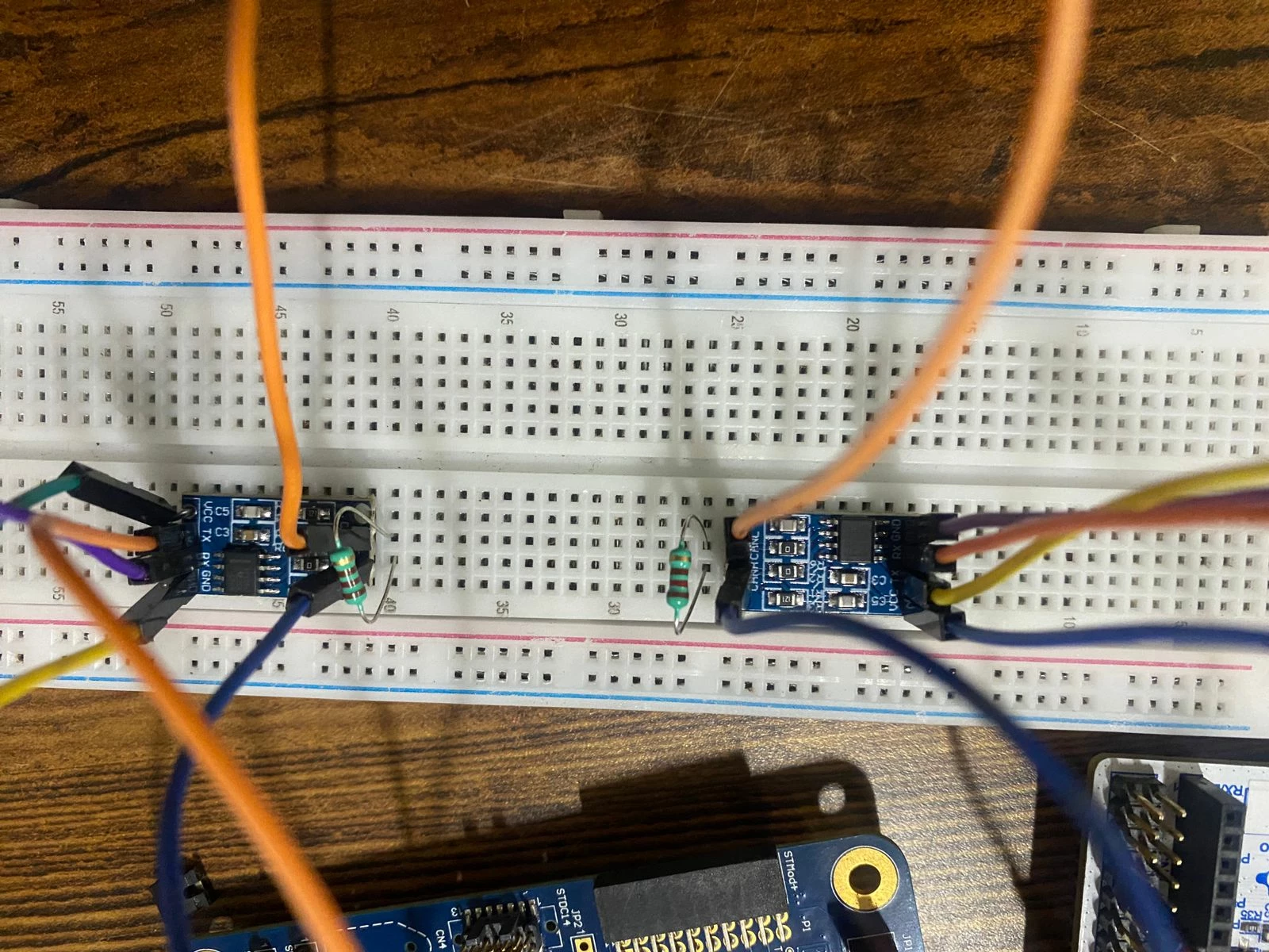

1- Do you mean the data are transmitted were not received? By whom? which is transmitting and which is receiving?
2- The CAN module:
revvathiAuthor
Feb 11, 2025 3:19 PM UTC
1)H7 is transmitting and G4 is receiving
2)can transciever module used is NXP TJA1050 WhatsApp Image 2025-02-11 at 8.43.01 PM.jpegWhatsApp Image 2025-02-11 at 8.42.58 PM.jpeg

I am implementing FDCAN communication between an STM32H750DBK (transmitting) and an STM32G491RE (receiving) with a CAN transceiver connected on the G4 side. I am using STM32CubeIDE for development.
On the H7 side, when I load data into the FDCAN transmit buffer, I can see the correct values in the live expressions window. However, when I start execution, the data does not clear from the buffer as expected.
On the G4 side, the live expressions window shows that the receive buffer is ready and initialized with a 7-byte array, but no actual data is being received. Additionally, I am unable to run both boards simultaneously in CubeIDE due to multiple ST-LINK interfaces being detected.
also the transceiver  doesn't need a 120 ohm terminating resistor read tht it has an inbuilt resistor already
