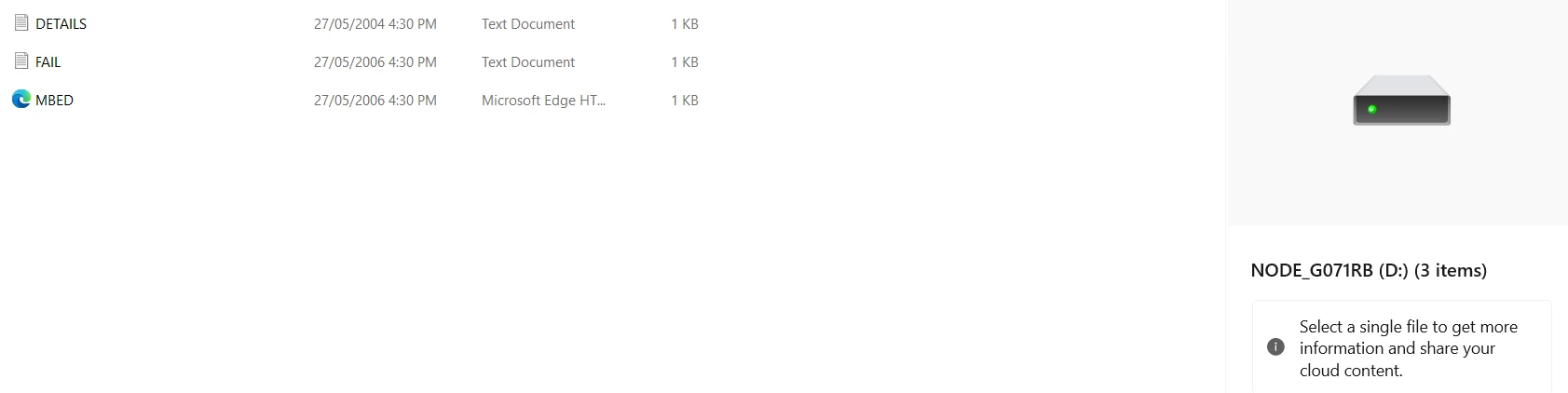

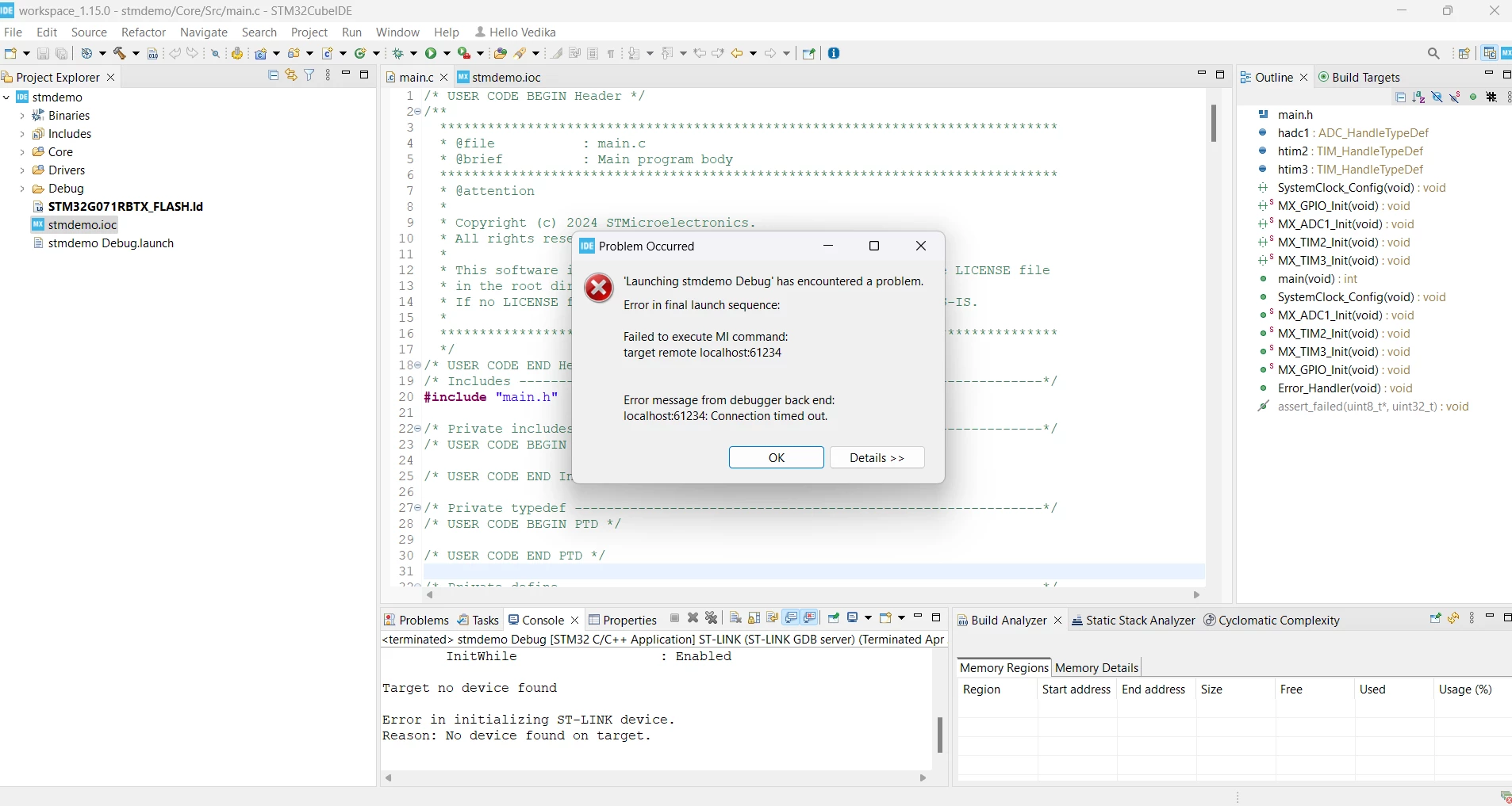

I own a STM32 NUCLEO G071RB. The STM CubeIDE software was working fine for a couple of weeks until I got the error message:
Target no device found
Error in initializing ST-LINK device.
Reason: No device found on target.
The board still lights up and now when connected my computer open the node G071RB file (see image attached).
I have tried all solutions from reinstalling STM32 CubeIDE to installing STM 32 programmer. But nothing is working. I have attached a file below that can help understand the problem.
Thank you for your time and consideration.

Hello @stmproblem348 and welcome to the Community :)
Check that the jumpers are correctly configured on your board.
Make sure that your ST-Link firmware is upgraded.
Try to "Connect under reset" or "power down" mode.
Check this post that may help you on how to prevent and fix debugger connection issues.

Thanks, one of my ST link jumper's cap went missing.
