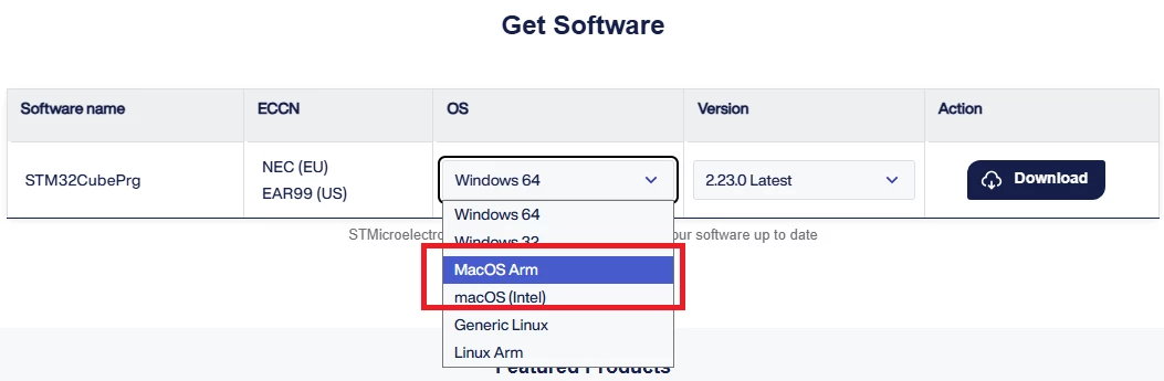

How would I actually do it? I think I would need to be using this utility, since I’m on a Mac:
I do have access to a Windows laptop but it’s not the most convenient option.
Also, looking for the Windows software on st.com is a bit frustrating.

Install STM32CubeProgrammer tool downloadable from here: https://www.st.com/en/development-tools/stm32cubeprog.html
Please watch this video on Youtube: [Getting started] STM32CubeProgrammer
PS: avoid using cloned STLINK as you may face connection issues. Read this: How to recognize a genuine ST-LINK/V2 versus a cloned one

The Adafruit part worked perfectly perfectly with that application.
