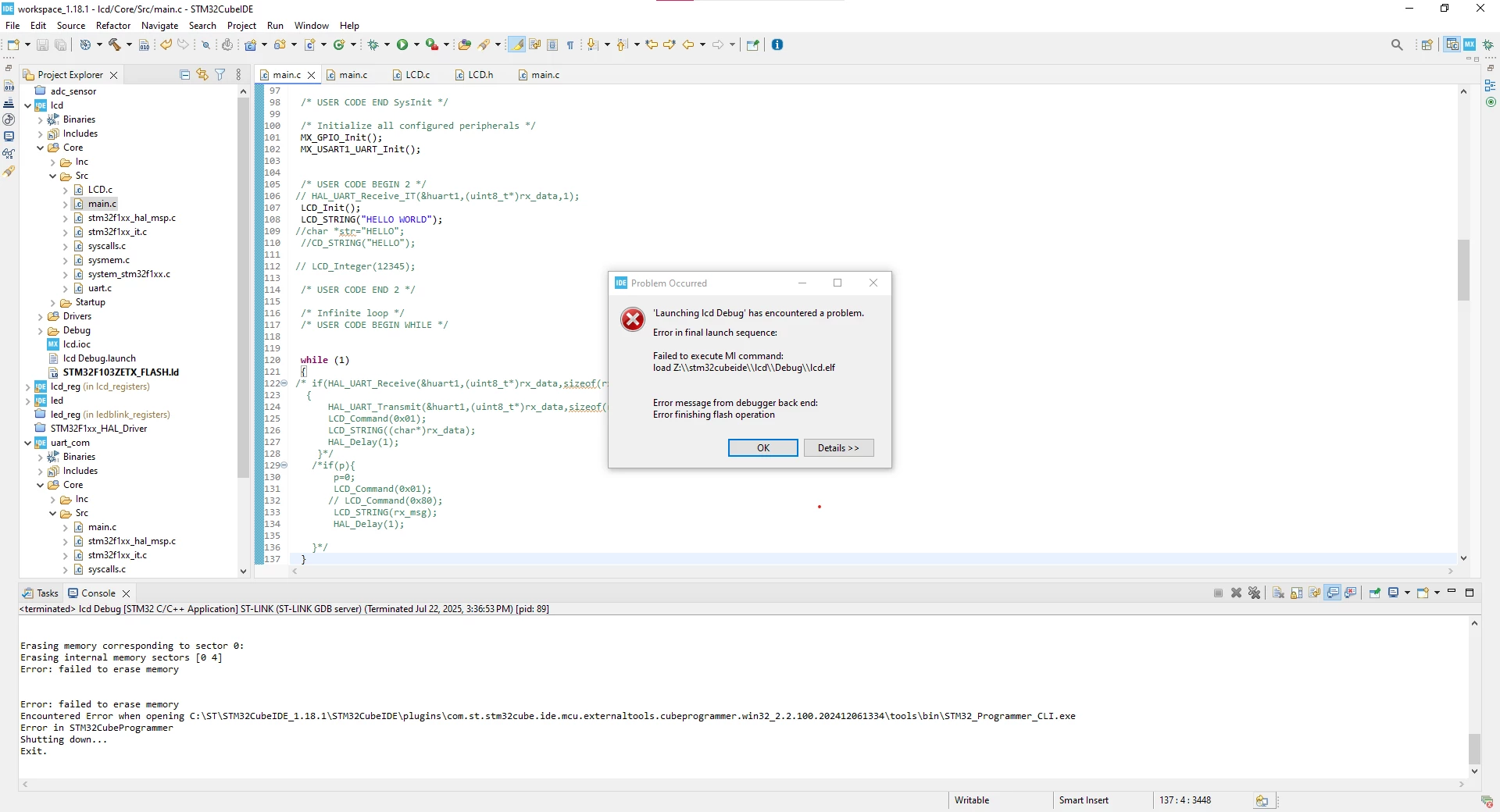

Code works in another board, but not in my custom board.
Original title: Facing a debug issue. the code works in another board and gets firmware update. but its not working in my current stm32f103zet6 customized board.

and i checked in st link utility ,the firmware is upgrading but in stm32cubeprogrammer its not even connecting when i try to upgrade it its started upgrading at the end its saying the st link connection is lost ..whyy??
Is this with the original board, or the "custom" board?
What CubeProgrammer version?
What ST-Link are you using? Is it a genuine ST-Link?
See: How to recognize a genuine ST-LINK/V2 versus a cloned one.
Please show the full log from CubeProgrammer; also a screenshot.

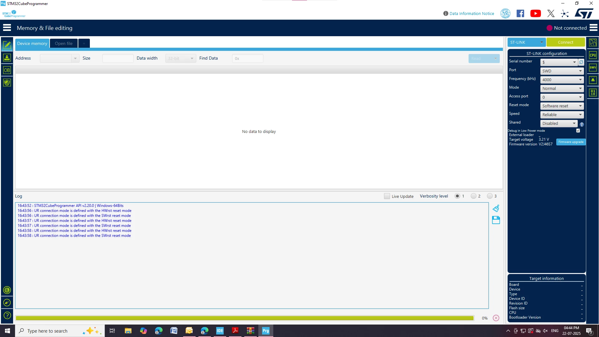

anuradhaAuthor
Jul 22, 2025 10:59 AM UTC
It worked after erasing full chip. But i have a question In my stm32cube programmer whenever i connect my target board its showing the only message like "Ur connection mode is defined with HWrst reset mode .Iam using 2.20.0 stm32cube programmmer version
I put mode: under reset
reset mode: hardware reset
and if i click option bytes option also its still sending the same message....
Andrew Neil
Jul 22, 2025 11:07 AM UTC
@anuradha wrote:
 message like "Ur connection mode is defined with HWrst reset mode....
Please show the actual message.
And a screenshot showing your settings.
