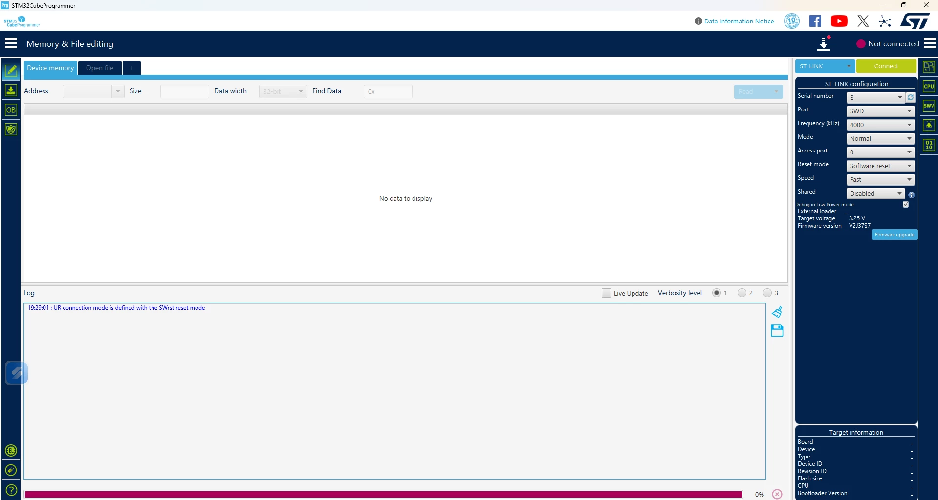

I've never used STM32CubeProgrammer or a ST-Link V2 so I don't know what it should look like. I've bought the one at this link https://www.aliexpress.com/item/33010611392.html
When I open  STM32CubeProgrammer  and click "connect" nothing happens, apart from the message in the log window
The serial number is shown as "E"
Do I need to do something to make this device work? Or where can I buy one that works out of the box?

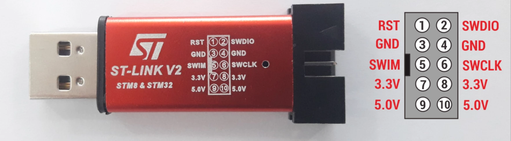

There is no official product that looks like this, so they are all knock-offs:
The ST programmers are not particularly expensive compared to the chips. See STLINK/V3MINIE.
