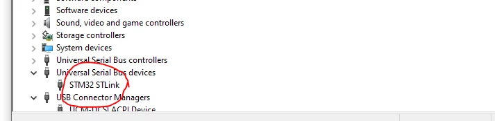

@KMINH.1 What exactly shows the device manager? You don't need to upgrade the firmware.
KMINH.1
KMINH.1Author
October 26, 2023
Hi @Pavel A.
      I am testing in 2 ways,
1. With in built stLink, to which laptop does not recognize the USB.
2. With external ST Link V2 USB dongle.
                  The device manager shows this for 2nd approach;

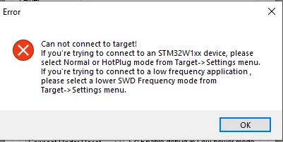

                   But, stLink utility sw responds with this; cannot connect to target.
Thanks
KMINH.1
KMINH.1Author
October 27, 2023
Is it possible to interface nucleo board with external st link, when it has inbuilt st link?
Anyone plz advice.
Also, I am trying to connect same thru st cube programmer.

@QSHAO.1  Is st cube programmer licensed?  Is it required to be purchased before usage?

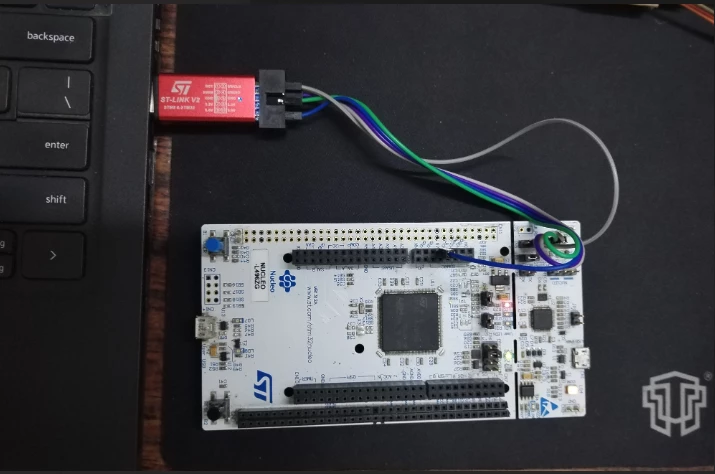

KMINH.1
KMINH.1Author
November 1, 2023
Thanks @MM..1  for quick answer.
The microcontroller side of the board looks ok. But, STLink part doesn't seem to get detected.
However, when I connect external StLink v2 clone, it doesn't get detected by st link utility sw.
Attaching image:
If this setup works at least, its enough for me to get started.
Can u check where it could go wrong?
Thanks
Pavel A.
November 1, 2023
Try another computer. And another USB cable.
