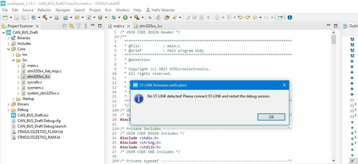

[BUG] ST-Link firmware verification - No ST-LINK detected message since 1.4.x update.
On Windows 10, I just updated (again) to the 1.4.2 version, hoping to solve this issue, yet nothing changed.
Already tried a clean install (again) and re-installed the latest STM32CubeProgrammer: nothing changed.
Will ST handle this sooner or later please? Or at least give some help in diagnosing the problem? Thanks

LaurentLBest answer
Aug 26, 2020 3:49 PM UTC
Yes of course, it will be included for next releases.
Edit after it was marked as best answer :
The libusb dll v1.0.23 is now installed with STM32cubeIde v1.5.0 installer.
So, no need to patch it, just install (not update) STM32CubeIde v1.5.0.
Rgds,
Laurent

Visitor II
Aug 5, 2023 1:25 PM UTC
I have installed latest version of STM32CubeIDE which is 1.13.1. I am facing the same problem of ST-Link not detected. I tried solving the issue following your guides but it's not being resolved. If you could please guide me how can I resolve this issue. I would be really grateful.
