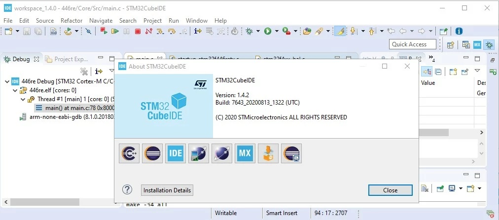

On Windows 10, I just updated (again) to the 1.4.2 version, hoping to solve this issue, yet nothing changed.
Already tried a clean install (again) and re-installed the latest STM32CubeProgrammer: nothing changed.
Will ST handle this sooner or later please? Or at least give some help in diagnosing the problem? Thanks

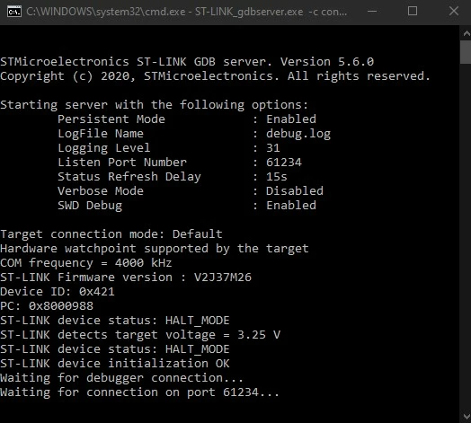

In console view start ST-LINK GDB server with parameters -d (swd mode) and -cp (folder location to CubeProgrammer) E.g.
C:\ST\STM32CubeIDE_1.4.0\STM32CubeIDE\plugins\com.st.stm32cube.ide.mcu.externaltools.stlink-gdb-server.win32_1.4.0.202007081208\tools\bin>ST-LINK_gdbserver.exe -d -f mylog.txt -cp C:\ST\STM32CubeIDE_1.4.0\STM32CubeIDE\plugins\com.st.stm32cube.ide.mcu.externaltools.cubeprogrammer.win32_1.4.0.202007081208\tools\bin
What does it log in console or into log file ?

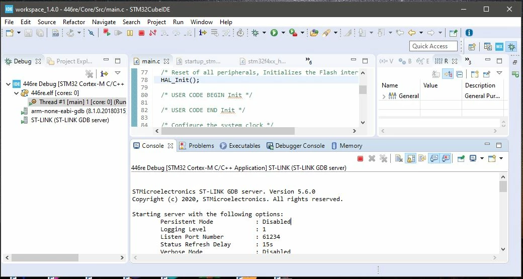

I just tried to start the ST-LINK GDB server manually from the console, following your instructions and the server seems to start actually! I attached the log file.
By the way, all the folder names on my setup are identical to the ones you posted, so I'm guessing my tools versions are correct right?

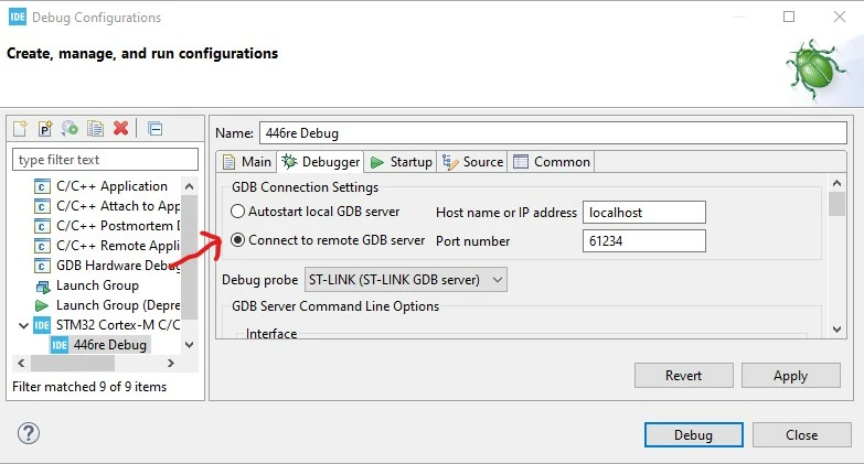

Having the ST-LINK GDB server started in the console, I tryed to change the debug configuration to "Connect to remote GDB server" instead of "Autostart local GDB server" and it worked (both selecting ST-LINK GDB and ST-LINK OpenOCD), so it seems the IDE can't start the server for some reason... Any clue how can I discover why?

  1. at the moment for make ver 1.4.x debug work, i siwtch debug configguration to remote gdbserver option0693W000002lA4oQAE.jpg

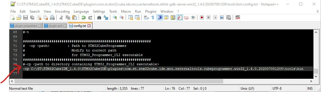

  2. modify config.txt in the folder "C:\ST\STM32CubeIDE_1.4.0\STM32CubeIDE\plugins\com.st.stm32cube.ide.mcu.externaltools.stlink-gdb-server.win32_1.4.0.202007081208\tools\bin" for correct path   for STM32_Programmer_CLI executable0693W000002lA61QAE.jpg

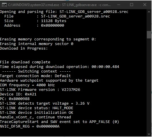

  3. Start ST-LINK_gdbserver.bat manually, it will launch win cmd prompt0693W000002lA6VQAU.jpg
  4. start debugging from stmcubeide and it's work0693W000002lA74QAE.jpg0693W000002lA6kQAE.jpg
