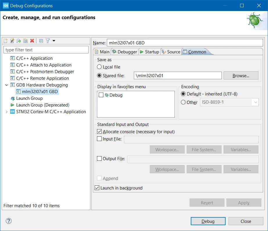

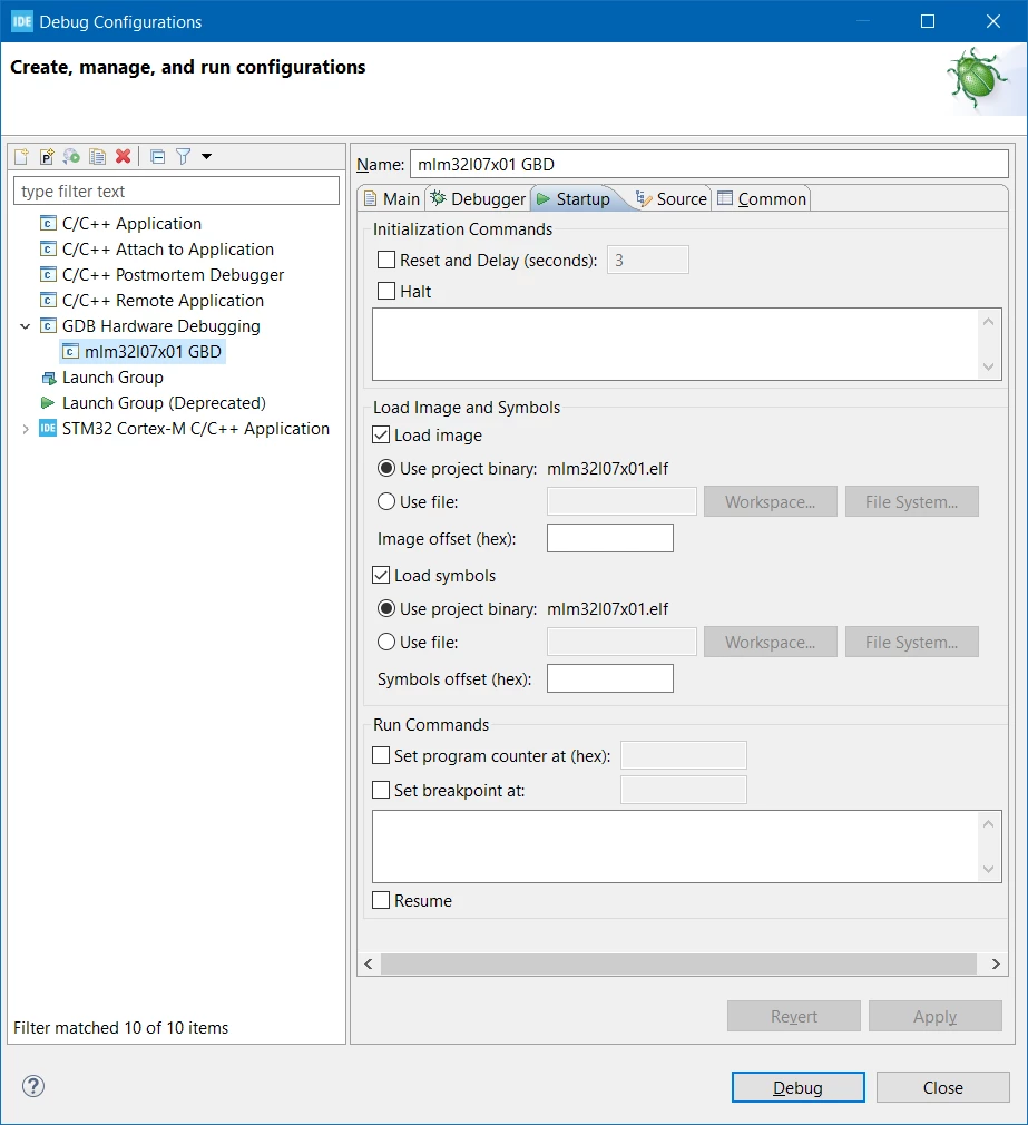

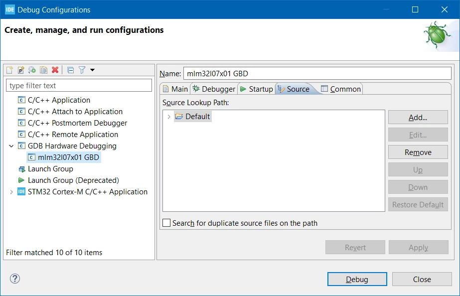

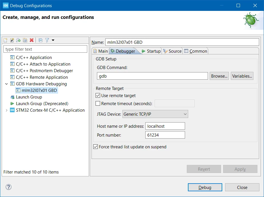

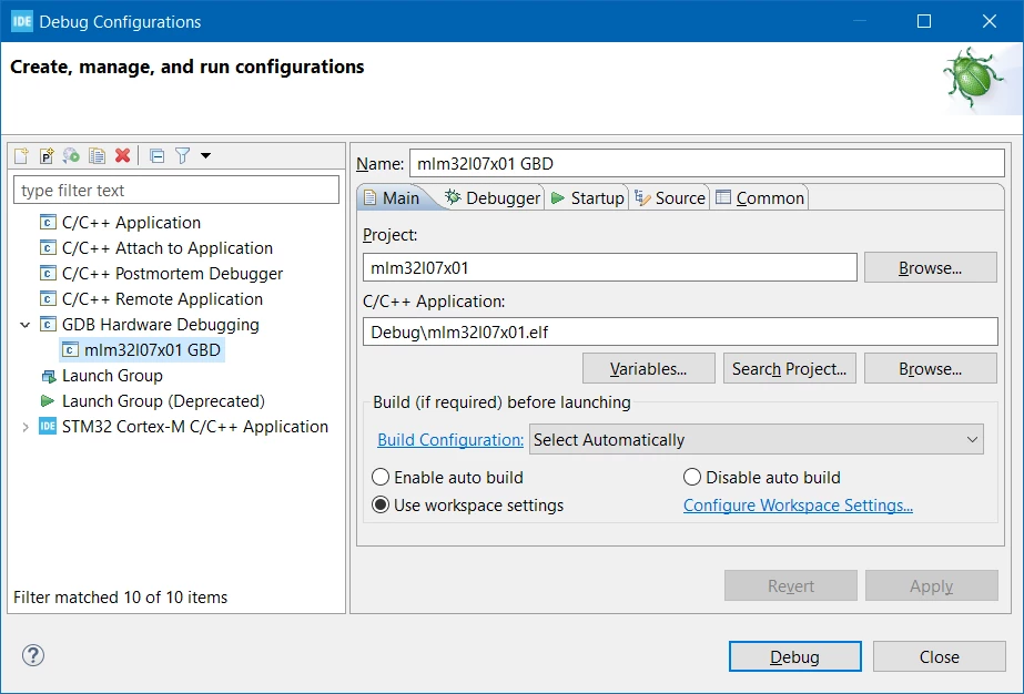

So far, I have defined a 'GDB Hardware Debugging' Configuration:

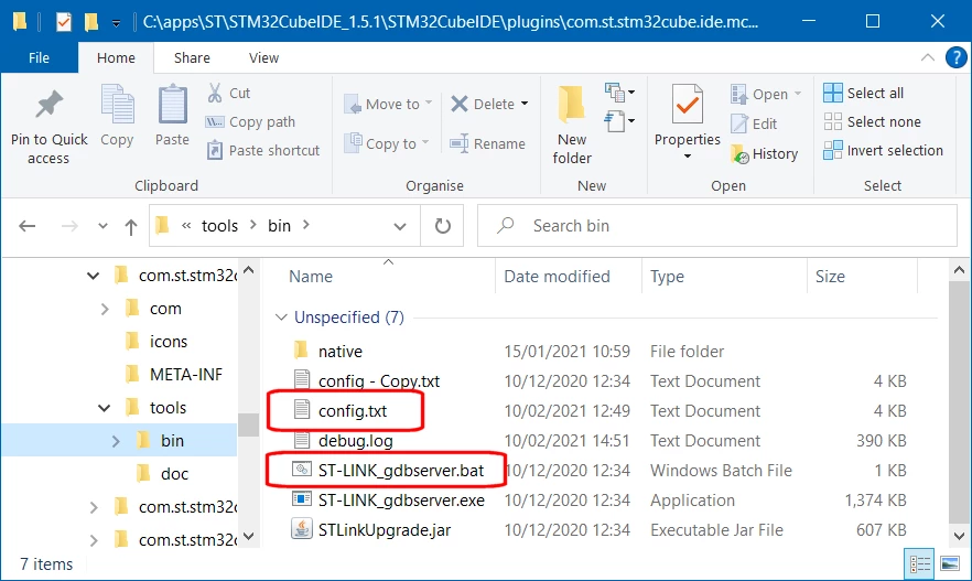

0693W000007EjfjQAC.png0693W000007EjghQAC.png0693W000007EjhzQAC.png0693W000007EjiTQAS.png0693W000007EjixQAC.pngYou need to manually start the GDB Server before launching the Debug:
0693W000007Ejm6QAC.pngSTM32CubeIDE_1.5.1\STM32CubeIDE\plugins\com.st.stm32cube.ide.mcu.externaltools.stlink-gdb-server.win32_1.5.0.202011040924\tools\bin
The 'config.txt' needs to be edited to specify the path to the STM32_Programmer_CLI executable - see comments in the file
then run the .bat file

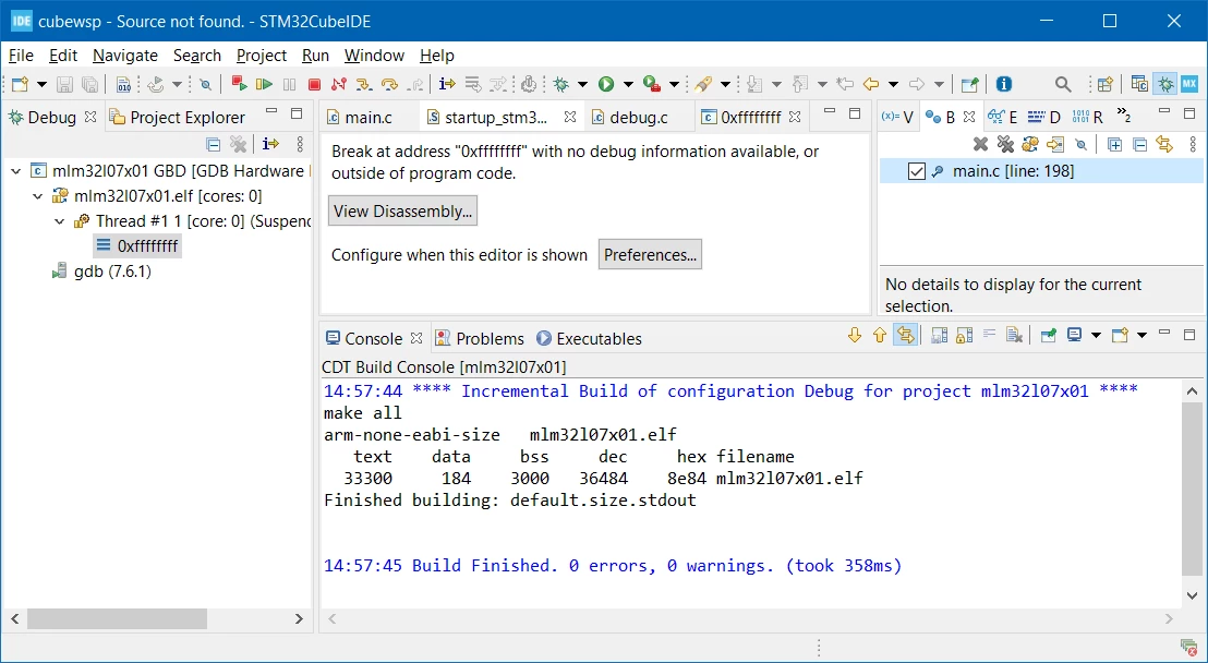

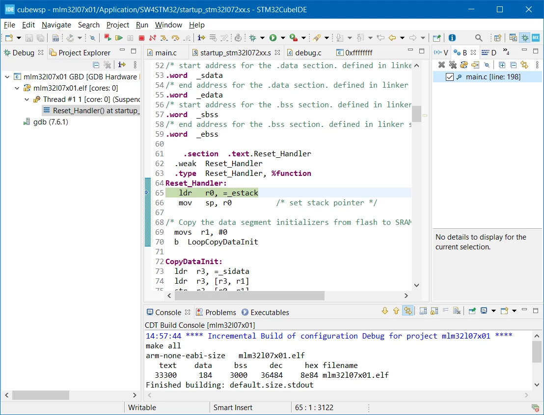

When I start a debug session, I see:
0693W000007EjqNQAS.png'Resume' goes to:
0693W000007EjrLQAS.pngand there it seems to be stuck.
