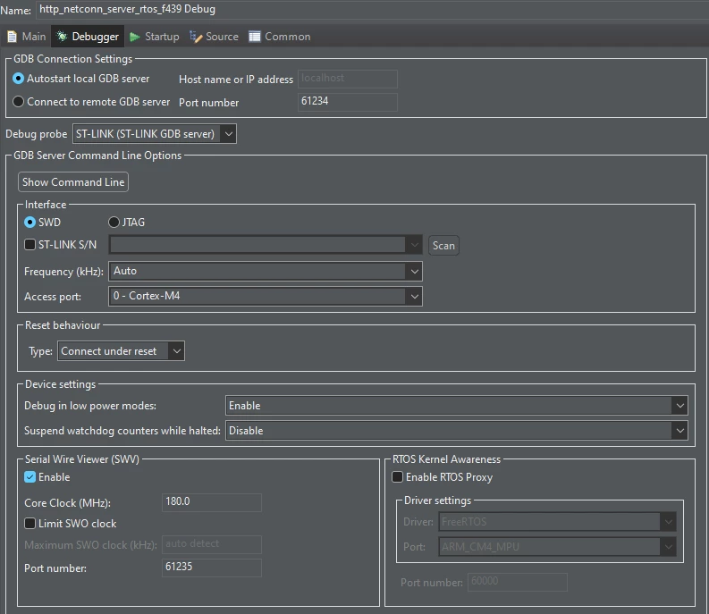

  1. Go to [Run] -> [Debug Configurations].
  2. Select your debug configuration and go to the [Debugger] tab.
  3. Tick the [Enable] box underneath [Serial Wire View (SWW)].
  4. Set the clock speed to match the clock speed used in your application.
  5. Click [Apply] and [Debug].

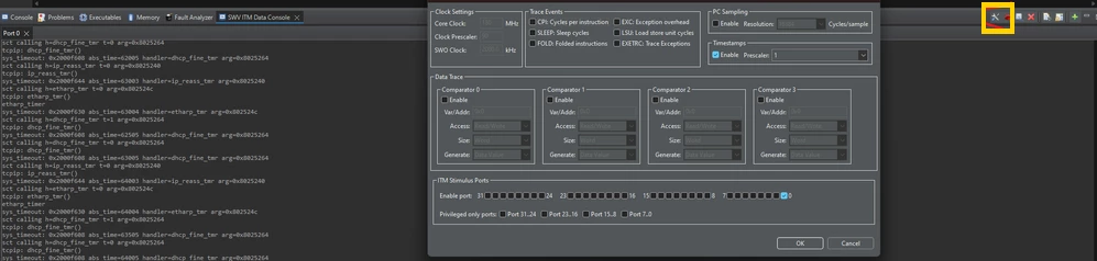

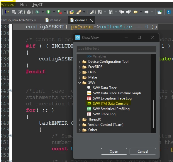

6. After the debug section is opened, open the SWV ITM Data Console by accessing [Window] -> [Show View] -> [Other] -> [SWV] -> [SWV ITM Data].
7. Check the configuration as seen in the image below, and start the process by clicking the red dot on the top-right corner.

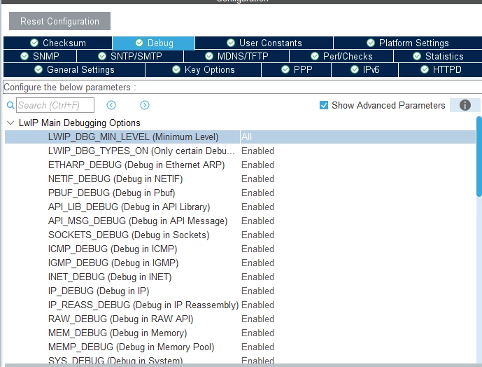

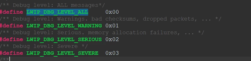

You can select one of the elements that you want to see it is debug message, and you can select which level of debug you want to visualize:
The element of the LWIP stack from which you want to get returns can be selected in the STM32CubeMX debug menu config of LWIP:

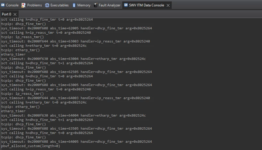

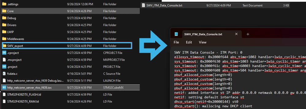

After this, you can see debug messages of the LWIP stack in your ITM console.
You can also extract them from the SWV export folder in your project for further investigation and analysis if needed.

Enabled SWV in debug configuration and also enbaled port 0 in SWV ITM Dat console settings.
