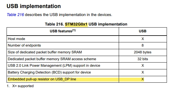

A lot of good ideas above but the newer ST micros don't require the 1.5K ohm external resistor because they have a built in Pull Up implementation, check your micro's reference manual.
I am using the STM32G0B1RET and I was having a similar issue.

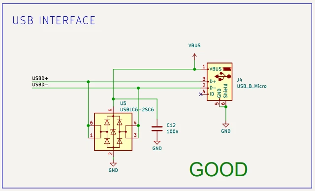

What really solved my issue was the article below that pointed me in the right direction, bottom line is CubeMX is not generating a complete code for the CDC handling, specially enabling the interrupts, It had the clock initialization correctly setup by it but I had to implement the interrupt handling.
https://community.st.com/t5/stm32cubemx-mcus/usb-stm32g0b1kct6-not-working/td-p/75116
I will share my USB schematic with you, I guarantee you this works after fixing the interrupt handler!
My USB lines connect directly to pins PA11 (USBD-) and PA12 (USBD+)
I hope this helps you!
