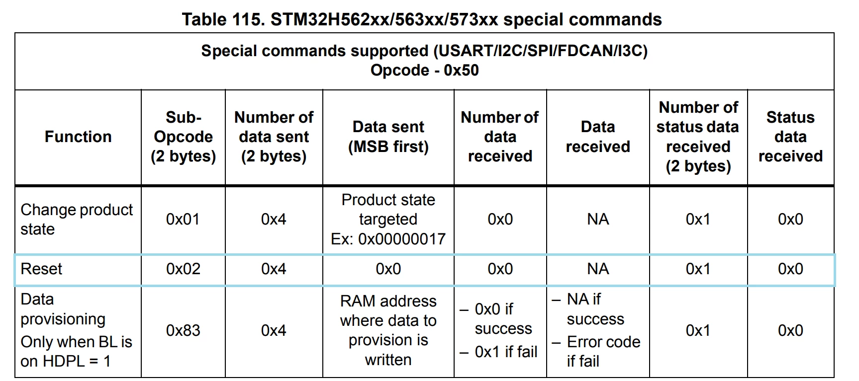

Some secure option bytes are not accessible by the bootloader as it is nonsecure. Some APIs are added on the SFSP to ensure that the bootloader can modify them in open products states. Refer to AN2606 Table 115. STM32H562xx/563xx/573xx special commands for more information.

3.2. Modify boot OB then execute the rest command from the bootloader
Users can write their firmware in the user flash and then change the boot from system memory to user flash. Do so by changing the option bytes and then perform a reset using the reset command available in the bootloader (special command).
