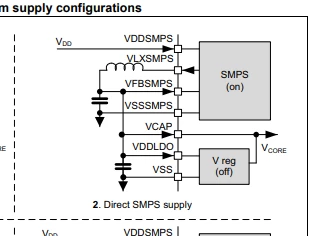

Below is a diagram from a reference manual showing different hardware configurations for the power supply.
The MCU contains a protection mechanism that prevents setting higher voltage from internal SMPS to VCORE (1.8 or 2.5 V). This should prevent damaging the MCU due to misconfiguration.

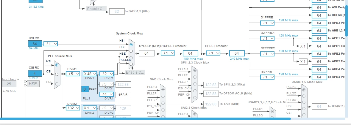

And this is my code now after erase
void SystemClock_Config(void)
/** Supply configuration update enable
HAL_PWREx_ConfigSupply(PWR_DIRECT_SMPS_SUPPLY);
__HAL_PWR_VOLTAGESCALING_CONFIG(PWR_REGULATOR_VOLTAGE_SCALE1);
while(!__HAL_PWR_GET_FLAG(PWR_FLAG_VOSRDY)) {}
/* Enable HSE Oscillator and activate PLL with HSE as source */
RCC_OscInitStruct.OscillatorType = RCC_OSCILLATORTYPE_HSI;
RCC_OscInitStruct.HSIState = RCC_HSI_DIV1;
RCC_OscInitStruct.PLL.PLLSource = RCC_PLLSOURCE_HSI;
RCC_OscInitStruct.PLL.PLLM = 4;
RCC_OscInitStruct.PLL.PLLN = 10;
RCC_OscInitStruct.PLL.PLLP = 2;
RCC_OscInitStruct.PLL.PLLQ = 128;
RCC_OscInitStruct.PLL.PLLR = 2;
RCC_OscInitStruct.PLL.PLLRGE = RCC_PLL1VCIRANGE_3;
RCC_OscInitStruct.PLL.PLLVCOSEL = RCC_PLL1VCOMEDIUM;
RCC_OscInitStruct.PLL.PLLFRACN = 0;
Error_Handler();
|RCC_CLOCKTYPE_PCLK1|RCC_CLOCKTYPE_PCLK2
|RCC_CLOCKTYPE_D3PCLK1|RCC_CLOCKTYPE_D1PCLK1;
RCC_ClkInitStruct.SYSCLKSource = RCC_SYSCLKSOURCE_HSI;
RCC_ClkInitStruct.SYSCLKDivider = RCC_SYSCLK_DIV1;
RCC_ClkInitStruct.AHBCLKDivider = RCC_HCLK_DIV1;
RCC_ClkInitStruct.APB3CLKDivider = RCC_APB3_DIV1;
RCC_ClkInitStruct.APB1CLKDivider = RCC_APB1_DIV2;
RCC_ClkInitStruct.APB2CLKDivider = RCC_APB2_DIV1;
RCC_ClkInitStruct.APB4CLKDivider = RCC_APB4_DIV1;
if (HAL_RCC_ClockConfig(&RCC_ClkInitStruct, FLASH_LATENCY_1) != HAL_OK)
Error_Handler();

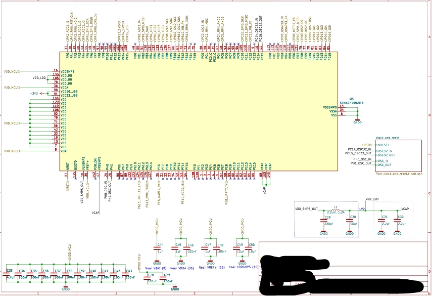

this is my customized board board schematic

Hello @kavyamm ,
from the first log of the CubePogrammer, it looks like the programming went ok and the error appears after. Maybe this could be related to power supply configuration during startup of the firmware. In latest CubeFW/CubeMX, this is done as well in the system_stm32h7xx.c (or similar) startup file in function ExitRun0Mode. This is based on global macro definition, but it might be possible that this is not correctly generate by CubeMX.
Regarding the schematic, the BOOT0 pin needs to be connected somewhere. Leaving it floating will lead to non-deterministic behavior, since HW can detect 0 or 1 at random during startup. However, I doubt this is the root cause, since entering bootloader shouldn't affect the debug capability.
In the power supply I don't see any major issues. I think the C31/C32 should be 100nF in SMPS configuration. In any case, I would recommend checking AN4938: https://www.st.com/resource/en/application_note/an4938-getting-started-with-stm32h74xig-and-stm32h75xig-mcu-hardware-development-stmicroelectronics.pdf
Maybe it would be best to create support ticket at ST support: https://ols.st.com/s/

Adam BERLINGER
Jan 21, 2026 9:11 AM UTC
Hello @kavyamm ,
did you check the power supply configuration during startup?
Also, would it be possible to share the connection to debug connector? If you don't want to share schematic on public forum, you can create OLS ticket here: https://ols.st.com/s/.
The log from STM32CubeProgrammer reports 2.79V while it should be 3V, so maybe there is some issue with VDD or GND connection to ST-Link.
