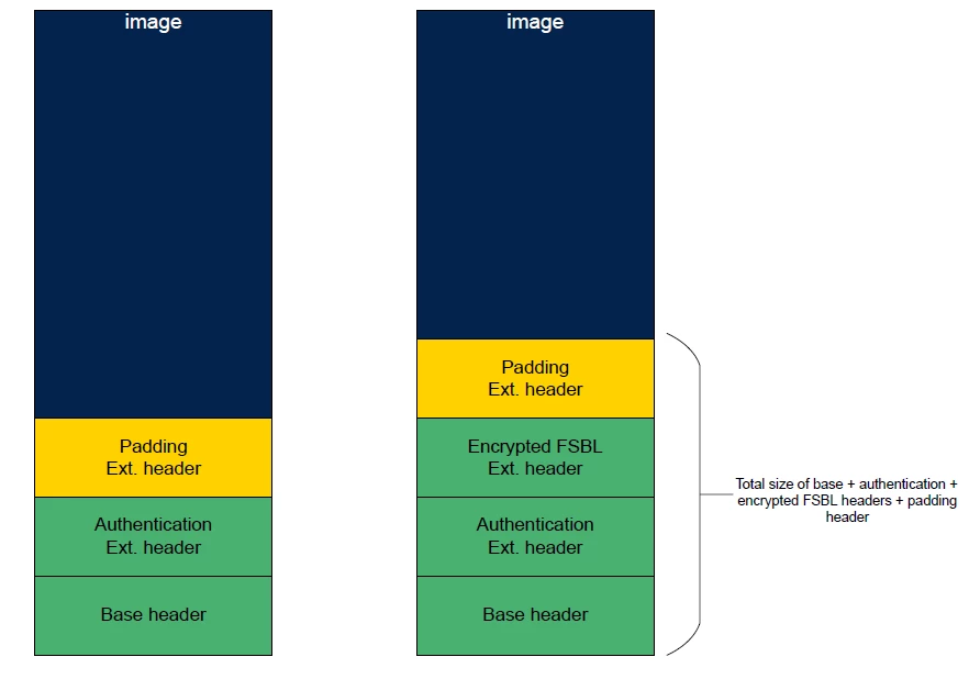

The FSBL layout includes several key components: the image header, base header, authentication process, and padding. These elements work together to ensure the integrity and authenticity of the boot process. The outlook is described by this image:
1.1 Image header
The image header contains metadata about the FSBL, such as its size, version, and entry point. This information is used by the boot ROM to load and execute the FSBL correctly.
1.2 Base header
The base header provides additional configuration details, including memory addresses and security settings. It ensures that the FSBL is loaded into the correct memory location and that any necessary security measures are applied.
1.3 Authentication process
The authentication process verifies the integrity and authenticity of the FSBL. This is typically done using cryptographic techniques, such as digital signatures, to ensure that the FSBL has not been tampered with.
1.4 Padding
Padding is used to align the FSBL image to specific memory boundaries. This ensures that the FSBL is loaded correctly and can be executed without any issues.

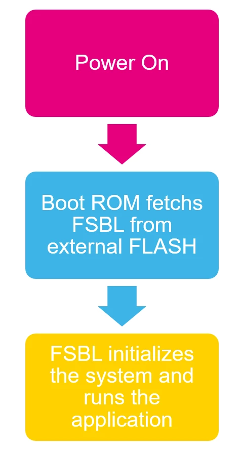

This is the simplified diagram on the usual steps:

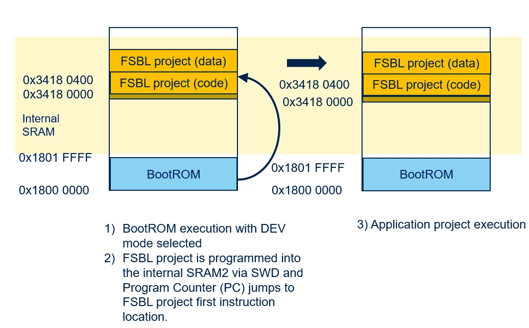

When in DEV mode and with some linker script adjustments, the programmer can load the FSBL code directly into the SRAM memory. It facilitates the debug process, as it skips the need to program the external memory.

The overview is quite simple. Once the program loads the code, the boot ROM jumps to the internal RAM address From there, the FSBL code acts as shown below:

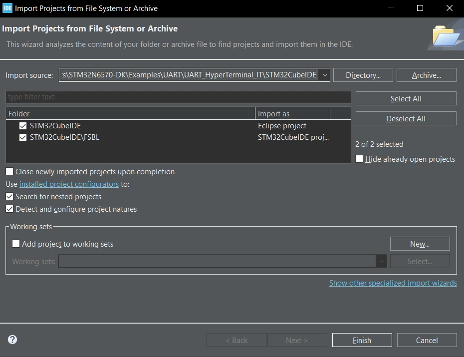

To get started, open STM32CubeIDE and import the example available in this folder C:\Users\%username%\STM32Cube\Repository\STM32Cube_FW_N6_V1.0.0\Projects\STM32N6570-DK\Examples\UART\UART_HyperTerminal_IT/STM32CubeIDE

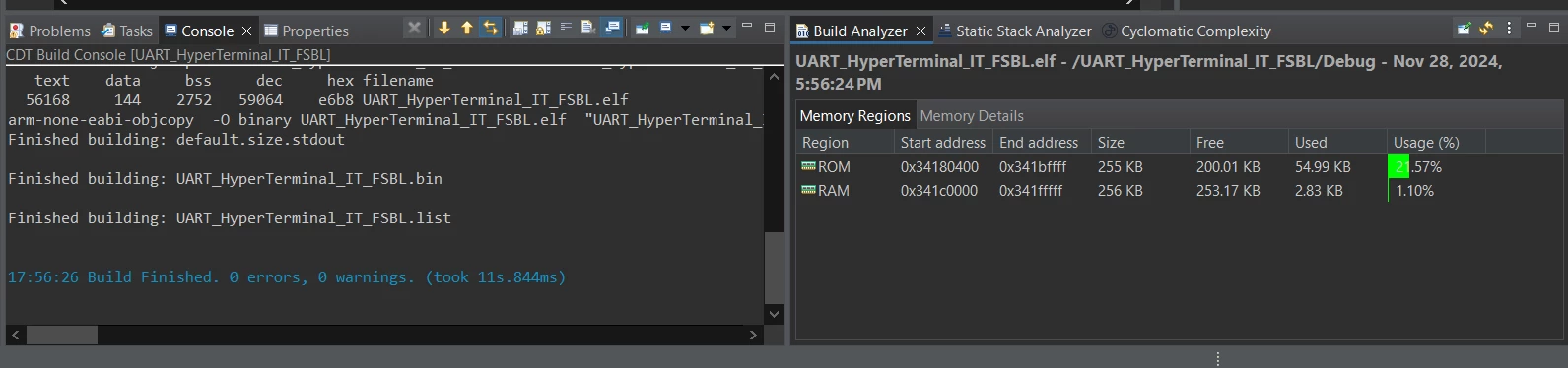

Once imported, it is worth noting that the linker script of the demo already is prepared to have the FSBL positioned in the AXSRAM2 region. It divides the 511 KB region into ROM (255 KB) and RAM (256 KB). From this point, just build the project and you are ready to debug and see it execute.

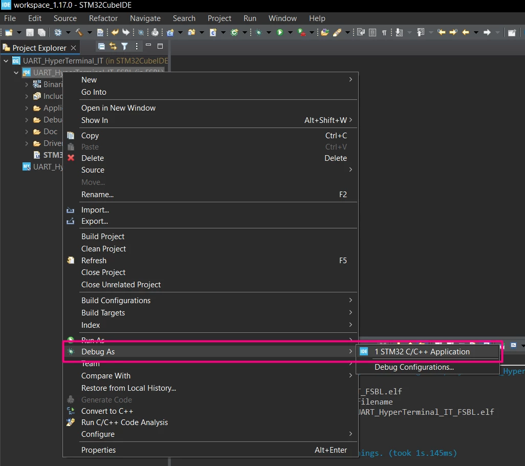

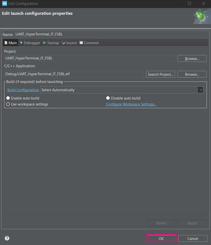

Press the NRST button to reset the device and ensure it is in DEV boot mode. Then select [Debug As] [STM32 C/C++ Application]. Keep the debugger with the default settings, and click [OK] in the launch configuration to load the firmware

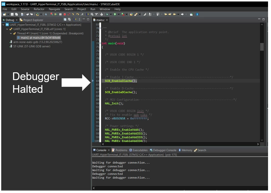

After establishing ST-LINK GDB server connection and programming, the internal SRAM2 STM32CubeIDE switches to the debugger perspective and halts the debugger at the beginning of the main() function.

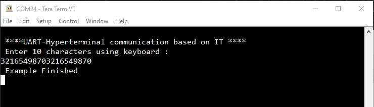

Before executing the code, make sure you have your preferred terminal these settings: 115200/7/Odd/1Stop/No Flow control. From this point, resume the firmware execution and type your 10 characters. LD1 stops blinking and is turns on statically once completed.
