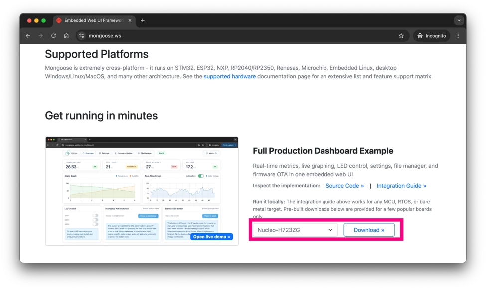

To get started quickly, use a preconfigured project from the Full Production Dashboard Example download section:
Otherwise, follow the steps below.

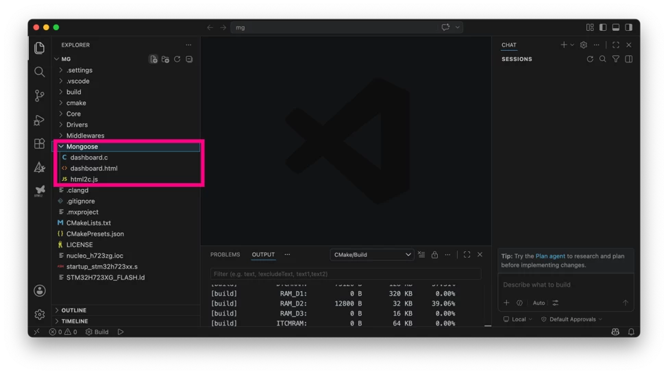

Create Mongoose top-level directory in your project. Then copy the following three files to that directory:
“html2c.js” is a Node.js script that generates “file_data.c” with the following command: “node html2c.js dashboard.html -o file_data.c”. This script first inlines all external resources into an amalgamated HTML file so that it does not depend on external content. It then compresses the file and packs it into a Mongoose-embedded file system. This approach minimizes flash usage.
For this step, Node.js must be installed on the system. Install it from https://nodejs.org/en/download. Verify the installation by opening a shell or command prompt and running “node --version”.

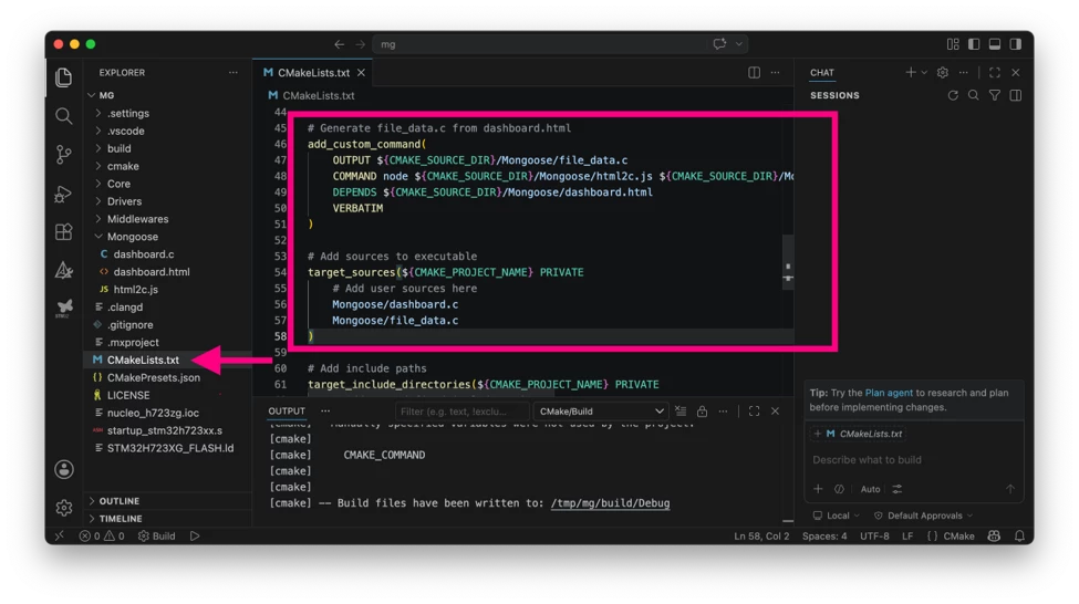

In the top level “CMakeLists.txt” file, add two extra source files to the build, and add the rule that generates “file_data.c” from “dashboard.html”. This step requires that Node.js is installed:
# Generate file_data.c from dashboard.html
add_custom_command(
OUTPUT ${CMAKE_SOURCE_DIR}/Mongoose/file_data.c
COMMAND node ${CMAKE_SOURCE_DIR}/Mongoose/html2c.js ${CMAKE_SOURCE_DIR}/Mongoose/dashboard.html -o ${CMAKE_SOURCE_DIR}/Mongoose/file_data.c
DEPENDS ${CMAKE_SOURCE_DIR}/Mongoose/dashboard.html
VERBATIM
# Add sources to executable
target_sources(${CMAKE_PROJECT_NAME} PRIVATE
# Add user sources here
Mongoose/dashboard.c

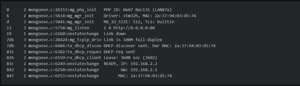

Run the serial console. Rebuild and reflash the board. On the serial console, you should see something like this:

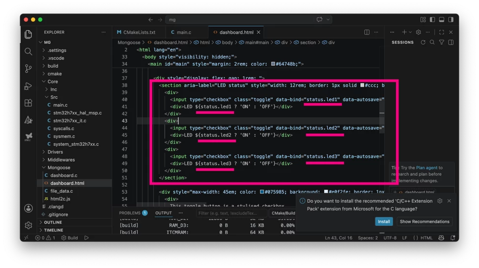

Open Mongoose/dashboard.html and modify the Dashboard.init() call to include led2 and led3:
Dashboard.init({
debug: true,
data: { status: { led1: false, led2: false, led3: false, version: '1.0.0' } },
Add two more toggle buttons and bind them to led2 and led3:
<section aria-label="LED status" style="width: 12rem; border: 1px solid #ccc; border-radius: .5rem; padding: 1rem; ">
<div>
<input type="checkbox" class="toggle" data-bind="status.led1" data-autosave="1" aria-label="Toggle LED" />
<div>LED ${status.led1 ? 'ON' : 'OFF'}</div>
</div>
<div>
<input type="checkbox" class="toggle" data-bind="status.led2" data-autosave="1" aria-label="Toggle LED" />
<div>LED ${status.led2 ? 'ON' : 'OFF'}</div>
</div>
<div>
<input type="checkbox" class="toggle" data-bind="status.led3" data-autosave="1" aria-label="Toggle LED" />
<div>LED ${status.led3 ? 'ON' : 'OFF'}</div>
</div>
</section>
Notice that the HTML uses data-bind attributes that reference values from the Dashboard.init() call. This is how we bind each control to a device variable.
Also notice the ${...} expression in the HTML code. It is replaced with the result of evaluating the expression, which can be any valid JS expression that uses device state variables. ${...} expressions can appear anywhere: in text or in element attributes. This makes it possible to style elements conditionally, for example by adding a red background when device variable values exceed a threshold.
For more details, see the dashboard.js reference. Styling and conditional display will be covered in the next articles. For now, let's move on.

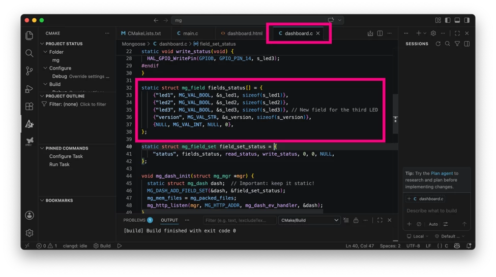

Open Mongoose/dashboard.c and add s_led2 and s_led3 boolean variables that are used to communicate LED state to the dashboard:
static bool s_led1, s_led2, s_led3;
Then modify the read_status() and write_status() functions:
static void read_status(void) {
  MG_INFO(("READING STATUS"));
  mg_snprintf(s_version, sizeof(s_version), "1.2.3");
  // These conditionals make this file work on both microcontroller and desktop
  // Useful for developing the UI on desktop, and copying to an MCU project.
#if MG_ARCH == MG_ARCH_CUBE
s_led1 = HAL_GPIO_ReadPin(GPIOB, GPIO_PIN_0);
s_led2 = HAL_GPIO_ReadPin(GPIOE, GPIO_PIN_1);
s_led3 = HAL_GPIO_ReadPin(GPIOB, GPIO_PIN_14);
#endif
static void write_status(void) {
MG_INFO(("WRITING STATUS"));
HAL_GPIO_WritePin(GPIOB, GPIO_PIN_0, s_led1);
HAL_GPIO_WritePin(GPIOE, GPIO_PIN_1, s_led2);
HAL_GPIO_WritePin(GPIOB, GPIO_PIN_14, s_led3);
#endif
Add "led2" and "led3" to the field-set descriptor:
static struct mg_field fields_status[] = {
{"led1", MG_VAL_BOOL, &s_led1, sizeof(s_led1)},
{"led2", MG_VAL_BOOL, &s_led2, sizeof(s_led2)},
{"led3", MG_VAL_BOOL, &s_led3, sizeof(s_led3)},
{"version", MG_VAL_STR, &s_version, sizeof(s_version)},
{NULL, MG_VAL_INT, NULL, 0},
See the Dashboard C API reference for a more detailed explanation of fields and field sets.

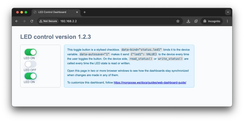

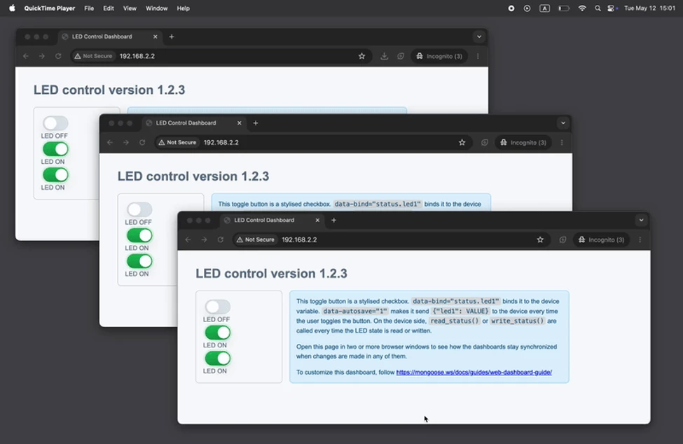

Rebuild and reflash the board. Refresh the dashboard in your browser. If should now show three toggle buttons, and toggling them should toggle the corresponding LED:

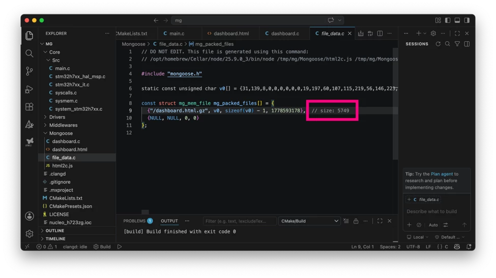

Open Mongoose/file_data.c to check how much space the UI uses, it should be around 5KB:

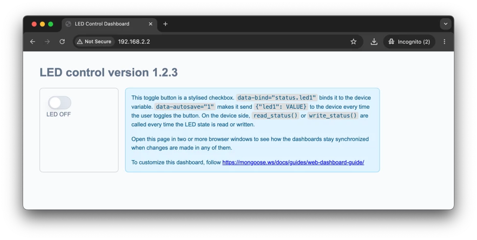

Open the dashboard in another browser, and toggle LEDs in one browser window. The dashboards remain synchronized because each dashboard keeps a real-time WebSocket connection to the device. As a result, the dashboard does not show stale data:
