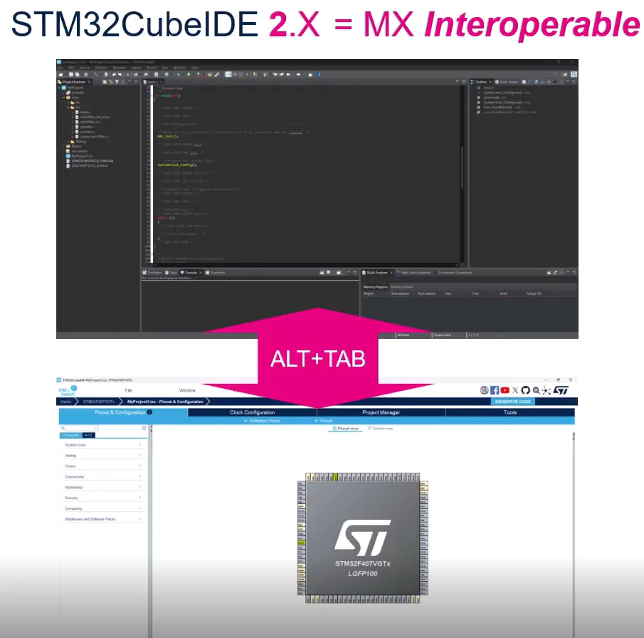

STM32CubeIDE 2.0.0 is a major release. In this version, STM32CubeMX is removed from STM32CubeIDE. STM32CubeIDE and STM32CubeMX are now two separate products. This changes the workflow, which we describe and explain in this article. Click here if you would like to watch a video tutorial describing the new workflow.
1. Background

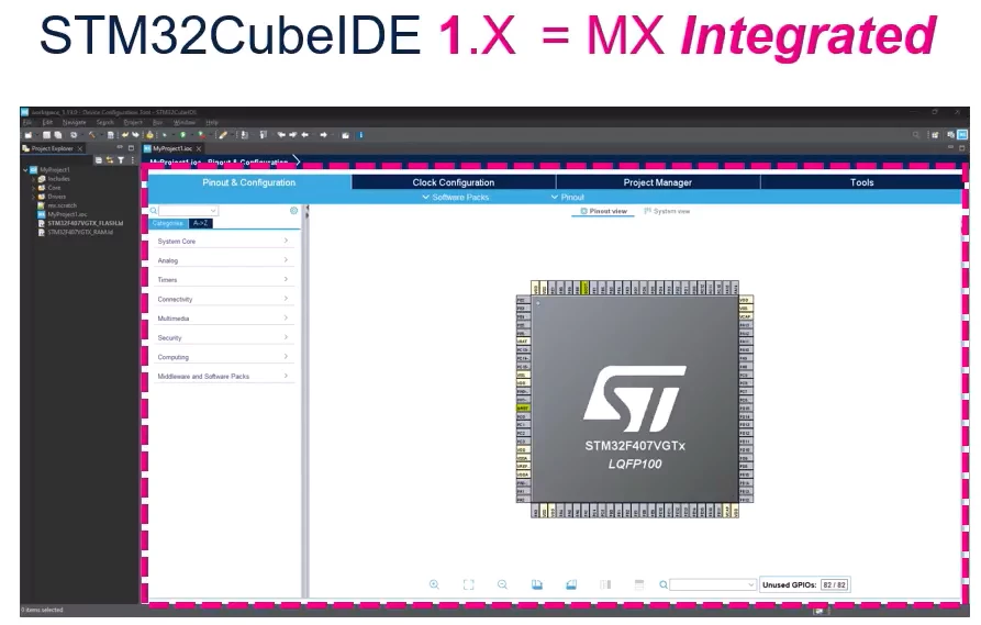

In STM32CubeIDE1.x, STM32CubeMX was integrated into STM32CubeIDE:
In STM32CubeIDE 2.x, the STM32CubeMX was removed from STM32CubeIDE
2. New workflow with STM32CubeIDE
The new workflow consists in starting your project from STM32CubeMX, generating a project for STM32CubeIDE and then importing it in STM32CubeIDE.
The steps are described and explained in detail below.

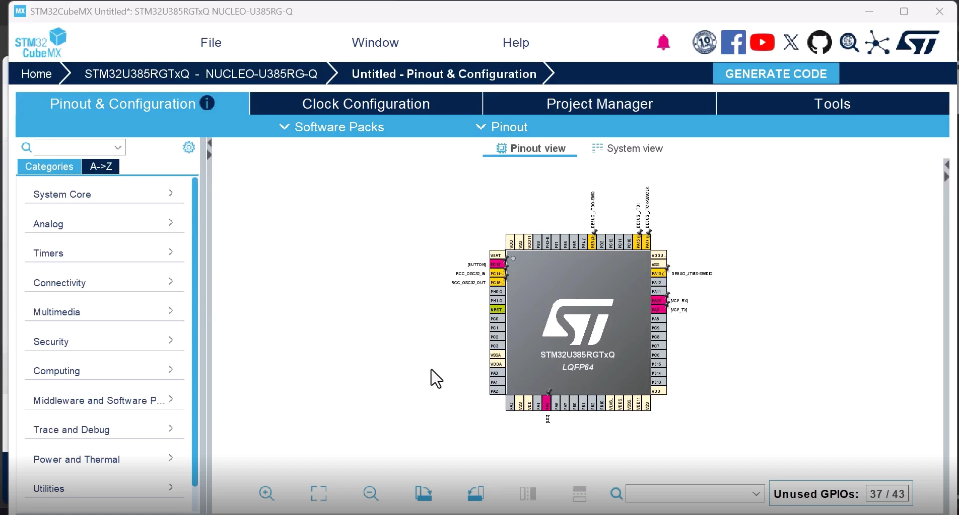

2.1 Create your project using STM32CubeMX
In the example below I have created a STM32CubeMX for a STM32U385 with a demonstration code.
Once your project is completed (Pinout & Configuration and Clock Configuration fully configured), we go to the "Project Manager" tab to set up the project for STM32CubeIDE.

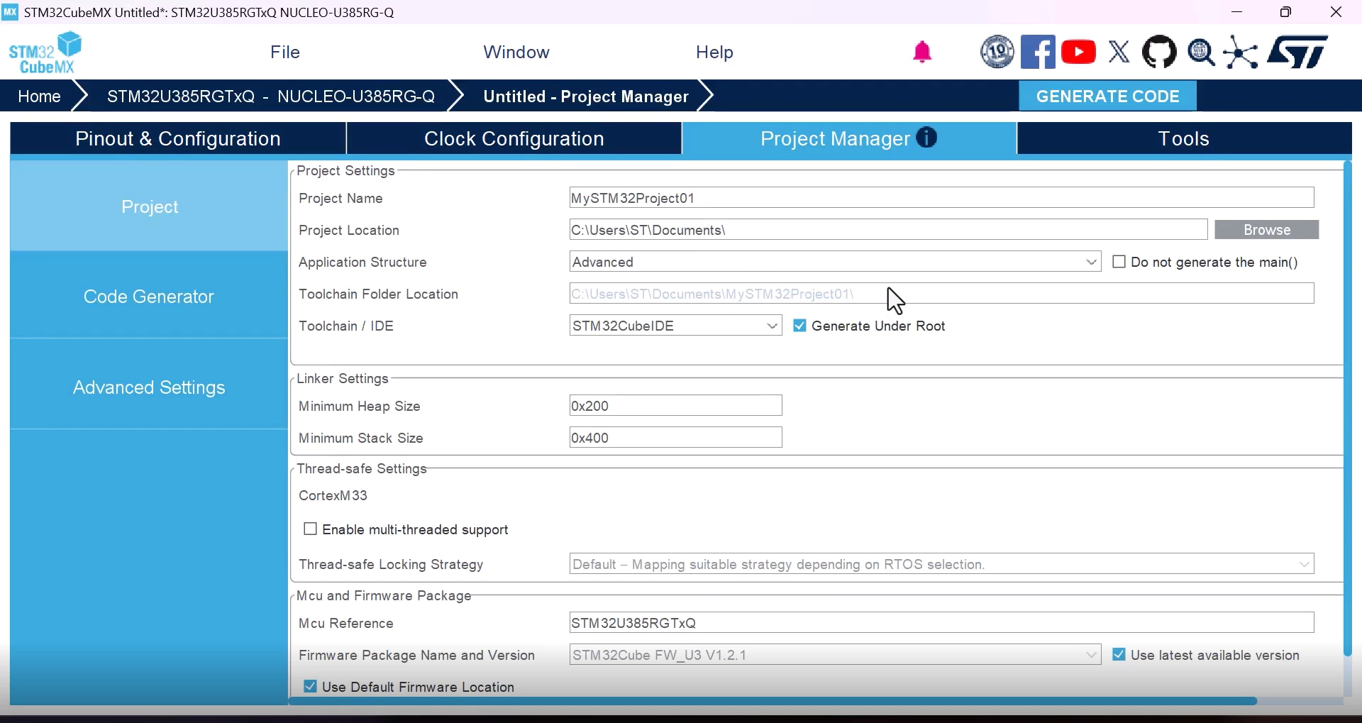

2.2 Set up the project for STM32CubeIDE
Go to "Project Manager" tab and input the following:
  • "Project Name:" give your project a name
  • "Project Location:" give the path where you want the project to be generated
  • "Toolchain:" select STM32CubeIDE
2.3 Generate the project
Click on the [GENERATE CODE] icon
Waiting for the project to be generated, you should see the following window once the project has been created successfully.
You can now close the window (click [Close]).

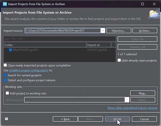

2.4 Import the project in STM32CubeIDE
Switch to STM32CubeIDE 2.x and import the project we just created with STM32CubeMX.

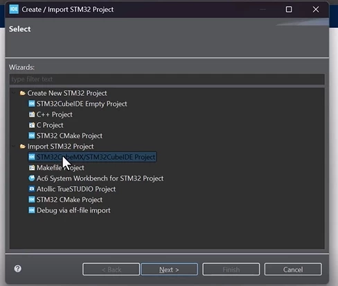

Click on [File] → [STM32 Project Create/Import]
A window opens, select [STM32CubeMX/STM32CubeIDE Project] under “Import STM32 Project” and then click [Next] as seen below.
A new window pops up and you give the path of the project you previously created and then click [Finish].
The project is now imported.

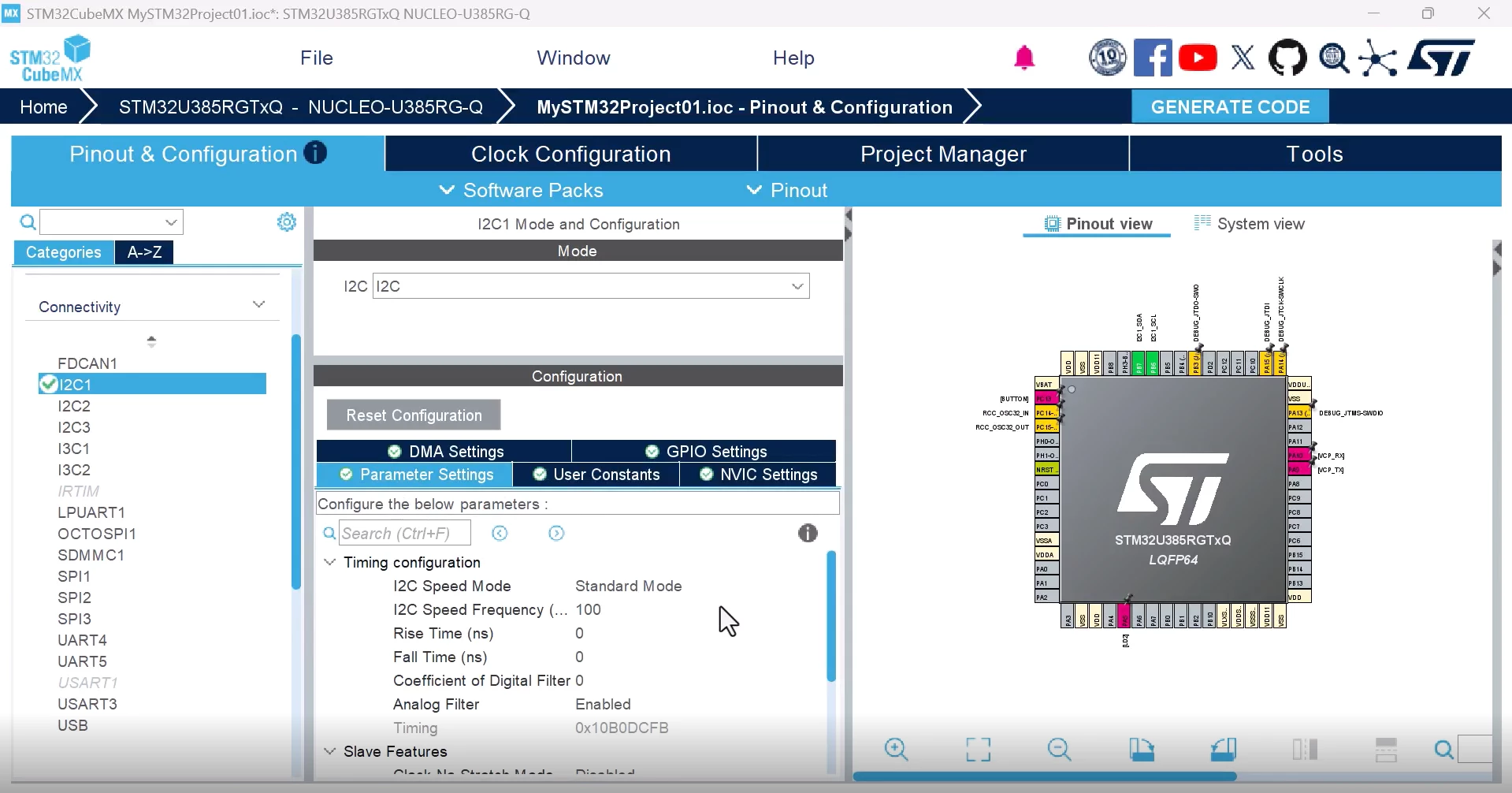

2.5 Project modification in STM32CubeMX
Now, let's say that we want to modify our existing project in STM32CubeMX.
Go back to STM32CubeMX, and do the modifications you want to do.

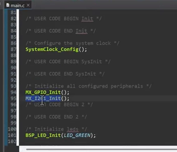

For example, let’s say that we want to add a peripheral to our application (in my example, I am enabling I2C1):
Then, generate the code again by clicking [GENERATE CODE].
Note: [GENERATE CODE] will save your project
Once the code is generated, go back to STM32CubeIDE.

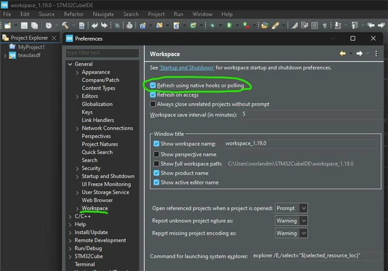

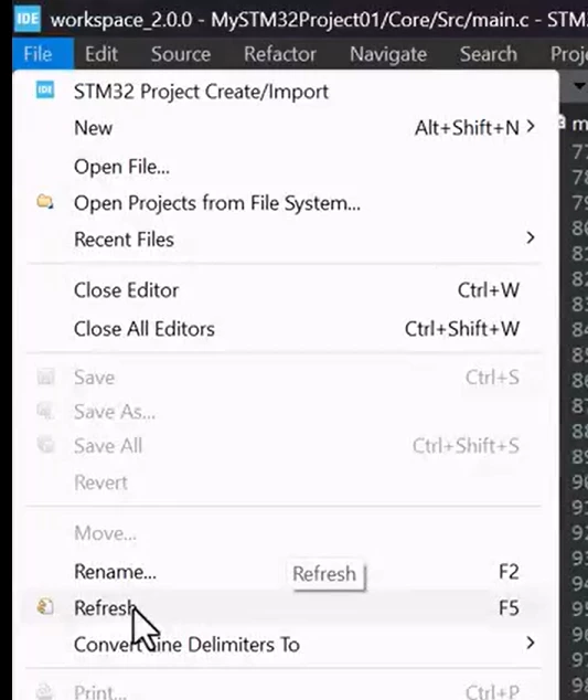

To reflect the changes made in the project, you need to “refresh” the project by doing the following:
Click on [File] → [Refresh] or press [F5].
Note: We also wanted to highlight the "auto-refresh" of the STM32CubeIDE file tree:
This is an Eclipse native feature which checks all projects inside the workspace for changes and update the file tree accordingly.
Now your project has been updated to STM32CubeIDE.  In my case, for example, I can see the configuration of the I2C1 I just did in STM32CubeMX.

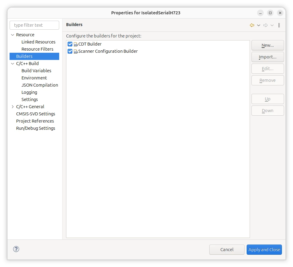

I am missing something here... For the first time in ages I tried to create a STM32 project from scratch using this new workflow but I just can't get it to give me a project thats buildable out of the box.
If I look at the Project Properties, under the "Builders" item, there are no builders configured for the project.
In my projects generated under the old integrated method, a project would list the following builders....
for which I could do a Build All to generate a firmware file.
How do I get the new workflow to generate me a buildable project that will result in an STM32 executable I can run on an STM32 board? (I have no idea what "project natures" means).

I believe the build issue is due to a hidden file called ".project" being generated by CubeIDE. When following your workflow, there appears to be two ".project" files generated, one sat in a subfolder called "STM32CudeIDE" (that file generated by CubeMX appears to contain all the required settings), and a second ".project" file sat in a parent folder generated by CubeIDE - the contents of this latter file is minimal compared to the other one.
If I delete the minimal ".project" file and clear out my workspace and reload the project it then works as intended.
I just repeated the workflow to replicate the problem I am having....
CubeMX generates the following hidden files...
".mxproject", and a subfolder "STM32CubeIDE" containing hidden files ".cproject", ".project" -- all these appear to be valid contents.
Then running CubeIDE (starting with an empty workspace)... following the described workflow exactly, I browse to the folder containing the MX projects .ioc file.... and click "Finish"...
As a result CubeIDE has now generated a new hidden file ".project" located in the same folder as ".mxproject". However this ".project" file is almost empty...
<?xml version="1.0" encoding="UTF-8"?>
<projectDescription>
<name>test2</name>
<comment></comment>
<projects>
</projects>
<buildSpec>
</buildSpec>
<natures>
</natures>
</projectDescription>
As a result there are no builder defined for the imported project.
If I delete this bare ".project" file, clean out my workspace and do my normal "Open Projects from File System..." to reimport the project, it all then works fine.
