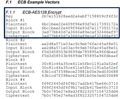

For demonstration purposes we use a AES ECB (Electronic Codebook) example vector from the National Institute of Standards and Technology: NIST special publication 800-38a.
Figure 1: AES ECB NIST Example Vector

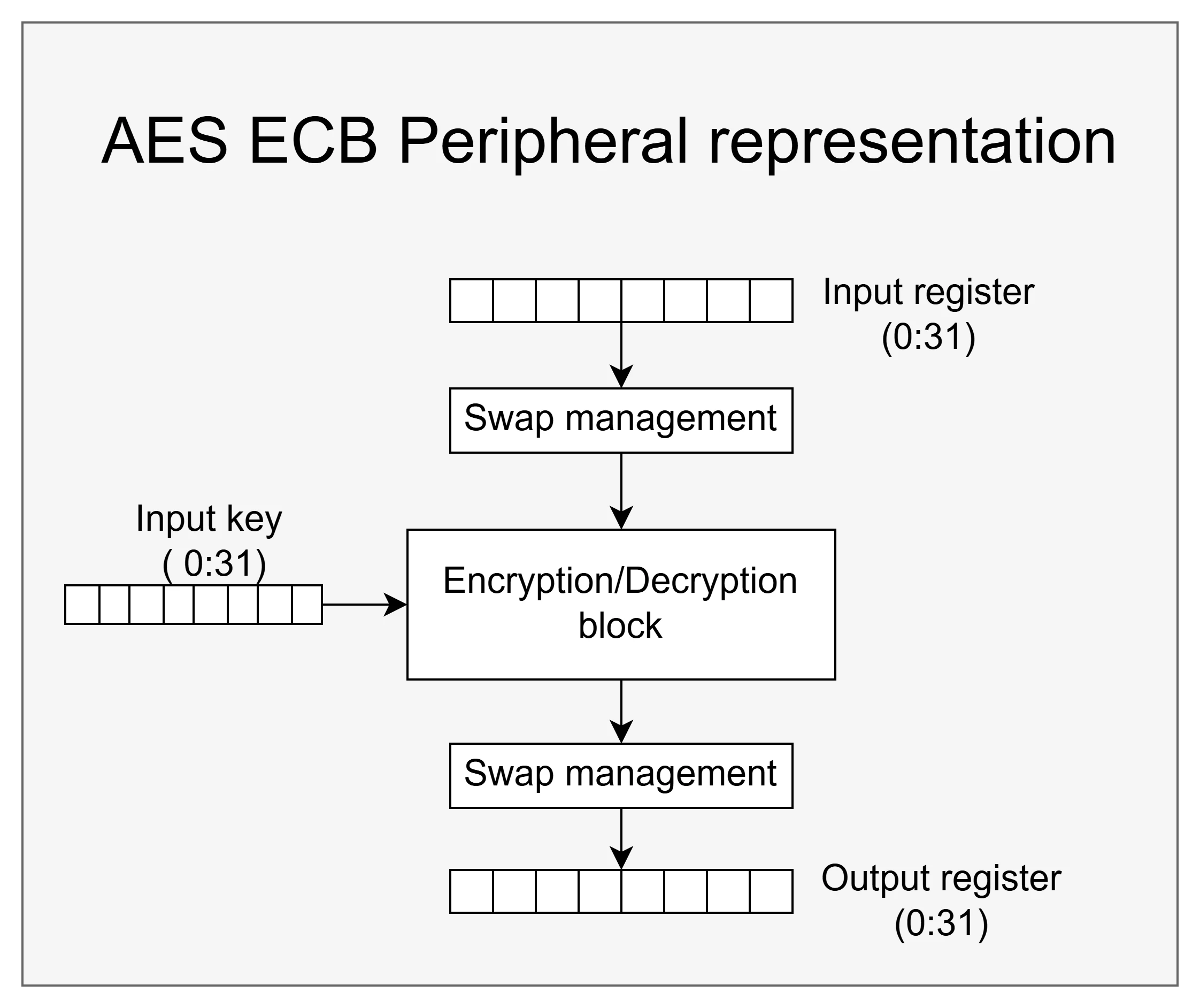

The image below is a representation of the AES ECB peripheral overview:
Figure 2: AES ECB peripheral representation.Figure 2: AES ECB peripheral representation.
AES processes 128-bit (16 bytes) blocks of plaintext, but on STM32 the data is transferred through 32-bit register accesses. That means the way data is stored in memory, and the way it is read by the CPU and written to the peripheral, matters.
AES itself is not “big endian” or “little endian”. The issue is not the algorithm. The issue is purely about how the peripheral interface packs bytes into its 32-bit registers.

This is the sample test vector:
 6b c1 be e2 2e 40 9f 96 e9 3d 7e 11 73 93 17 2a

5. Fixing the Issue with the Swap Mechanism
As Figure 2 AES ECB peripheral representation illustrates, the AES peripheral incorporates a mechanism for swapping, controlled via special control bits located in the control register.
The swap mechanism can perform:
  • NO SWAP
  • Half-word SWAP
  • Byte SWAP
  • Bit SWAP
In HAL, this is controlled by the DataType field in CRYP_HandleTypeDef.

8. Expected result
For this NIST AES-128 ECB test vector, the expected ciphertext is:
3a d7 7b b4 0d 7a 36 60 a8 9e ca f3 24 66 ef 97
