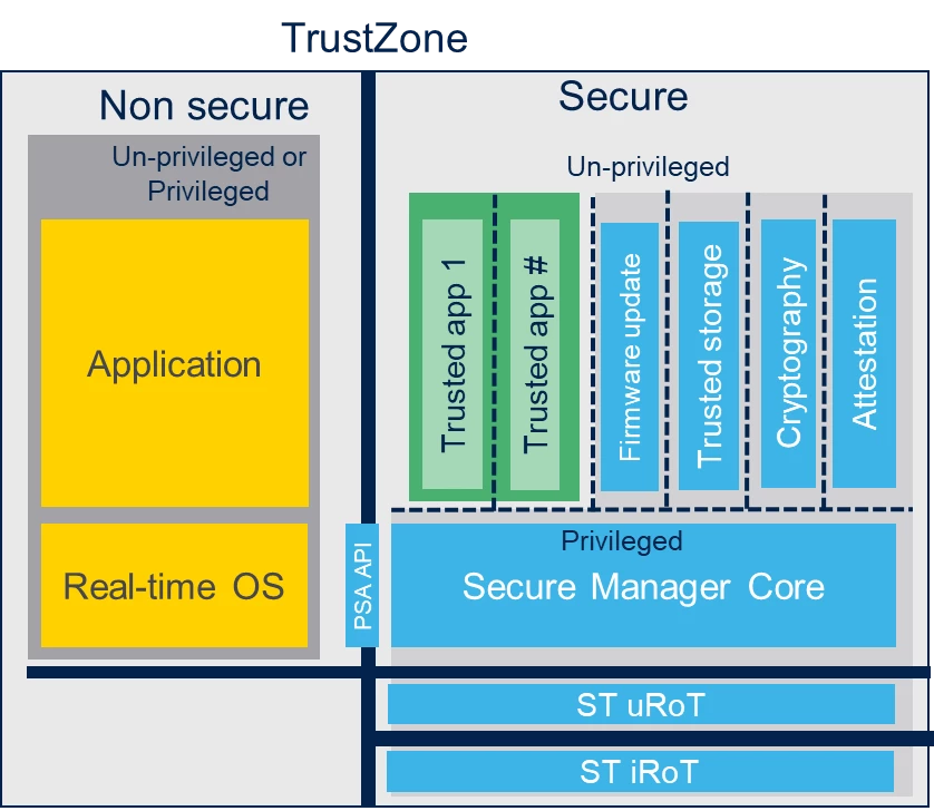

Furthermore, Secure Manager is running in an isolated partition of the device, using the TrustZone(C) from Arm architecture. See the following architecture description
In this architecture, developers do not need to write any code on security aspects, everything is covered by the framework. This includes a pre-configured TrustZone.
Let's see how Secure Manager helps you to solve your previous requirements:
  • Security by design - dedicated security service design for high security, maintained and corrected by ST in case of malicious vulnerabilities
  • Strong Root of Trust - 2-stage Root of Trust, one immutable, one updatable to allow application verification of authenticity, integrity and confidentiality
  • Security update - PSA API compliant solution, to securely & independently update your application and the secure modules (or secure apps) as well as the root of trust itself.
