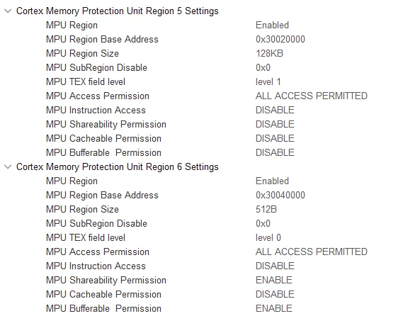

4.1.1 Importance of MPU Configuration for RTOS and LwIP
The memory protection unit (MPU) enforces memory access permissions, preventing accidental corruption and improving system stability. For RTOS-based systems running TouchGFX and LwIP, MPU configuration ensures safe concurrent access to shared resources.
4.1.2 Configuring descriptor locations
A key requirement for a functional LwIP application is well-configured memory. This includes a dedicated section to store transmit and receive DMA descriptors, sufficient space for Rx buffers, and a dedicated heap memory. LwIP memory sections must not overlap with other memory areas to avoid unexpected behavior.
Since a preexisting TouchGFX application is being used, opening the Cortex®-M7 configuration for the MPU reveals that TouchGFXDesigner has already loaded the necessary configurations for the graphics application, including proper permissions and memory sections.
The LwIP heap is allocated in SRAM2, leveraging its 128 KB size to provide sufficient memory for dynamic allocation of new pbufs, TCP/UDP control blocks, and other protocol data structures. The DMA descriptors are placed at the beginning of SRAM3, occupying 256 bytes each, with attributes set to noncacheable to prevent data corruption, shareable between the CPU and DMA, and bufferable.
This configuration is specific to the STM32H750B-DK and must be adjusted when using another microcontroller, as some may have smaller SRAM sizes. When working with graphics applications or designing a custom PCB, consider these factors to select the appropriate product. This step can be skipped when using a Cortex®-M4 core.

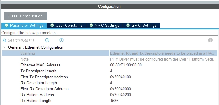

4.1.3 Ethernet configuration
In the ETH tab under the Connectivity category, enable the Ethernet peripheral and set it to the mode supported by your board. For this example, set it to MII. Adjust the parameters as follows:
  • First Rx Descriptor Address: 0x30040000
  • First Tx Descriptor Address: 0x30040100
  • Rx/Tx Descriptor Length: Number of descriptors, set to 4
  • Rx Buffers Length: Size of the frame
  • Rx Buffers Address: 0x30040200, which represents the base address of the receive pool where incoming frames will be stored. This memory region must be noncacheable to prevent frame corruption.

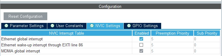

Since this application uses RTOS, we need to enable the Ethernet global interrupt to ensure that complete reception and transmission events are detected, allowing the appropriate callback functions to be executed.
Verify that the assigned pins are correctly mapped and set the maximum output speed to Very High.

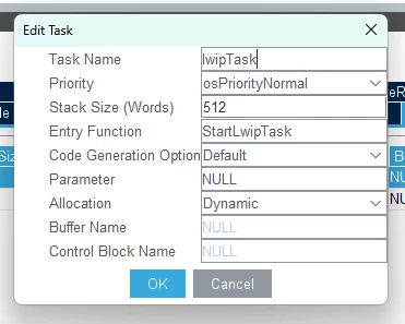

4.1.4 FreeRTOS™ configuration
For LwIP to function properly, a thread is required for initialization. TouchGFX already has a preconfigured thread, so the focus is on the default thread. Increase its stack size to 512 words, which is sufficient to handle LwIP’s requirements, as a smaller stack size can lead to memory corruption. Keep the priority at osPriorityNormal. Monitor FreeRTOS™ heap usage to understand how much memory your application requires and how much heap is still available, allowing you to optimize memory allocation for other needs.

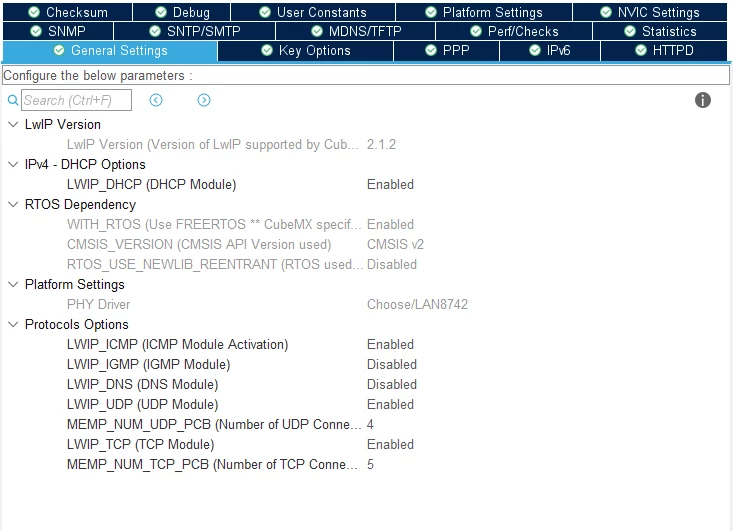

4.1.5 Configuring LwIP
Enable LwIP under the Middleware tab. In the general settings, choose whether to use a static IP address or DHCP, depending on whether a working DHCP server is available on your network.
In Key Options, set the base address and size of the heap memory section defined in the MPU configuration.

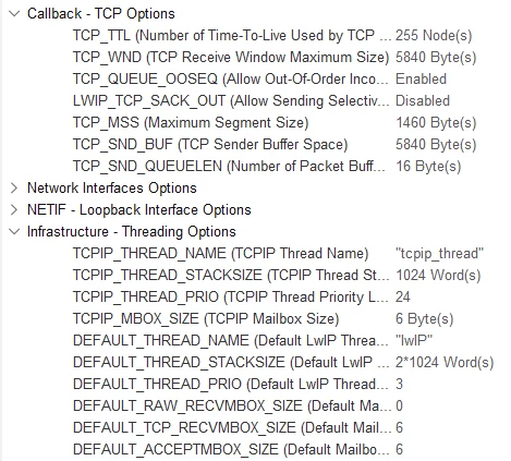

For better TCP/IP performance, adjust the following parameters based on Adam Berlinger's knowledge base article:
  • TCP_MSS: 1460 bytes
  • TCP_SND_BUF: 5840 bytes
  • TCP_WND: 5840 bytes
  • TCP_SND_QUEUELEN: 16
STackPointer64_7-1766486065527.pngAdditionally, double the size of DEFAULT_THREAD_STACK_SIZE to prevent application failure and hard faults.
Before proceeding, under Platform Settings, select the PHY driver used (in this case, the LAN8742) so the appropriate drivers are imported into the project folder.

  3. The Rx_PoolSection is placed in RAM_D1 instead of RAM_D2 regardless it is configured as you suggested in the xxx_FLASH.ld file.

// In main.c
osThreadId_t lwipTaskHandle;
const osThreadAttr_t lwipTask_attributes = {
 .name = "LwIPTask",
 .stack_size = 1000 * 4,
 .priority = (osPriority_t) osPriorityLow,
int main(void)
 /* Init scheduler */
 osKernelInitialize();
 /* Init LwIP */
 lwipTaskHandle = osThreadNew(StartLwipTask, NULL, &lwipTask_attributes);
void StartLwipTask(void *argument)
 /* init code for LWIP */
 MX_LWIP_Init();
 /* Initialize the TCP echo server thread */
 tcpecho_init();
 /* Initialize the UDP echo server thread */
 udpecho_init();
 /* Infinite loop */
 for(;;)
 /* Delete the Init Thread */
 osThreadTerminate(lwipTaskHandle);
 osDelay(1);
Is it correct?

/* Definitions for lwipTask */
 .name = "lwipTask",
 .stack_size = 512 * 4,
 .priority = (osPriority_t) osPriorityNormal,
 MX_LWIP_Init();
 /* USER CODE BEGIN 5 */
 tcpecho_init();
 udpecho_init();
 /* Infinite loop */
 for(;;)
 osDelay(1);
 /* USER CODE END 5 */
 /* MPU Configuration */
void MPU_Config(void)
 MPU_Region_InitTypeDef MPU_InitStruct = {0};
 /* Disables the MPU */
 HAL_MPU_Disable();
 /** Initializes and configures the Region and the memory to be protected
 MPU_InitStruct.Enable = MPU_REGION_ENABLE;
 MPU_InitStruct.Number = MPU_REGION_NUMBER0;
 MPU_InitStruct.BaseAddress = 0x24000000;
 MPU_InitStruct.Size = MPU_REGION_SIZE_512KB;
 MPU_InitStruct.SubRegionDisable = 0x0;
 MPU_InitStruct.TypeExtField = MPU_TEX_LEVEL0;
 MPU_InitStruct.AccessPermission = MPU_REGION_FULL_ACCESS;
 MPU_InitStruct.DisableExec = MPU_INSTRUCTION_ACCESS_DISABLE;
 MPU_InitStruct.IsShareable = MPU_ACCESS_NOT_SHAREABLE;
 MPU_InitStruct.IsCacheable = MPU_ACCESS_CACHEABLE;
 MPU_InitStruct.IsBufferable = MPU_ACCESS_BUFFERABLE;
 HAL_MPU_ConfigRegion(&MPU_InitStruct);
 MPU_InitStruct.Number = MPU_REGION_NUMBER1;
 MPU_InitStruct.BaseAddress = 0x90000000;
 MPU_InitStruct.Size = MPU_REGION_SIZE_256MB;
 MPU_InitStruct.AccessPermission = MPU_REGION_NO_ACCESS;
 MPU_InitStruct.IsCacheable = MPU_ACCESS_NOT_CACHEABLE;
 MPU_InitStruct.IsBufferable = MPU_ACCESS_NOT_BUFFERABLE;
 MPU_InitStruct.Number = MPU_REGION_NUMBER2;
 MPU_InitStruct.Size = MPU_REGION_SIZE_128MB;
 MPU_InitStruct.DisableExec = MPU_INSTRUCTION_ACCESS_ENABLE;
 MPU_InitStruct.Number = MPU_REGION_NUMBER3;
 MPU_InitStruct.BaseAddress = 0xD0000000;
 MPU_InitStruct.Number = MPU_REGION_NUMBER4;
 MPU_InitStruct.Size = MPU_REGION_SIZE_32MB;
 MPU_InitStruct.Number = MPU_REGION_NUMBER5;
 MPU_InitStruct.BaseAddress = 0x30020000;
 MPU_InitStruct.Size = MPU_REGION_SIZE_128KB;
 MPU_InitStruct.TypeExtField = MPU_TEX_LEVEL1;
 MPU_InitStruct.Number = MPU_REGION_NUMBER6;
 MPU_InitStruct.BaseAddress = 0x30040000;
 MPU_InitStruct.Size = MPU_REGION_SIZE_512B;
 MPU_InitStruct.IsShareable = MPU_ACCESS_SHAREABLE;
 /* Enables the MPU */
 HAL_MPU_Enable(MPU_PRIVILEGED_DEFAULT);

You are getting a white screen because the MPU is misconfigured. You have set Region number 5’s AccessPermission to MPU_REGION_NO_ACCESS instead of the "All Access Permitted" option mentioned in the guide.
MPU_InitStruct.AccessPermission = MPU_REGION_NO_ACCESS; /* <----- */
Best regards,

  1. Have you ensured that the netmask and IP address are configured correctly, and that your computer is on the same network as the board?
  2. It is not supposed to print anything to the terminal. To enable debug messages, you need to activate the correct UART instance mapped to the COM port and enable debug messages in lwIP.
  3. Have you verified the linker file configuration? Specifically, ensure the section names match those referenced in ethernetif.c.
  4. You don’t need an extra step to run the lwIP task; the task scheduler called by osKernelStart() runs the tasks created, the function call is automatically generated by MX when using FreeRTOS.
