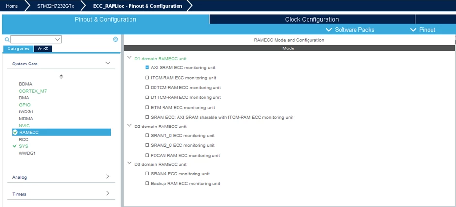

  • Create a new STM32H7 project using STM32CubeMX and enable the RAMECC monitoring of the memory you need to test.
  • In the .IOC file, go to [System Core] → [RAMECC]. Check the boxes next to each region of RAM you want to monitor. Here we’ll target the D1-AXI SRAM.

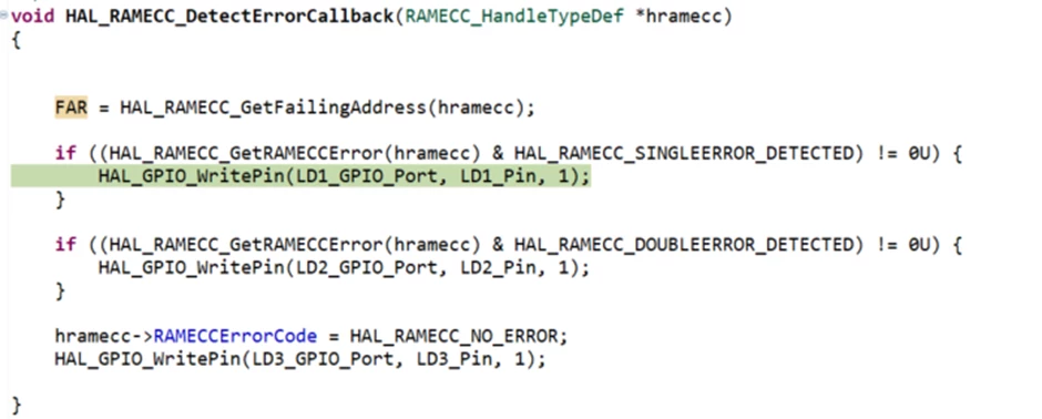

d. Add the following callback in main.c:
* @brief Single or double ECC error detected callback.
* hramecc : RAMECC handle
* @retval None
void HAL_RAMECC_DetectErrorCallback(RAMECC_HandleTypeDef *hramecc)
 FAR = HAL_RAMECC_GetFailingAddress(hramecc);
 if ((HAL_RAMECC_GetRAMECCError(hramecc) & HAL_RAMECC_SINGLEERROR_DETECTED) != 0U) {
 HAL_GPIO_WritePin(LD1_GPIO_Port, LD1_Pin, 1);
 if ((HAL_RAMECC_GetRAMECCError(hramecc) & HAL_RAMECC_DOUBLEERROR_DETECTED) != 0U) {
 HAL_GPIO_WritePin(LD2_GPIO_Port, LD2_Pin, 1);
 hramecc->RAMECCErrorCode = HAL_RAMECC_NO_ERROR;
 HAL_GPIO_WritePin(LD3_GPIO_Port, LD3_Pin, 1);

d. Run the test and set breakpoints into the callback to check if an ECC error occurred or not. You’ll be redirected to the callback function when ECC errors occurred as follows:
