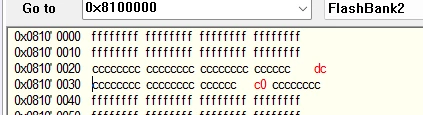

  1. Do you know why my data is changing from 0xCC t0 0xDC when I call the below function:
 if (HAL_FLASH_Program(FLASH_TYPEPROGRAM_FLASHWORD, DstAddr, ((uint32_t) SingleErrorA)) != HAL_OK)
   2.  Why would two consecutive programming operations trigger an ECC error ?
