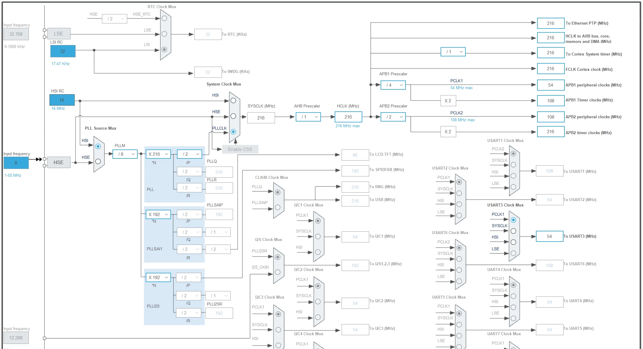

2.1 Clock configuration
  1. Access the RCC (reset and clock control) settings:
    • In the "Pinout & Configuration" tab, locate and select the RCC peripheral from the left-hand panel.
  2. Set HSE to bypass mode:
    • This mode is typically used when an external oscillator (for example, a clock signal from the ST-LINK debugger) is driving the HSE input.
    • Under the RCC settings, configure the High-Speed External Clock (HSE) to [Bypass Mode].
  3. Navigate to the "Clock Configuration" tab:
    • Switch to the Clock Configuration tab to configure the clock tree.
  4. Set the core to maximum frequency:
    • Adjust the settings in the clock tree to achieve the maximum frequency for the STM32F767 core, which is 216 MHz.

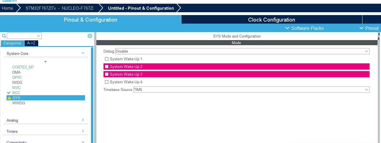

In STM32CubeMX, it is recommended to configure a different timebase than SysTick when using FreeRTOS™ to avoid potential conflicts. To do this, navigate to the "Pinout & Configuration" tab and select the SYS peripheral. In the Timebase Source dropdown menu, choose a timer other than SysTick. TIM6 is a suitable option because it is a simple timer with no additional complexity, making it ideal for this purpose.

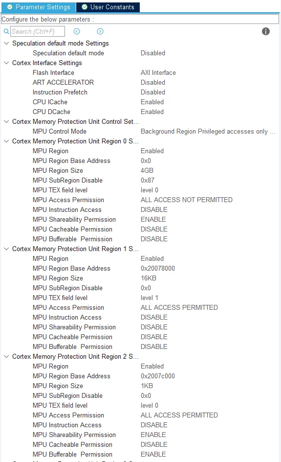

2.2  Cortex®-M7 configuration
To optimize performance and ensure memory protection, enable [Instruction Cache (ICACHE)] and [Data Cache (DCACHE)] in STM32CubeMX. Navigate to the "Cortex-M7" settings under the "System Core" section. Enable the Memory Protection Unit (MPU) and set it to [Background Region Privileged access only + MPU Disabled during hard fault] mode. Configure the MPU regions as shown in the provided image.
For example, set "Region 0" with a base address of 0x0, 4GB size, and access permissions as ALL ACCESS NOT PERMITTED. Similarly, configure Region 1 and Region 2 with their respective base addresses, sizes, and access permissions. These settings ensure efficient memory management and protection for your application.

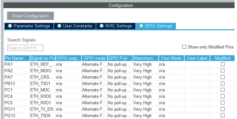

2.3 Ethernet configuration

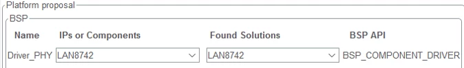

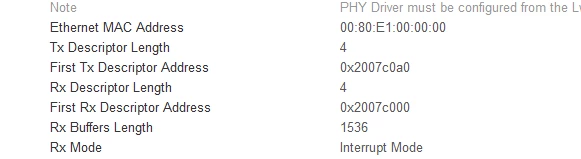

To configure Ethernet for the Nucleo-F767 board in STM32CubeMX, enable the Ethernet peripheral in the "Pinout & Configuration" tab. Set it to [RMII mode], as this is the mode supported on the board. Next, enable the [Ethernet interrupt] and set its preemption priority to [5], which is required by FreeRTOS™ to ensure that its functions can be called from the interrupt handler. Additionally, configure the speed of the Ethernet-related GPIO pins to [Very High] to support the high-speed data transfer required for Ethernet communication.

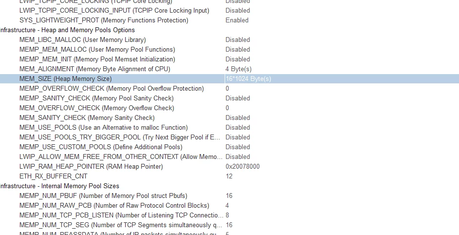

In the "Key options" tab, make the following adjustments:
  • Set MEM_SIZE to 16*1024 to define the heap size. This heap will later be relocated to D2 SRAM.
  • Enable LWIP_NETIF_LINK_CALLBACK to detect Ethernet cable plugging and unplugging events.
  • Configure the LWIP_RAM_HEAP_POINTER to point to the appropriate memory address in D2 SRAM which in our case 0x20078000.
These configurations ensure that the LwIP stack is properly set up for Ethernet communication and optimized memory usage.

3.1 Modifying the linker script (not valid for Keil/IAR)
This step can be skipped for Keil® and IAR, as these IDEs support placing variables at specific addresses directly in the C code. You need to make the following adjustments to STM32F767ZITX_FLASH.ld as shown below.
MEMORY
 RAM (xrw) : ORIGIN = 0x20000000, LENGTH = 512K
 FLASH (rx) : ORIGIN = 0x8000000, LENGTH = 2048K
 Memory_B1(xrw) : ORIGIN = 0x2007C000, LENGTH = 0xA0
 Memory_B2(xrw) : ORIGIN = 0x2007C0A0, LENGTH = 0xA0
 .RxDecripSection (NOLOAD) : { *(.RxDecripSection) } >Memory_B1
 .TxDescripSection (NOLOAD) : { *(.TxDecripSection) } >Memory_B2

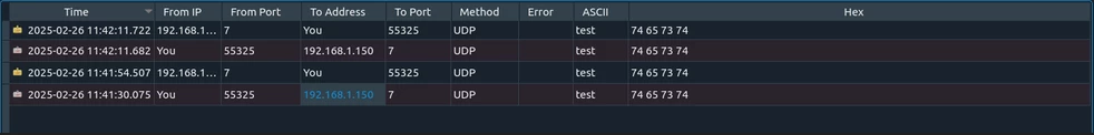

Compile the code. Using an application or utility like Packet Sender, you can test whether the server is successfully receiving UDP test messages. The board can obtain its IP address in two ways: either dynamically from a DHCP server running on the testing computer or network using, for example, Tftpd32, or through a statically defined IP address. In this example, we format a UDP packet to send to port 7 using the IP address, whether it is assigned by the DHCP server or manually configured.
After this, you should see that the response echoed back by the UDP server running on the board, confirming that the server is functioning correctly and everything is working as intended.
