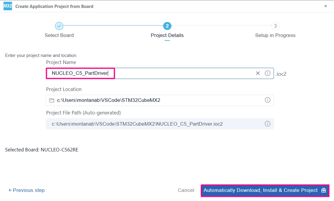

1. STM32CubeMX2 project creation and basic setup

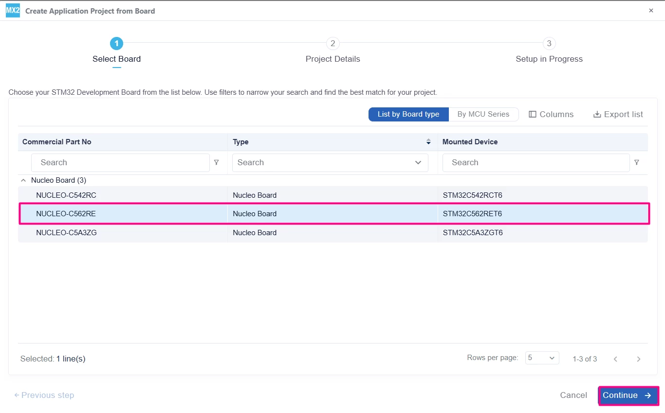

Follow these steps to create an application project for the NUCLEO-C562RE board. This exercise creates a simple blink LED application using the Part Drivers support.
1.1 Project creation

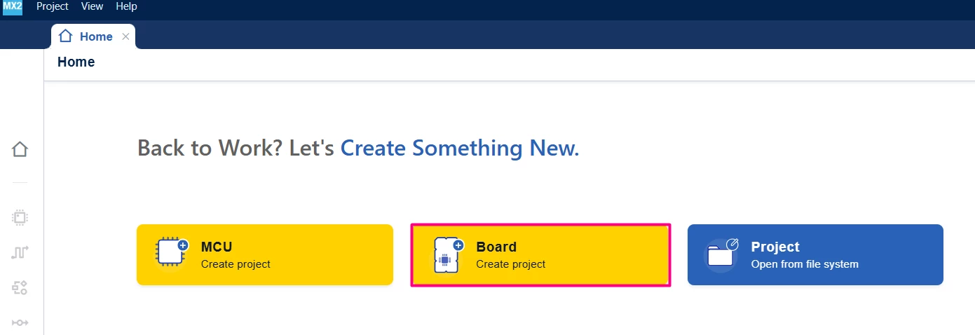

Open STM32CubeMX2. On the Home page, click the Board square to create a new project.
In the search field under MCU name, enter STM32C562RE and select the MCU. Click Continue.

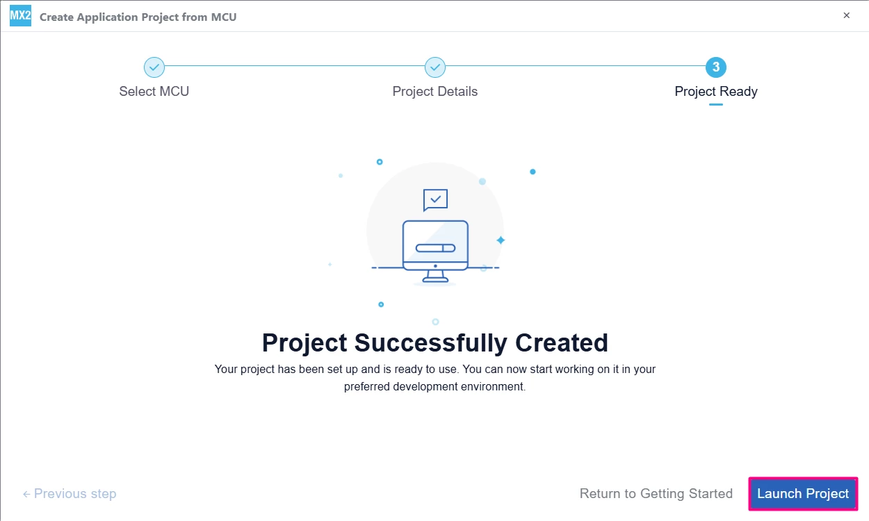

Enter the project name and location. Click [Automatically Download, Install & Create Project] to finish project creation.
Click [Launch Project] to start.

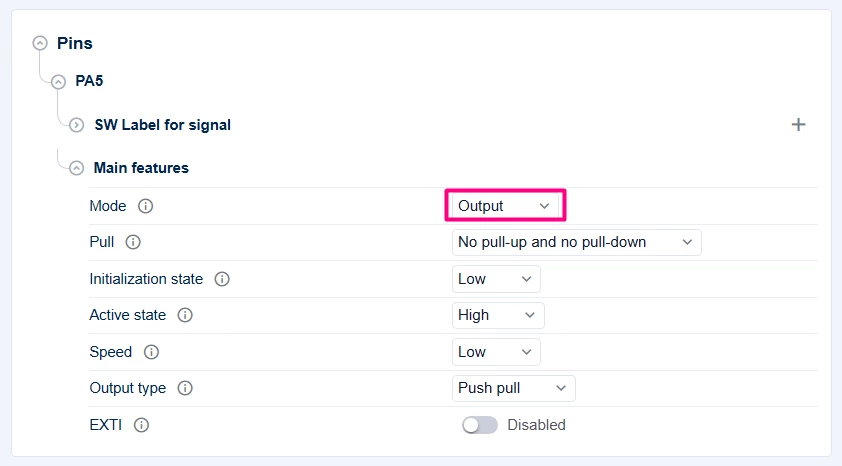

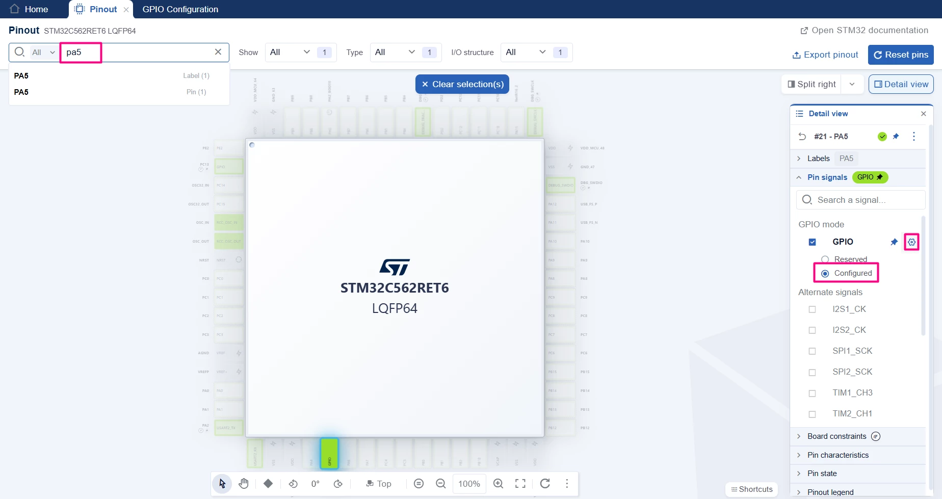

2.1 Configure User LED
Use PA5 as GPIO Output, change from "Reserved" to "Configured".
BMontanari_4-1771014647202.pngIn [Pins] >> [PA5] >> [Main features] change PA5 Mode to [Output].

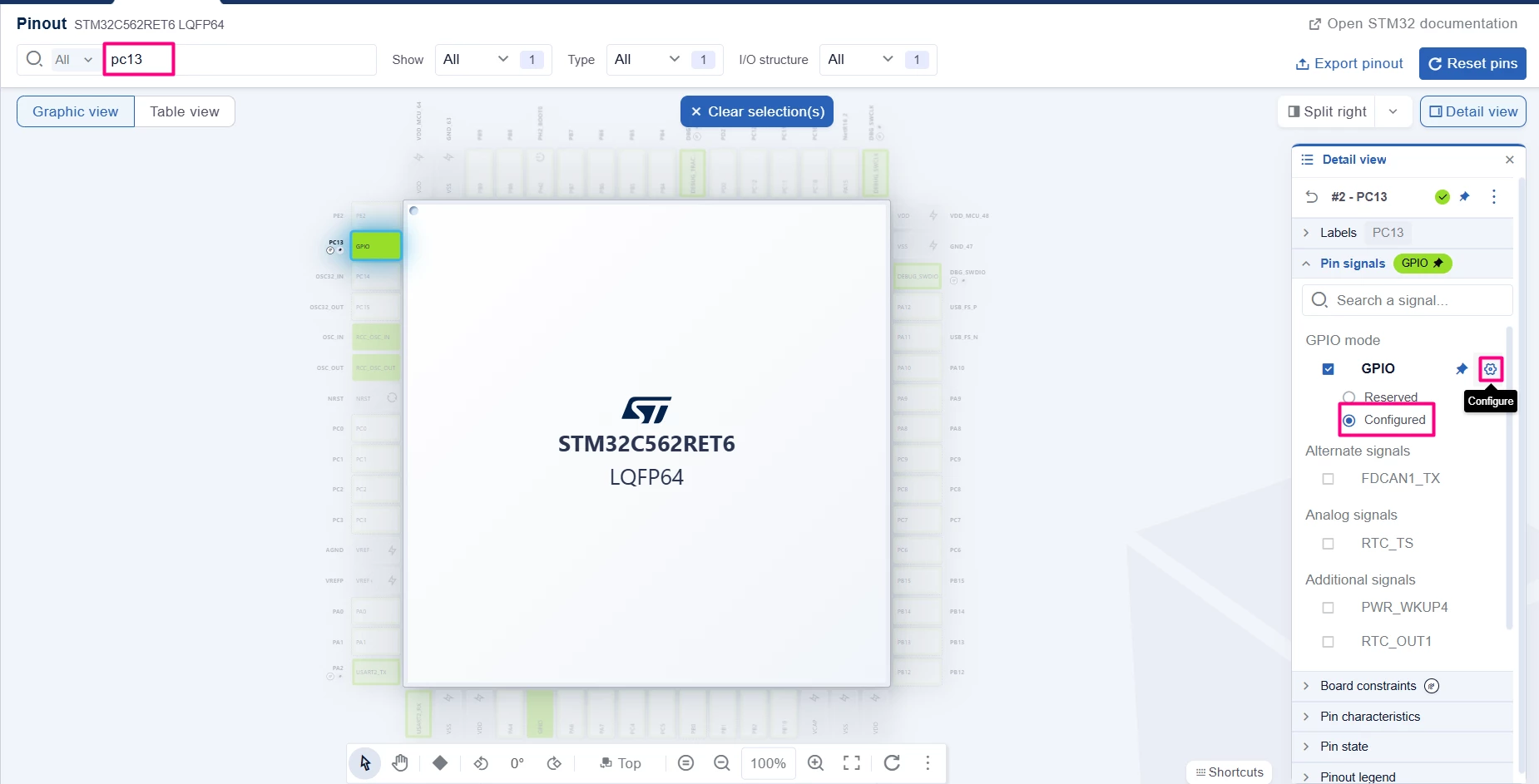

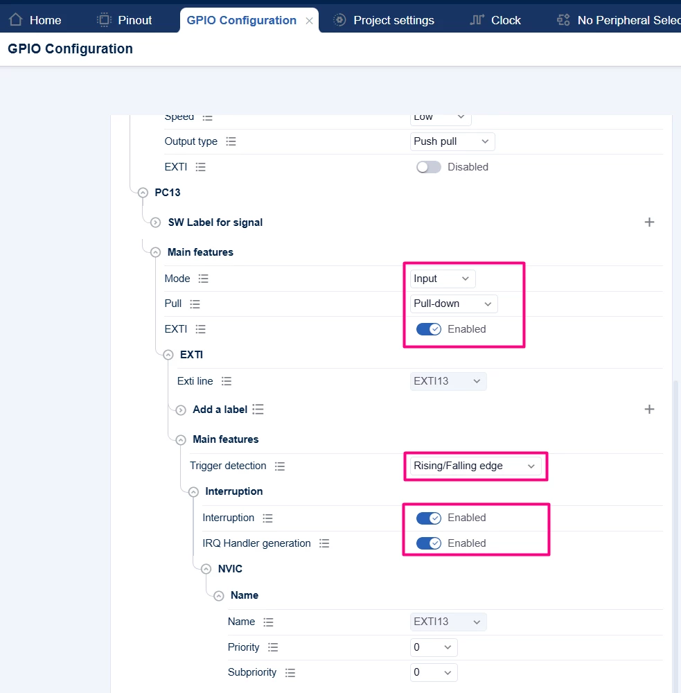

2.2 Configure the User button
Configure PC13 (User button) as EXTI Input. Locate PC13 in the Pinout tab.
BMontanari_6-1771014647231.pngIn [Pins] → [PC13] → [Main Features], change PC13 Mode to [input], and Pull to [Pull-down]. Enable the EXTI and change the trigger detection to [Falling edge]. Enable interruption and IRQ Handler generation.

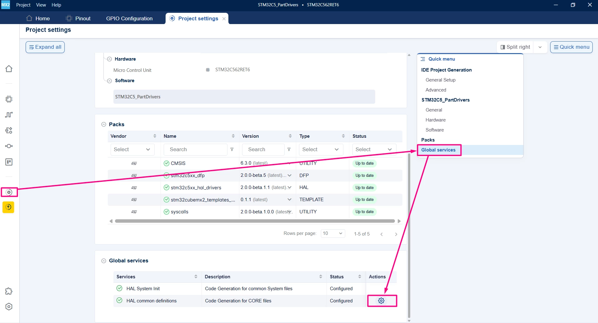

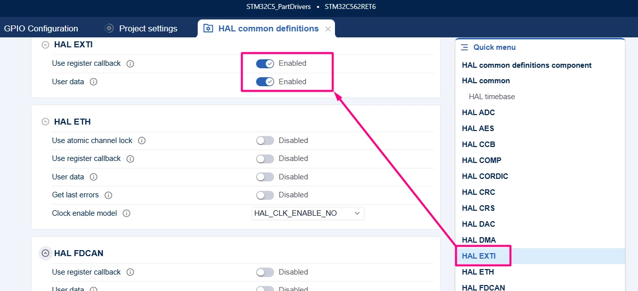

2.2.1 Configure HAL EXTI Settings
Navigate to the Project settings tab. In [Global services] locate [HAL common definitions] and configure.
BMontanari_8-1771014647249.pngIn the [HAL EXTI] section, enable [Use register callback] and [User data].
Enabling these options allows STM32CubeMX2 to generate the necessary EXTI driver files and support callback functions.

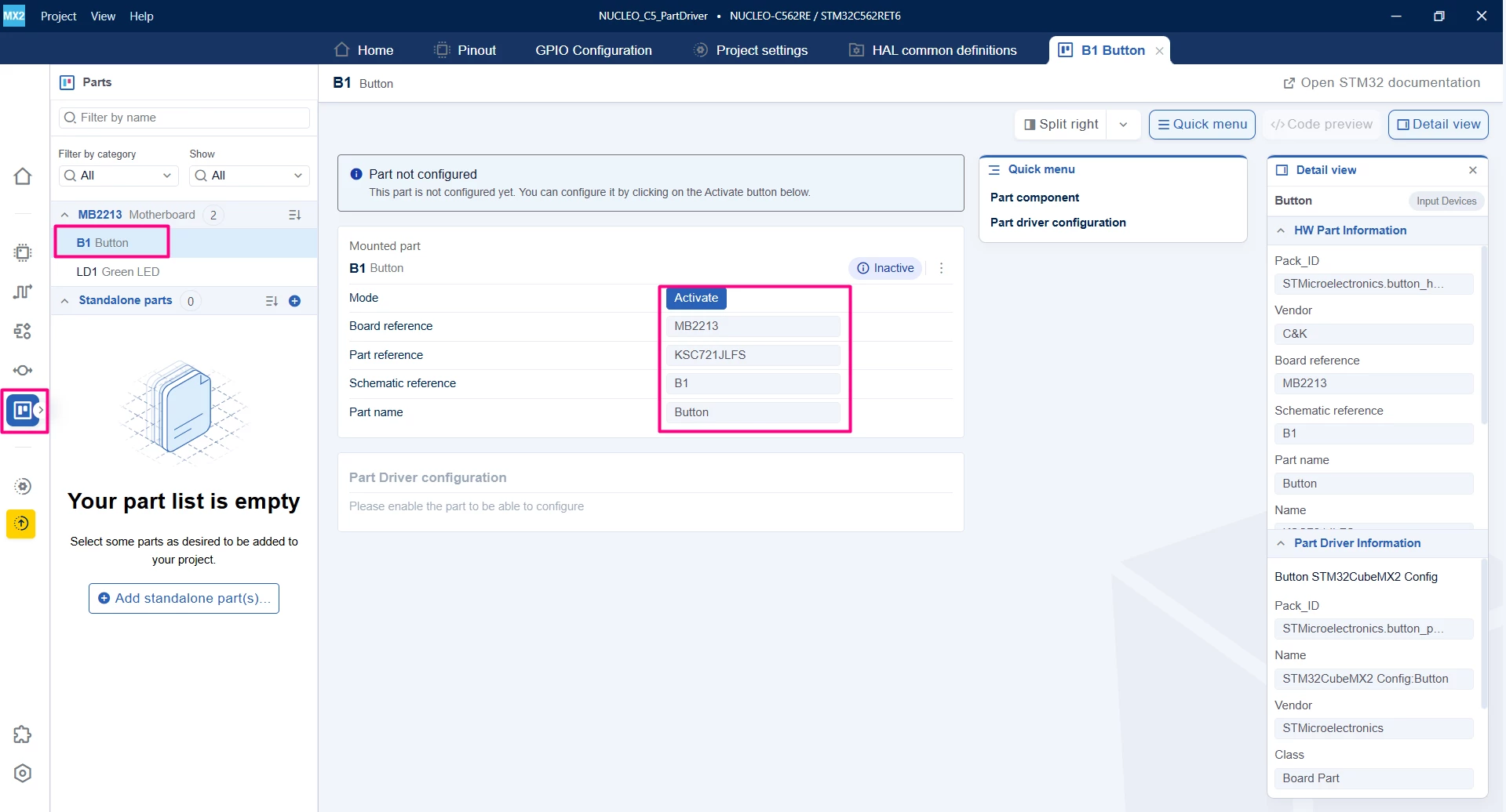

3. Enabling Part Drivers

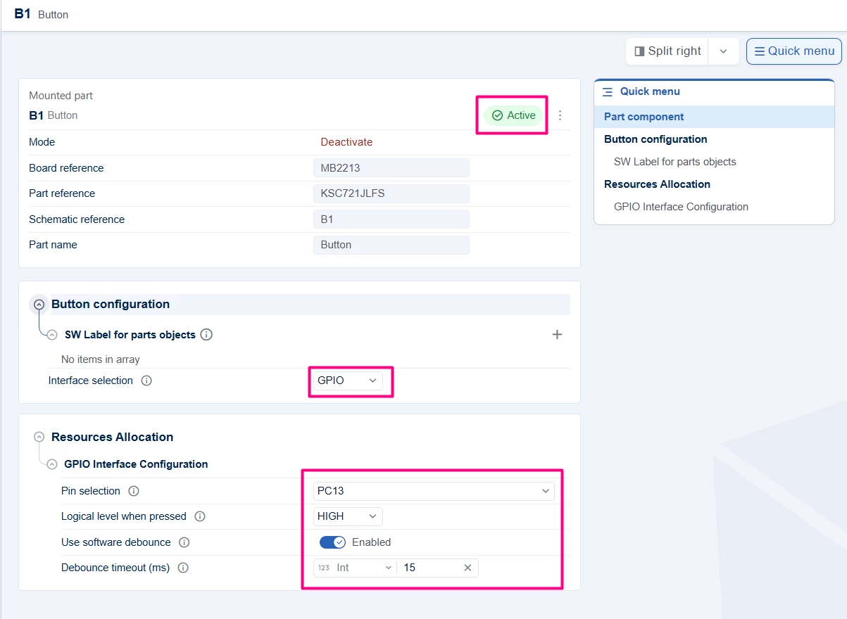

3.1 Add the [Button] Part Driver
BMontanari_10-1771014647266.pngActivate the B1 and assign it to PC13.
This setup ensures that the user button is correctly mapped (PC13) and debounced for reliable input detection.

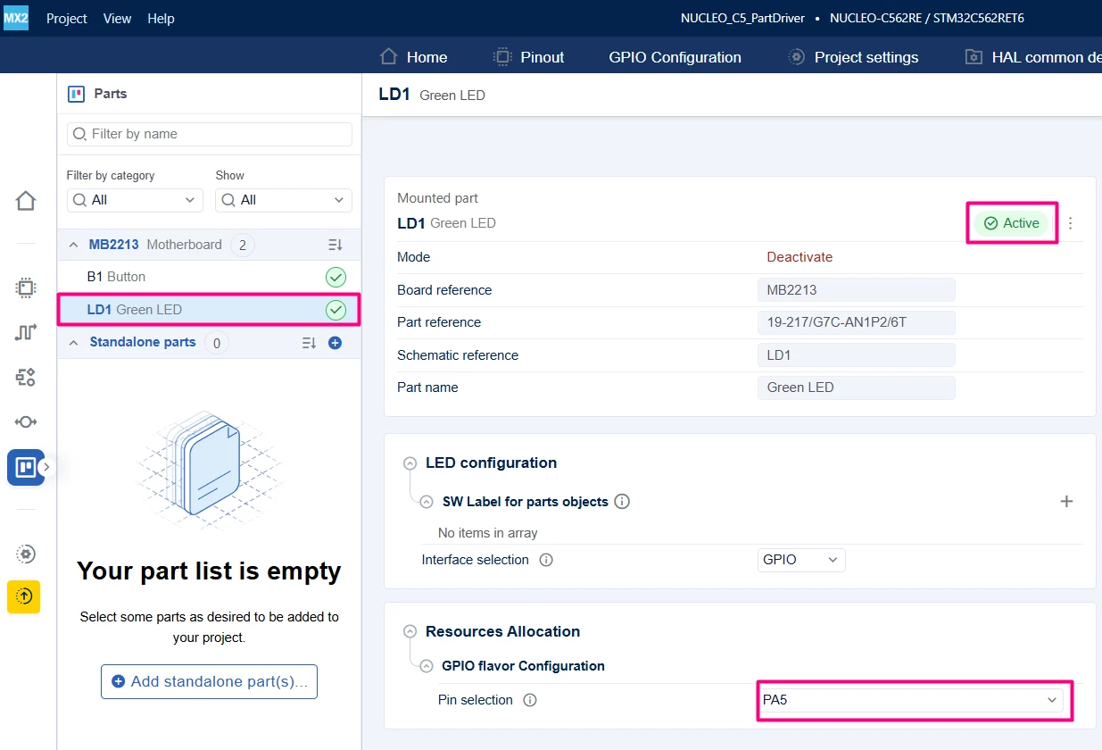

3.2 Add the [LED] Part Driver
This configuration maps the main user LED to pin PA5 for GPIO control.

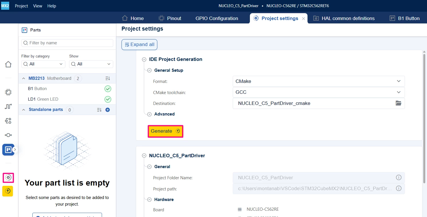

3.3 Code generation
To generate the code:
  1. Click on the Project settings icon and select the desired IDE.
  2. Click the [Generate] button.

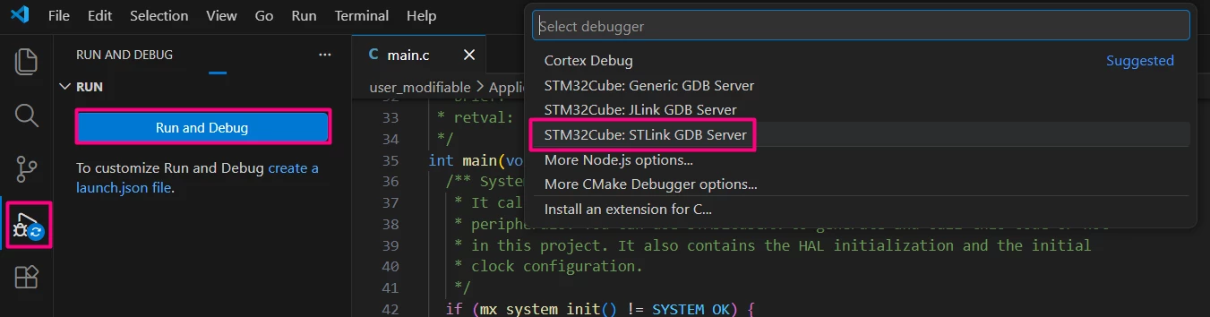

Debug the application:
  • Open the [Run and Debug] panel (Ctrl+Shift+D).
  • Create a new debug configuration by clicking create a launch.json file.
  • Select [STM32Cube: STLink GDB Server]
  • Start the debug session by pressing [F5] or clicking the green [Start Debugging] button.

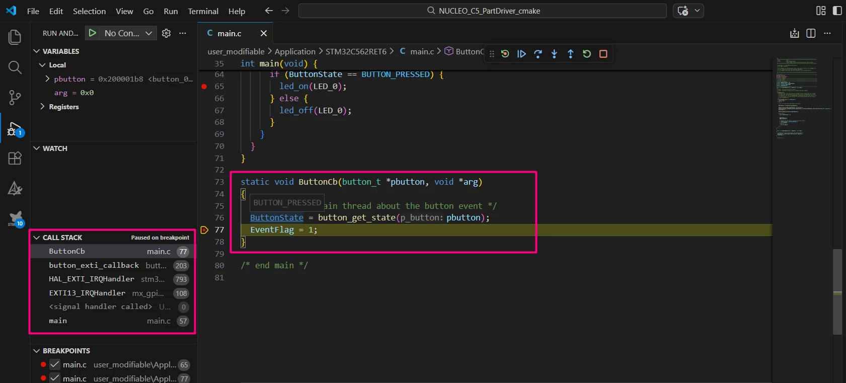

  • The debugger halts at the reset vector or the first breakpoint.

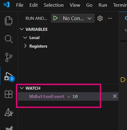

To observe button events, set a breakpoint inside the callback function ButtonCb. This allows you to see when the button event handler is triggered.
Add the variable NbButtonEvent to the Watch expressions in the debugger. This lets you monitor the number of button events detected in real time.
Use debugging features such as stepping through code, inspecting variables, and viewing call stacks to verify and troubleshoot your application.
