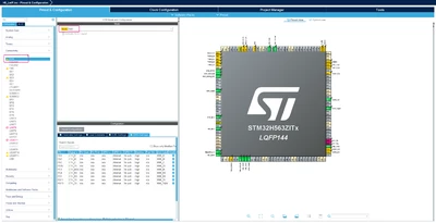

1.1. Project configuration

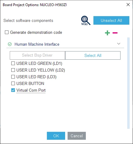

Start by creating a new project using the STM32CubeIDE by clicking [File->New->STM32 Project]. Use the [Board Selector] tab and select the [NUCLEO-H563ZI]. In the board project options that pop up, select only the [Virtual Com Port] and press [OK]. The LEDs are used, but the names given are changed to facilitate the color identification.
Figure 1 - Board Support ConfigurationFigure 1 - Board Support Configuration

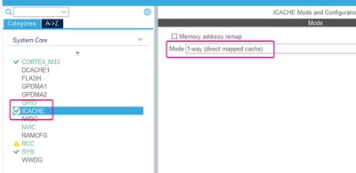

Next, configure the [ICACHE] in 1-way mode
Figure 3 - ICACHE settingsFigure 3 - ICACHE settings

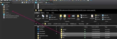

Start by downloading the stm32h5-classic-coremw package available on the GitHub link here, or at the beginning of the article. Make sure to perform a Git Clone, otherwise the required files are not downloaded.
Unzip the cloned file and move to the following folder ..\stm32h5-classic-coremw-apps\Middlewares\Third_Party\LwIP. [Ctrl + left click] to select both the “src” and “system” folders, then drag and drop it to your newly created project, as illustrated below:
Figure 6 - Add LwIP step 1Figure 6 - Add LwIP step 1

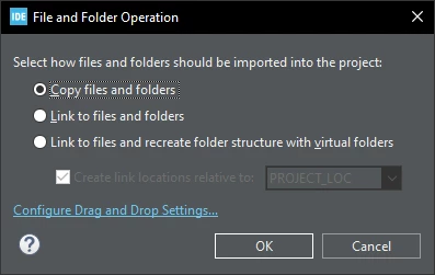

Select [Copy files and folders] in the pop-up tab and click [OK]
Figure 7 - Add LwIP step 2Figure 7 - Add LwIP step 2

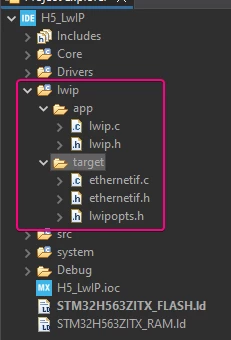

Create a new source folder called ‘lwip’, and inside it create normal folders named ‘app’ and ‘target’. These are going to be the user code folders for the middleware, maintaining a similar folder structure provided in our other series for the LwIP.
Figure 9 - Add LwIP step 4Figure 9 - Add LwIP step 4

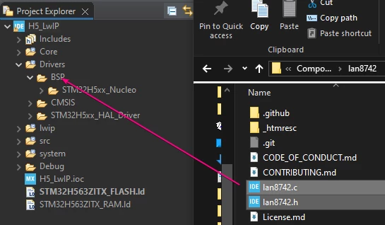

Finally, from ..\stm32h5-classic-coremw-apps-main\Drivers\BSP\Components\lan8742 path, import both lan8742.c and lan8742.h to the “BSP” folder.
Figure 11 - Add LwIP step 6Figure 11 - Add LwIP step 6

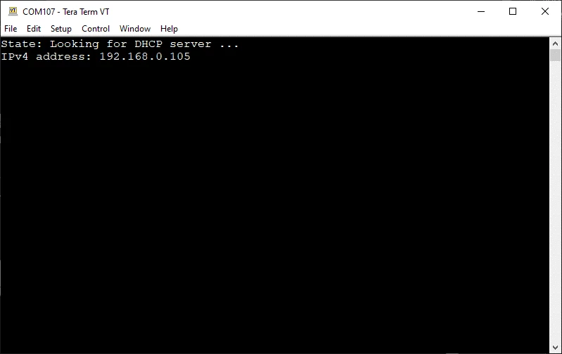

The next addition is the DHCP process. It checks DHCP state machine and handle the ip addressing, as well as print it out once it is acquired:
#if LWIP_DHCP
 * @brief DHCP_Process_Handle
 * None
 * @retval None
void DHCP_Process(struct netif *netif)
 ip_addr_t ipaddr;
 ip_addr_t netmask;
 ip_addr_t gw;
 struct dhcp *dhcp;
 switch (DHCP_state)
 case DHCP_START:

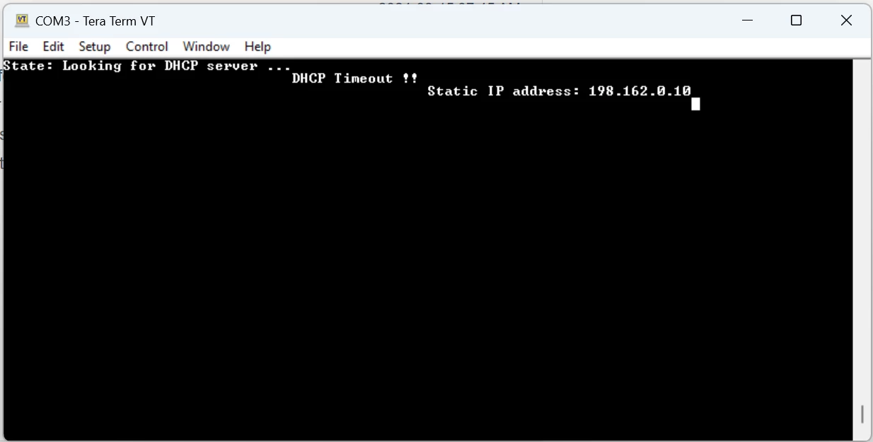

 printf("State: Looking for DHCP server ...\n");
 HAL_GPIO_WritePin(LED_GREEN_GPIO_Port, LED_GREEN_Pin, GPIO_PIN_RESET);
 HAL_GPIO_WritePin(LED_YELLOW_GPIO_Port, LED_YELLOW_Pin, GPIO_PIN_RESET);
 ip_addr_set_zero_ip4(&netif->ip_addr);
 ip_addr_set_zero_ip4(&netif->netmask);
 ip_addr_set_zero_ip4(&netif->gw);
 dhcp_start(netif);
 DHCP_state = DHCP_WAIT_ADDRESS;
 break;
 case DHCP_WAIT_ADDRESS:
 if (dhcp_supplied_address(netif))
 DHCP_state = DHCP_ADDRESS_ASSIGNED;
 HAL_GPIO_WritePin(LED_GREEN_GPIO_Port, LED_GREEN_Pin, GPIO_PIN_SET);
 char ip_str[16];
 ip4_addr_set_u32(&ipaddr, netif_ip4_addr(netif)->addr);
 ip4addr_ntoa_r(&ipaddr, ip_str, sizeof(ip_str));
 printf("IPv4 address: %s\n", ip_str);

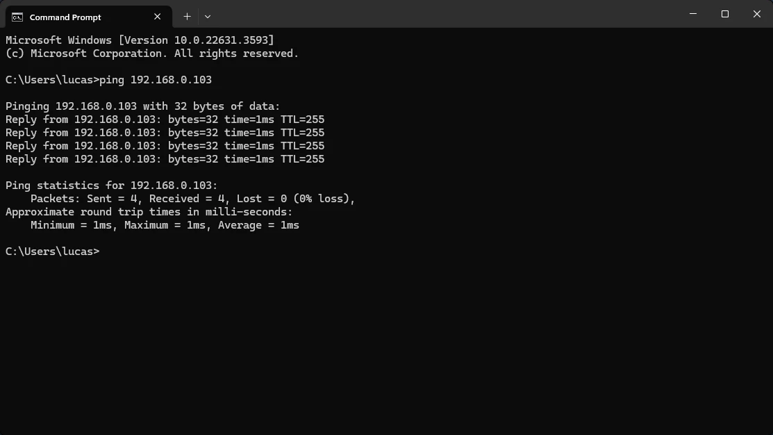

2. Results
Press [Ctrl + B] or the hammer icon to build the project, which should yield zero errors. It is important to note that if you use the code generation tool again, an error may occur where the stm32h5xx_hal_eth.c file is imported incorrectly and the HAL_ETH_Init() function is miss generated. In case this happens, simply copy the following line into line 308 of the mentioned file.
HAL_StatusTypeDef HAL_ETH_Init(ETH_HandleTypeDef *heth)
Now that the application is built, connect the NUCLEO-H563ZI board to the computer using the embedded STLINK’s USB and to a router/switch using the RJ45 connector. Open a virtual com port terminal and connect to the board’s com port. The Tera Term was used in this case with the settings [115200, 8bit, No Parity, 1 Stop Bit, No Hw Flow Control].
Press the [run] or [debug] button to get the application started. The green LED turns on and the following message is displayed:
Figure 13 - Demo ResultFigure 13 - Demo Result
To make sure the board is connected and working, you can open the cmd.exe or similar and issue a ping command, as illustrated below:
Figure 14 - Optional CommandFigure 14 - Optional Command

October 8, 2024
Hi
I get static IP : from print : Static IP address: 198.162.0.1
What I miss?

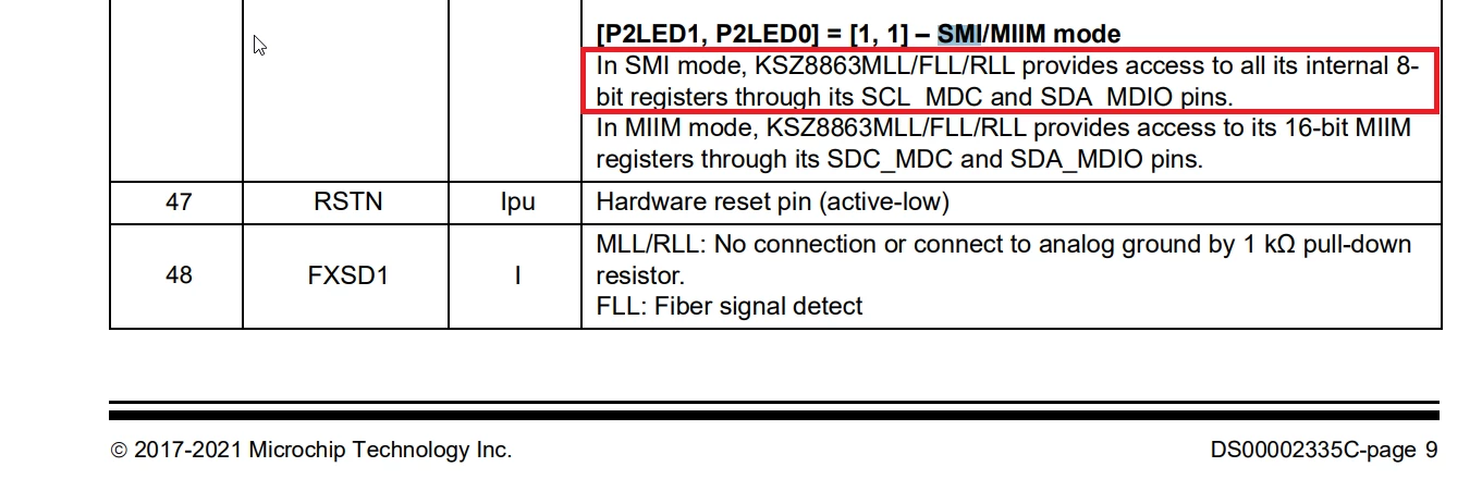

Do you know how to connect a Ethernet Switch chip (MAC) ? that means there is no PHY device. There is only RMII interface between STM32 and switch chip, without MDIO/MDC.
Any advice is highly appreciated
Peter
December 2, 2024
I would also be interested in something similar as @Peter3718, i'm trying to interface with the KSZ8863 PHY. CubeMX generates the MDC and MDIO pins no option to disable them. Any suggestions how to implement the settings of the phy by I2C trough the H5?
Thank you in advance.
December 4, 2024
thanks for the Help. It took me a while to also enable IPv6, but it works now.
@Peter3718
If a switch does not have a PHY, then it does not have a PHY and you can not receive or send anything.
@flightorlop
The KSZ8863 has an SMI interface, see here:
I am using a single pair Ethernet switch with an integrated virtual PHY from microchip and it works great together with the STM32 MAC.
Regards,
Roman
December 5, 2024
Thank you @RomThi for your response.
I'm having access to all the registers trough I2C, I need to configure register 198[3] to set the correct clock mode [5] of the KSZ8863. Switch functionality works. But now I'm facing the challenge on how to change the STM32 LAN8742 driver to use I2C to setup the KSZ8863? Which is normally done automatically by Cube by generating the MDIO and MDC pins in combination with the LAN8742 driver?. Or am I missing something?
Any advice would be super helpful.
